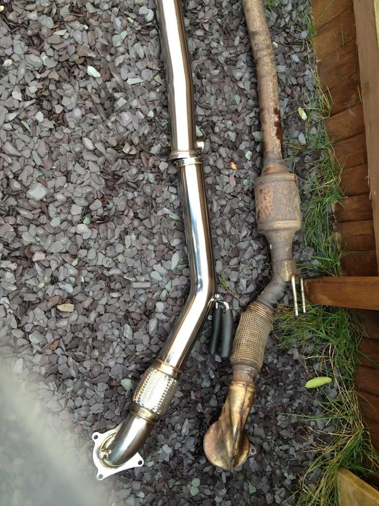

Offline ashw831
  • Posts: 133
Re: Decat fitted.
« Reply #14 on: November 08, 2012, 04:18:14 pm »
did everthing come with it to attach to exhaust
Yes they sent me everything, new turbo gasket, and a big clamp as it is split in 2 pieces. The  it just slots in to the slieve for the standard system. Welds look good too, really pleased with it tbh, considering I paid £92 for it including next day special delivery.
Comparison pic for you:
