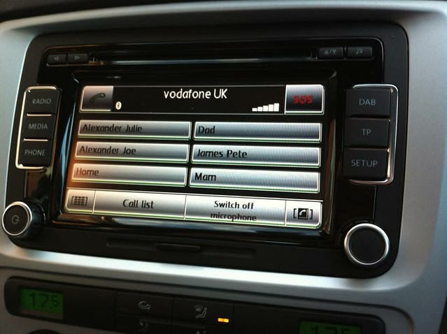

First proper mod and must have was an RCD510DAB and an aerial. I've looked into having the SMDs replaced with green to match the rest of the dash, but it's not that much of a pain really. The biggest PITA of a job was to replace the CAN gateway I sourced from Eddie NL, but necessary to prevent battery drain I guess.
IMG_0701 by jonnyguitar, on Flickr
New fascia panel source and Bob's your uncle.

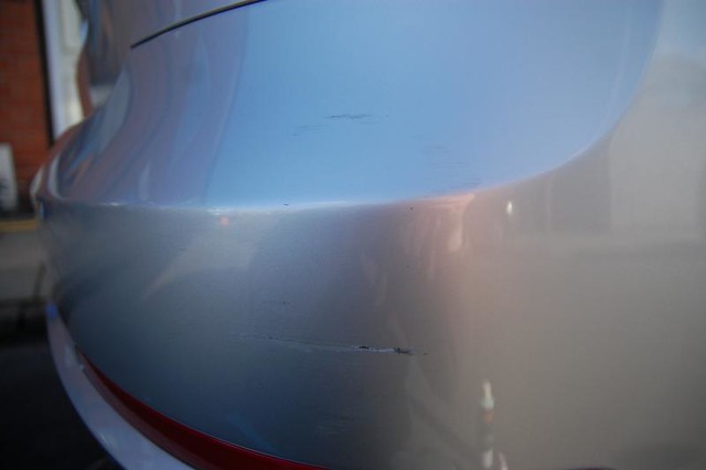

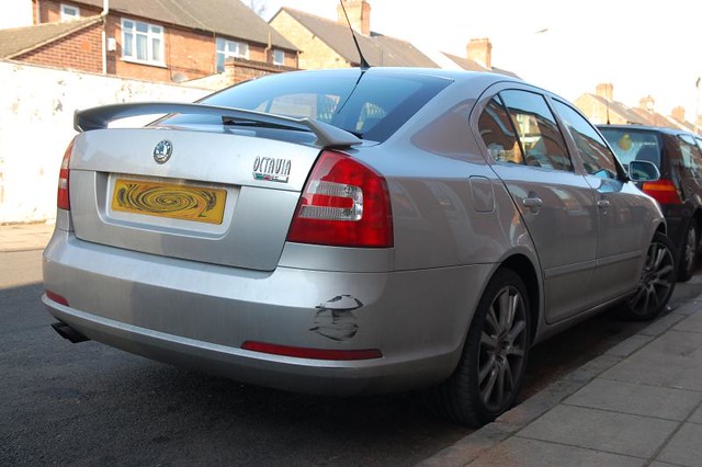

I got whacked by an ambulance on a call, who subsequently denied any contact.
DSC_5812 by jonnyguitar, on Flickr
This the best I could do with the paint cleaner, but the damage was through the paint.
DSC_5871 by jonnyguitar, on Flickr
Only one thing for it, time for the parking sensors.

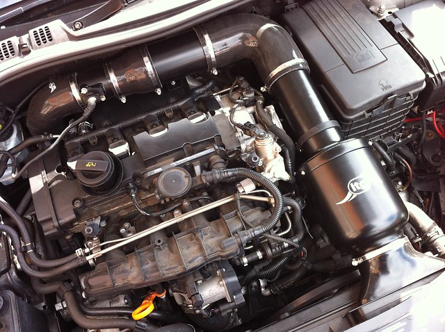

I then went for an induction kit to replace the cracked and battered engine cover/airbox and came up with this
IMG_0890 by jonnyguitar, on Flickr

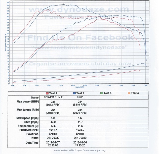

Followed by a remap courtesy of Motech in Northampton. I went to Motech based on a recommendation I read on this site, however after rewriting the map a second time it wasn't what I had hoped it would be, didn't think it was especially good and decided to have it overwritten (more to follow). Turns out I was not the only one not especially happy as the first poster has also been elsewhere I believe. Following the first map:
KU07 RR by jonnyguitar, on Flickr

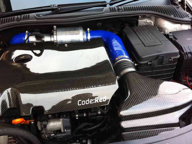

The Code:Red stuff wasn't really doing it for me, didn't really want an open induction kit so got in touch with ITG back in May last year and asked if there was a possibility they would be developing a kit for the 2.0 FSiT. Great news was they were.
photo(1) by jonnyguitar, on Flickr
photo(2) by jonnyguitar, on Flickr

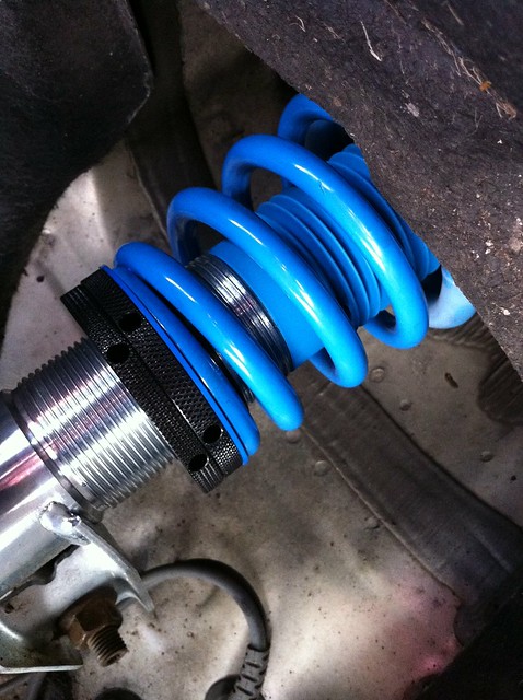

It was also time for lows. I spent a long time deliberating over whether to go for springs and shocks or coilovers. I can't get Sportline springs for the Octavia, which was annoying as the Pro Kit didn't go low enough for me. I also considered an H&R Cup kit (-50mm, to give a drop of -35mm or so) or Weitec GTs. In the end I settled on Bilstein B14s and had these fitted.
photo(4) by jonnyguitar, on Flickr
Settled down a bit with a couple of threads left to use
DSC_5999 by jonnyguitar, on Flickr
I found these incredibly hard to begin with and thought I had done the wrong thing. These have since bedded in quite nicely although it would be nice if the car looked a little lower, but I think I am just outside the optimal operating height of the B14s anyway.

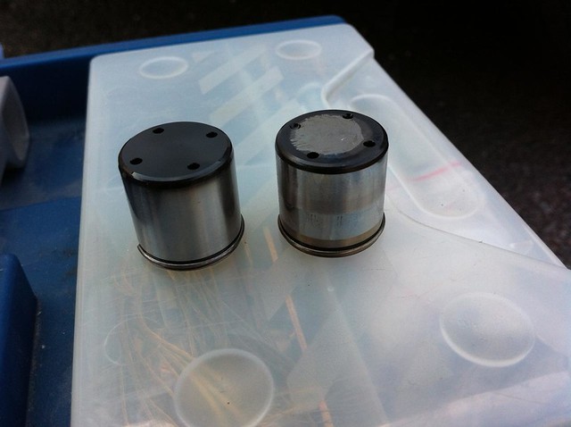

And a new cam follower fitted in July, along with a later revision PCV to try and cure the low fuel pressure issue (hasn't done so yet)
IMG_1325 by jonnyguitar, on Flickr

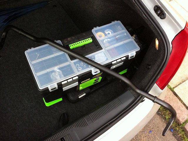

I also managed to get an Autotech rear ARB from Rob at W8. I sent the car for its free service and got it back with a shopping list instead, including perished ARB bushes. I decided I was going to replace the whole bar rather if it was coming off. With new drop links, the result is fantastic making the car ride better over a broken surface and really tightening things up in fast corners.
IMG_1322 by jonnyguitar, on Flickr

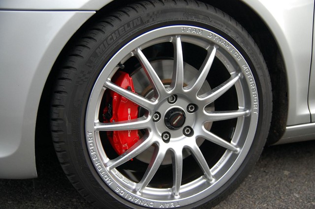

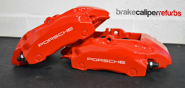

Most recently, I had started to really cook the brakes and thought I ought to do something about it. I guess I could've gone for better fluid and uprated pads and discs, but I wanted to increase brake performance as well in the event that I took the car on track. Besides, I'd already bought a set of wheels that could fit over a BBK, so why wouldn't I upgrade?! :lol:
I looked at the S3/R32 upgrade but confess to having been put off by the increased weight. I read a Dave B post on this forum to the effect that due to the people who had started making copies of his mounting brackets for the NQSBBK, he wasn't going to make any more and had X amount of sets left. I accidentally sent Dave an email and ended up with these:
Untitled by jonnyguitar, on Flickr
By the time they turned up, I'd stopped having the "What I have I done?" thoughts and decided I was going to have to get myself a set of calipers, picking up a pair that were as scabby as this:

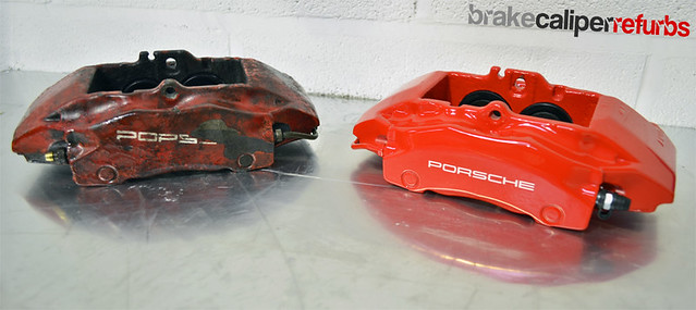

I knew I wasn't going to attempt to repaint them myself as a) I wanted a proper job doing and b) didn't have the skills or tools to take a set of these apart. The scabby ones were duly despatch to Jonny at Brake Caliper Refurbs who worked his magic.
john's-porsche-calipers by jonnyguitar, on Flickr
john-calipers by jonnyguitar, on Flickr

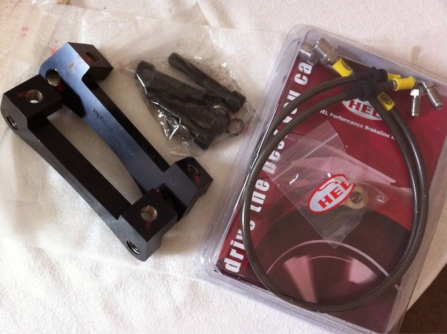

I know I should pay more attention but what you get back is a set of calipers that have been stripped, blasted and powdercoated, a logo lacquered in followed by a ceramic coating to protect against the elements and brake fluid spills (it does btw). New bleed nipples are fitted and I'm pretty sure these had new dust seals as well.
These were a breeze to fit with the only bit of hard working being to grind the casting moulds off the hubs so the brackets mated properly.

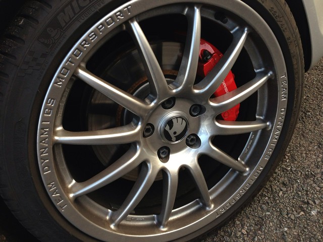

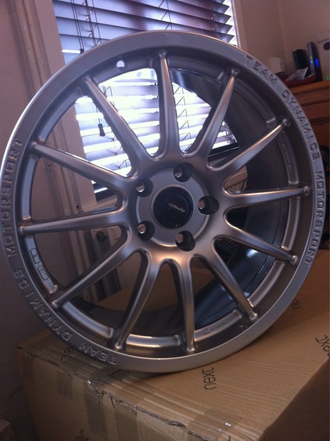

I'm not keen on the Team Dynamics wheel centres and have been looking for a solution. I'm not sure Skoda centres will be a direct fit so bought some cheap universal caps off ebay and fitted some badges I had made up ages ago. They are not perfect by any means but they're not too bad.
Which brings us up to date with today's job of fitting them to the car:

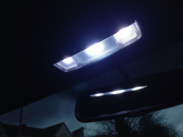

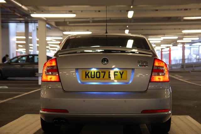

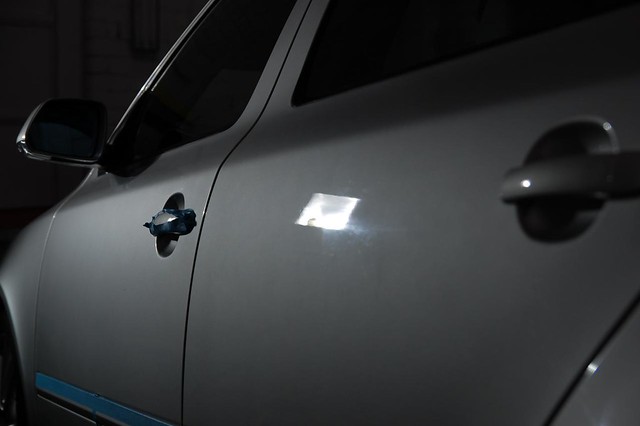

Most recently, replaced interior lights with LEDS

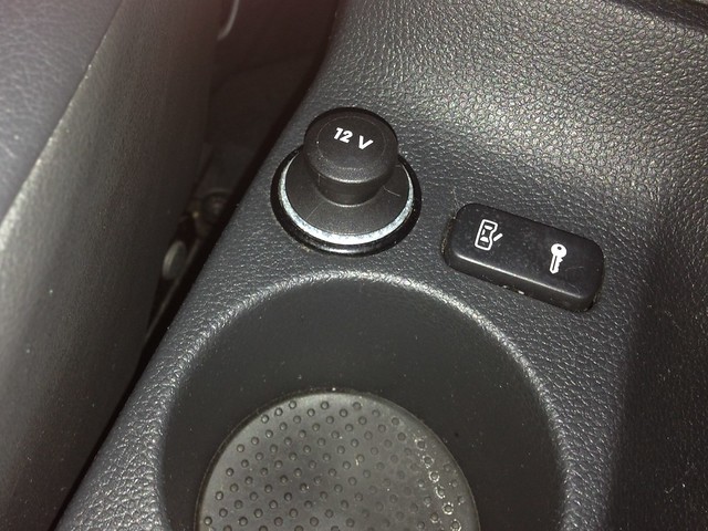

Got a proper VAG 12v blanking cap (I am very excited about this) to replace the crap one from another unidentifiable car
photo by jonnyguitar, on Flickr

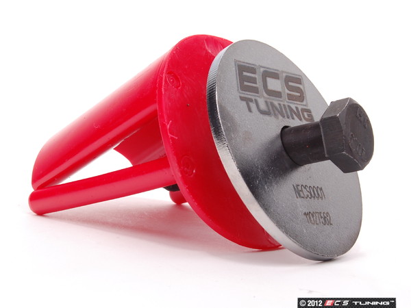

These dogbone mount inserts make a lot of difference and power seems more immediately useable and there is definitely less wheel hop. I reckon this in combination with an anti-lift kit would make a significant difference.

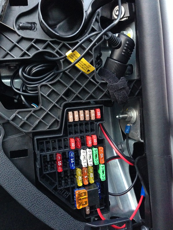

And then a Blackvue drive recorder
Wired up like so with an add-a-fuse thingy

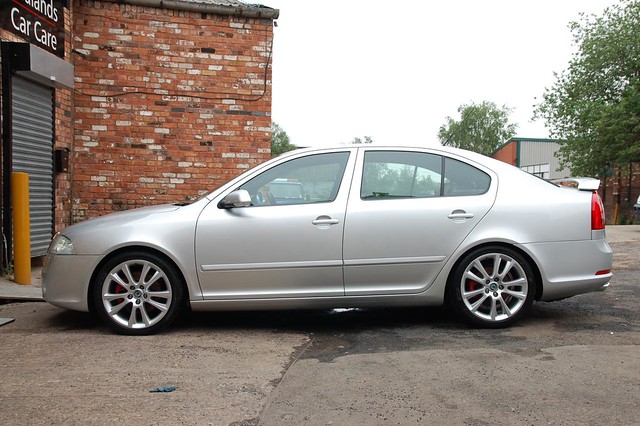

I also wanted the car a touch lower and a little more comfortable as I think I was operating the Bilsteins on the limit of what was acceptable for a compromise of height and comfort. Another conversation with AKS and a set of H&R Monotubes were ready to go on.
With these on, it's a little lower than it was before
