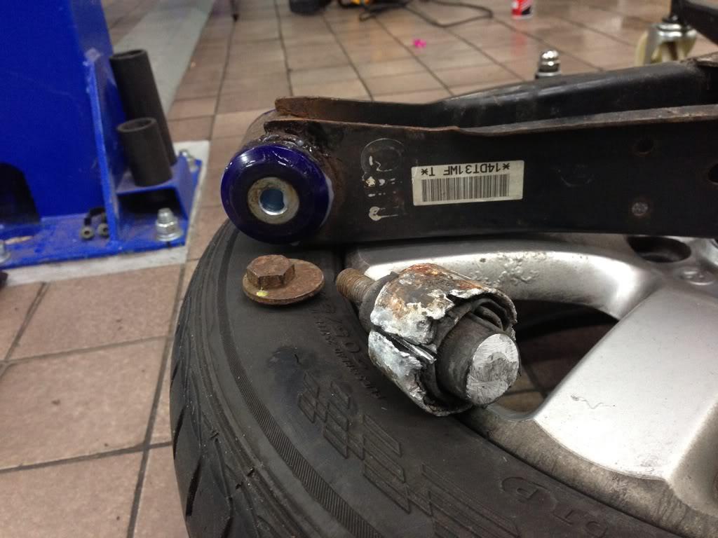

Feeling a sticking sensation in my clutch, and reading up on the problems that a few people have encountered with the MKV sticky clutch pedal, i felt it was best to get my Clutch Master Cylinder replaced. Theres nothing more annoying than trying to get your bite point and realising the pedal hasnt released back up yet...! In any case, i thought id get my alignment sorted aswell what with lowering the car even further, i never had my wheels realigned.
Turns out someone on Edition38 recommended me to go to AKS Tuning and get Alex to give it a once over. A very pleasent experience indeed! Being the first garage to go to for any work to be carried out other than my Local VW Dealer, i felt less uneasy as i learned that he takes pride in his work! So he gave it a once over and informed me of the following:-
-Rear toe bushes seized
-one CV boot perished
-one CV boot clip missing
-Engine mount bushing perishing
So i decided to get the above replaced bar the engine mount bushings (ill get that done later) which didnt end up being as easy as we'd have hoped...

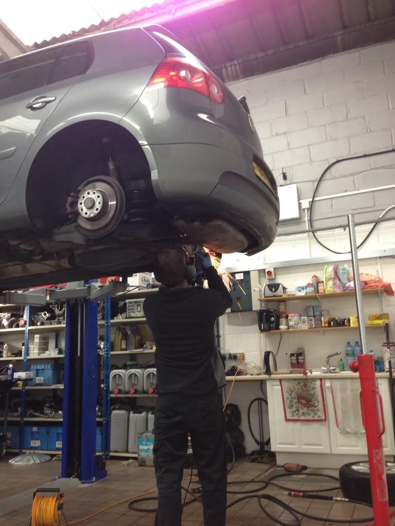

and with abit of knocking, smashing and dropping various parts it started taking shape:-

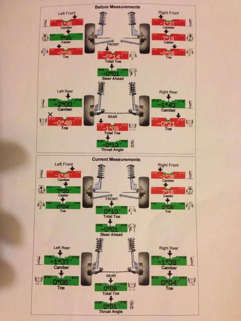

i decided to give up on taking pictures at that point so me and my friend decided to get a bite to eat at a local in rural Bedfordshire. After the CV and clips were replaced, rear arms back in with replaced toe bushes, and a clutch master cylinder in it was time to get the old bird aligned. Ill let the report do the talking, after having a look at the reds i could see why my steering was pulling to one side...!
Was overjoyed to see the reds were eliminated and knew that the last thing left for that perfect alignments are the adjustable top mounts. Saving my pennies, hopefully ill have this by Christmas. Would like to give a HUGE thank you to Alex at AKS Tuning for all of his help, patience and advice yesterday- i will DEFINITLEY return for more work in the near future!!

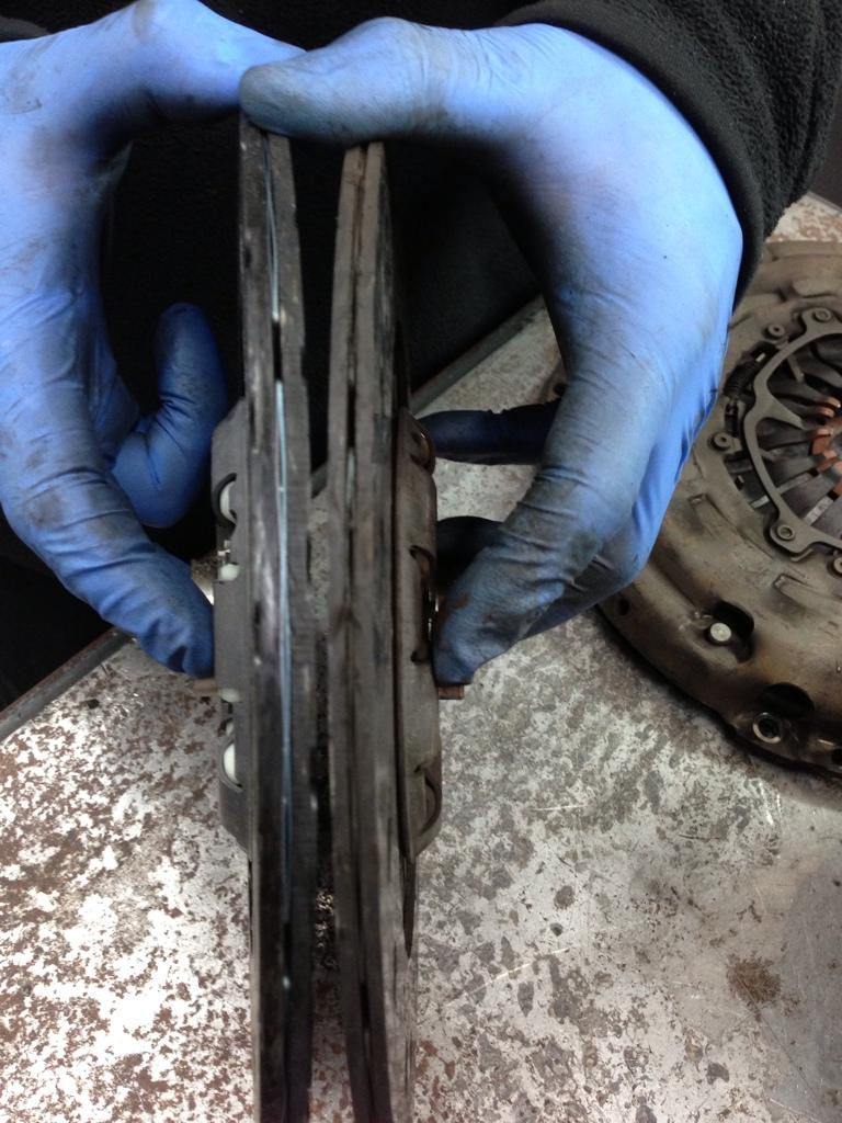

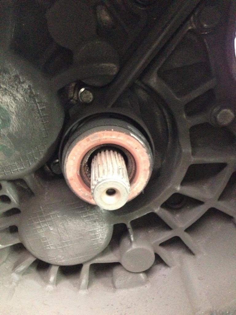

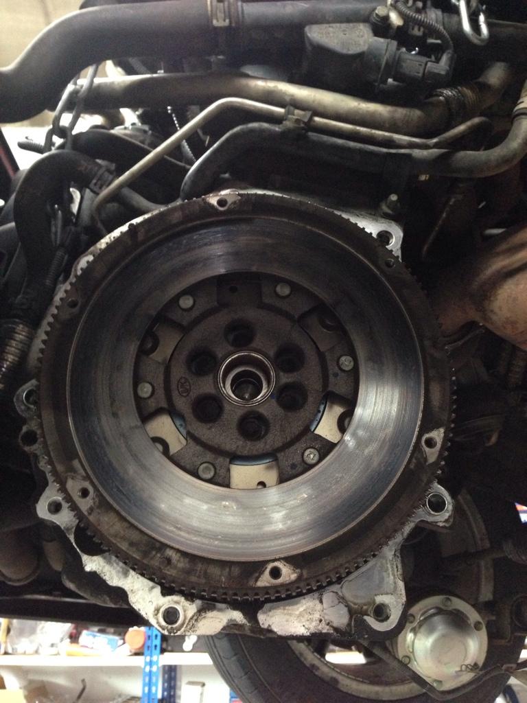

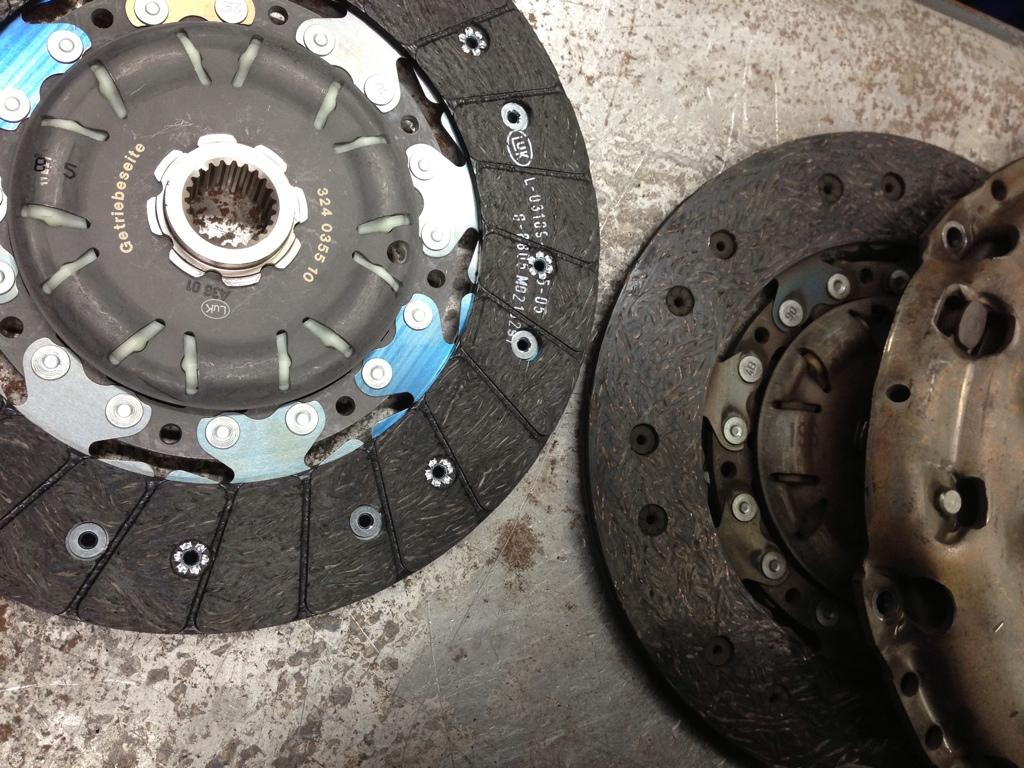

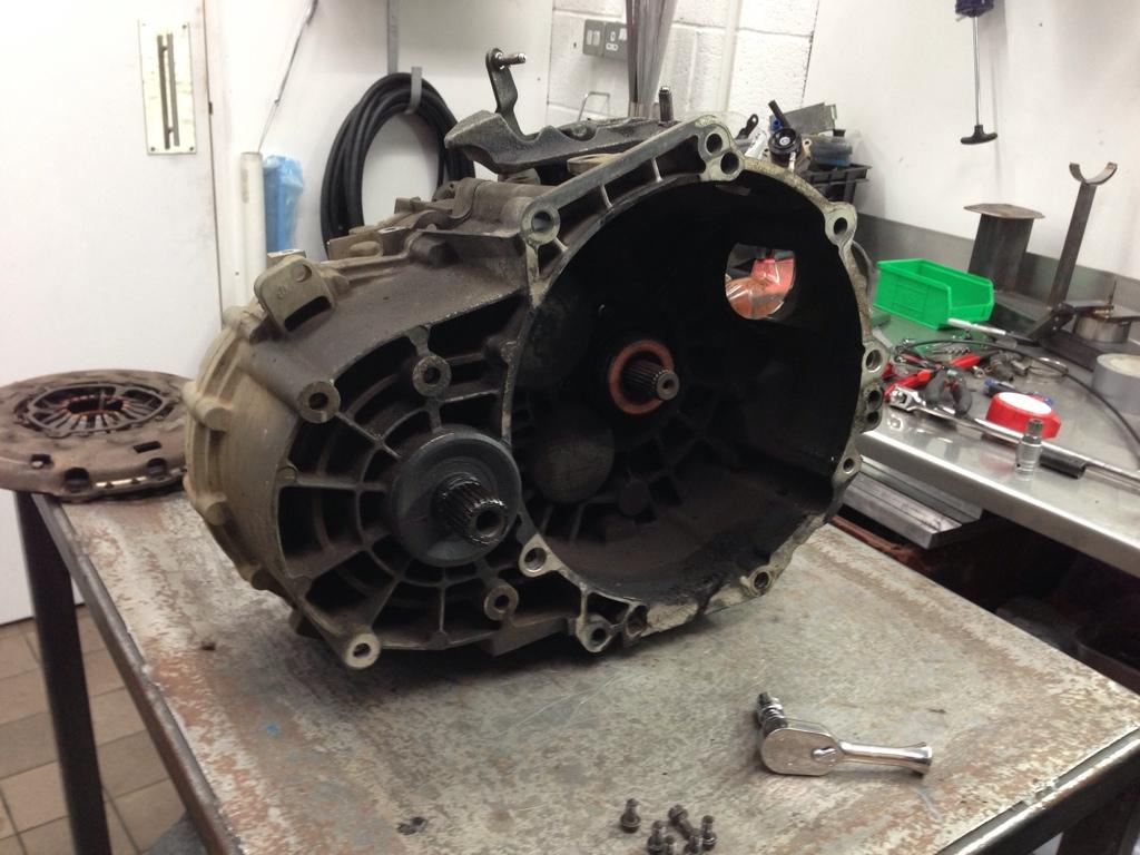

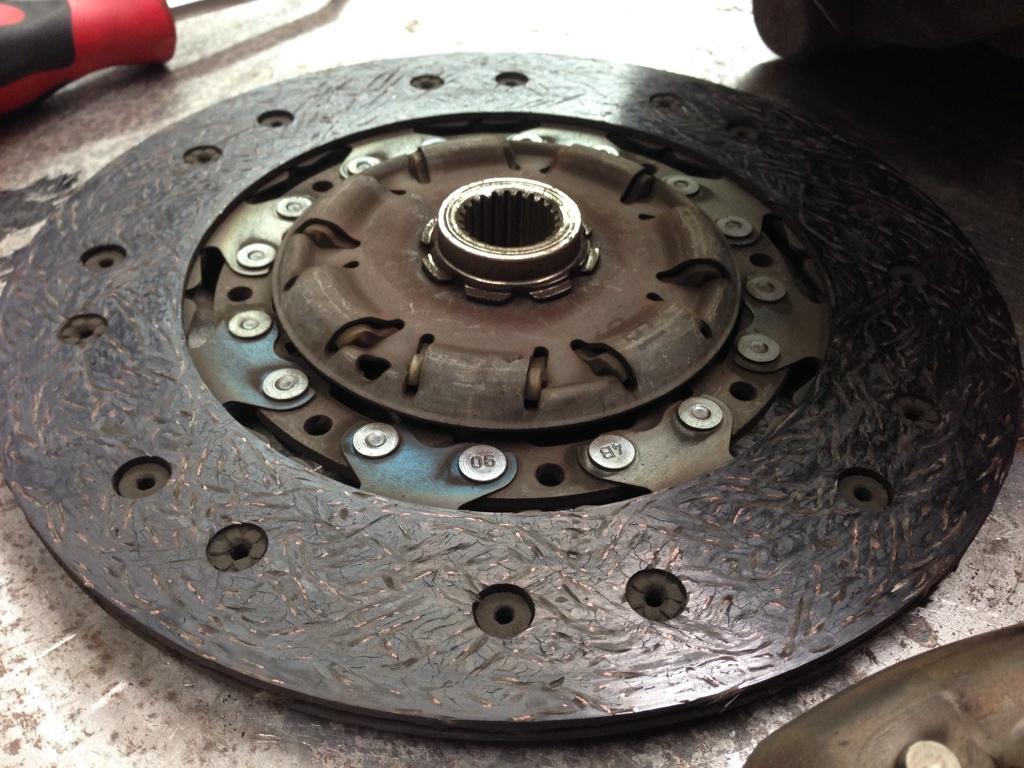

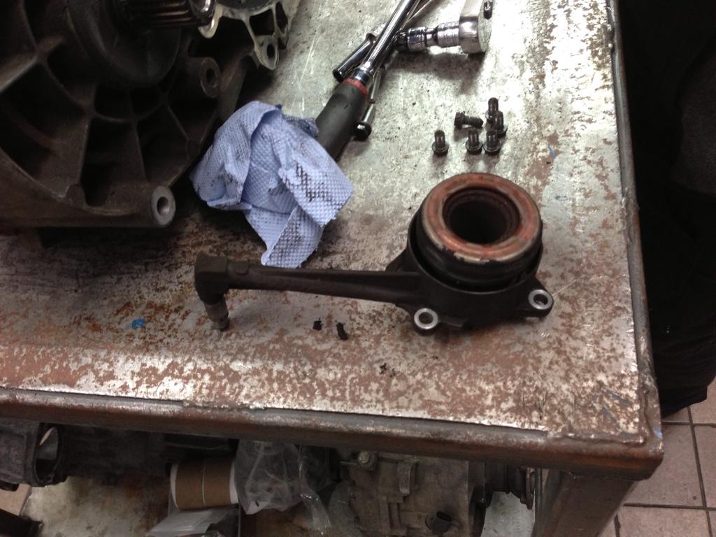

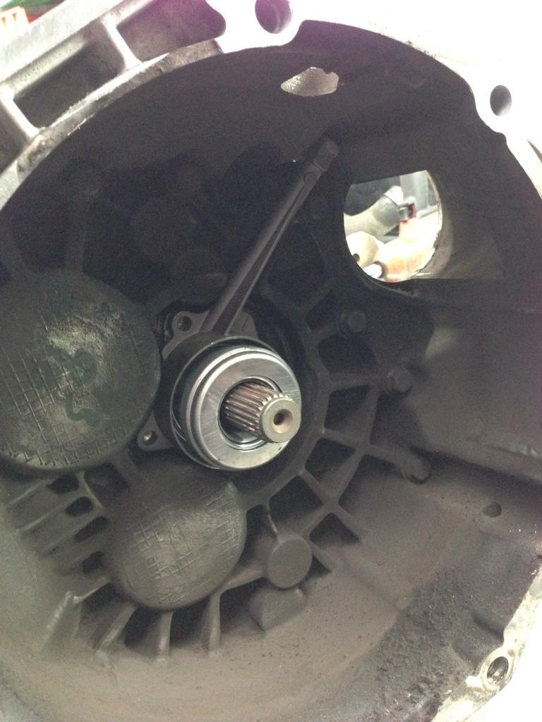

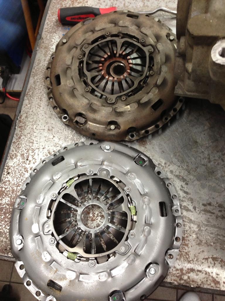

After a few months of enduring the unbearableness of my clutch failing to return after pushing it down, and sticking between gear changes i decided to have it investigated. Upon researching (again) into further problems with the pre-facelift 140 BKD's i found alot of people talking about the clutch/DMF issues they have come across. I decided to bite the bullet, knowing it would cost a fair bit of cash and have this looked at. Chances are it was the slave cylinder that had gone as the Master had just recently been replaced and ruled it out. Sitting at the unit and watching this experienced bloke fondle my car to pieces i learnt a little bit about how my car is put together and how the clutch, gearbox and parts of the drivetrain work. this is what we found :-
First up, a gearbox. a little dirty, but a gearbox none the less.
a slightly tired looking slave cylinder.
a pretty worn clutch plate. Considering the car is on 161K and i have absolutley no receipts/evidence to show that the clutch has been replaced in the lifetime of the car, im guessing its done quite well with no slipping.
a DMF! My service schedule appears to contradict what i had been told by Wayside Towcester (the dealer at which this car had been serviced prior to my ownership) who say the DMF was replaced at 95K in 2010 under a safety recall whereby VW Customer Services advise me it had been replaced at 30K in 2006 under a safety recall...
Looking at the gearbox, some slight play was detected. I was pretty alarmed at this, but the mechanic told me that it was expected of a car that had done that much mileage, and was not uncommon as such. I guess these things arent completly indestructable huh... but looking at the gearbox, that wasnt the only thing that had play...
Im no technical expert, but looking at the slave, clutch plates and DMF decided to get them all replaced. So a quick phone call and mug of tea later...
Old and new...
again old and new...
new on the left, old on the right...
my new slave...
and whilst he had taken apart most of my engine, i thought id get the Engine Coolant Temperature Sensor replaced aswell. That would be sure to get rid of the god damn emissions light (why the hell the emissions light man?!) once and for all!

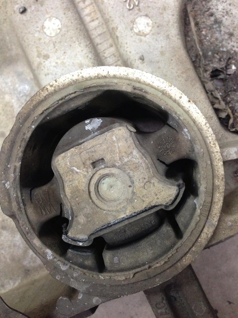

before putting the subframe back in he advised me to get my engine mount replaced next time i come in as it looked a little something like this...
and whilst he was putting it back together again i thought id ask him carry out the subframe bolt mod just in case.
So in summary, just over £800 got me a new DMF, clutch, slave cylinder, ECT sensor, subframe bolts, fresh gearbox oil all fitted and with VAT. Yes its a large expense, but heck ive done it now so may aswell run the car down to the ground like i originally planned. As a direct result of this, my car feels brand new. Not only that, the engine shudder i got on idle has now completley disappeared!! who wouldve thought it would be the DMF? theres me thinking it was an injector/glowplug problem!!
