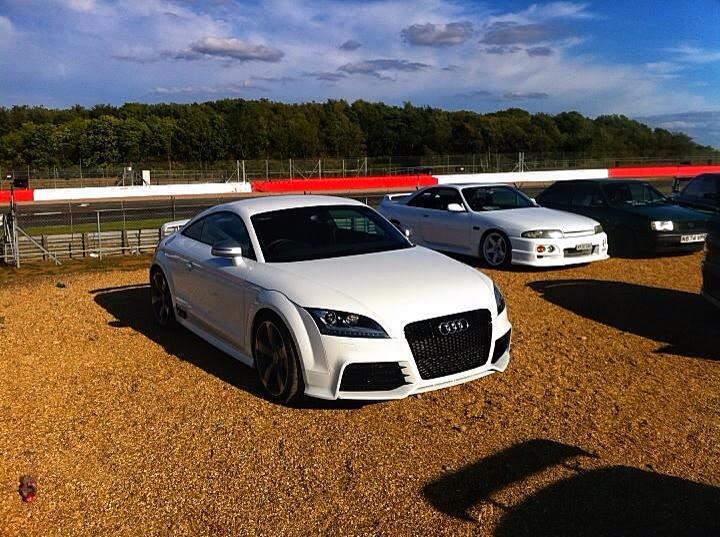

I then picked up this beauty, Ibis white, delivery miles, so happy! Dream come true.
First thing I did was to remove the license plate off the front. Looks much better!

« Reply #1 on: November 12, 2012, 11:41:10 pm »
Very nice car, all i can see from them is potential! Wouldnt have had the spoiler but thats just me! Very jelous, looking forward to more!
Nice simple plate mod, hope no 5 0 spot you  :scared:

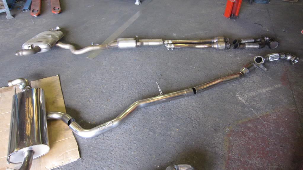

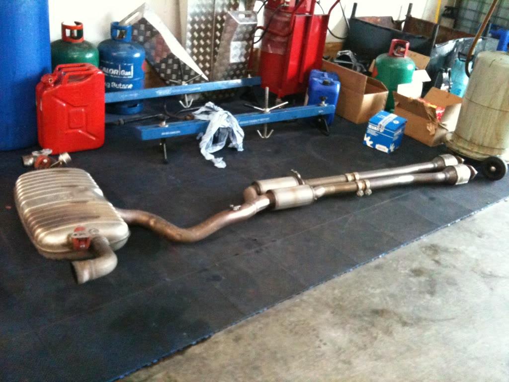

I then added a full turbo back race exhaust from milltek which is a fair bit lighter than the OEM exhaust which weighed in at a massive 35kg.
Stock
Milltek vs oem
« Last Edit: November 12, 2012, 11:47:19 pm by Poverty »

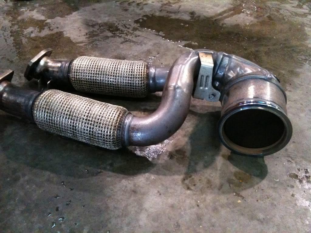

can,t believe the ristriction in the exhaust pipe in the first pic

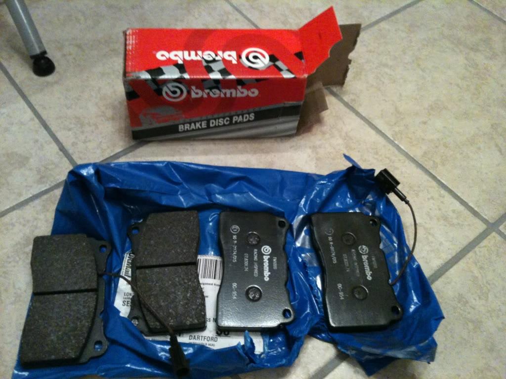

Next I looked at the brakes. The OEM pads were very dusty and didnt last long at all.
I bought some brembo blues for the car.
In hindsight these werent a very good addition as the soon killed the admittely not very good stock rotors.

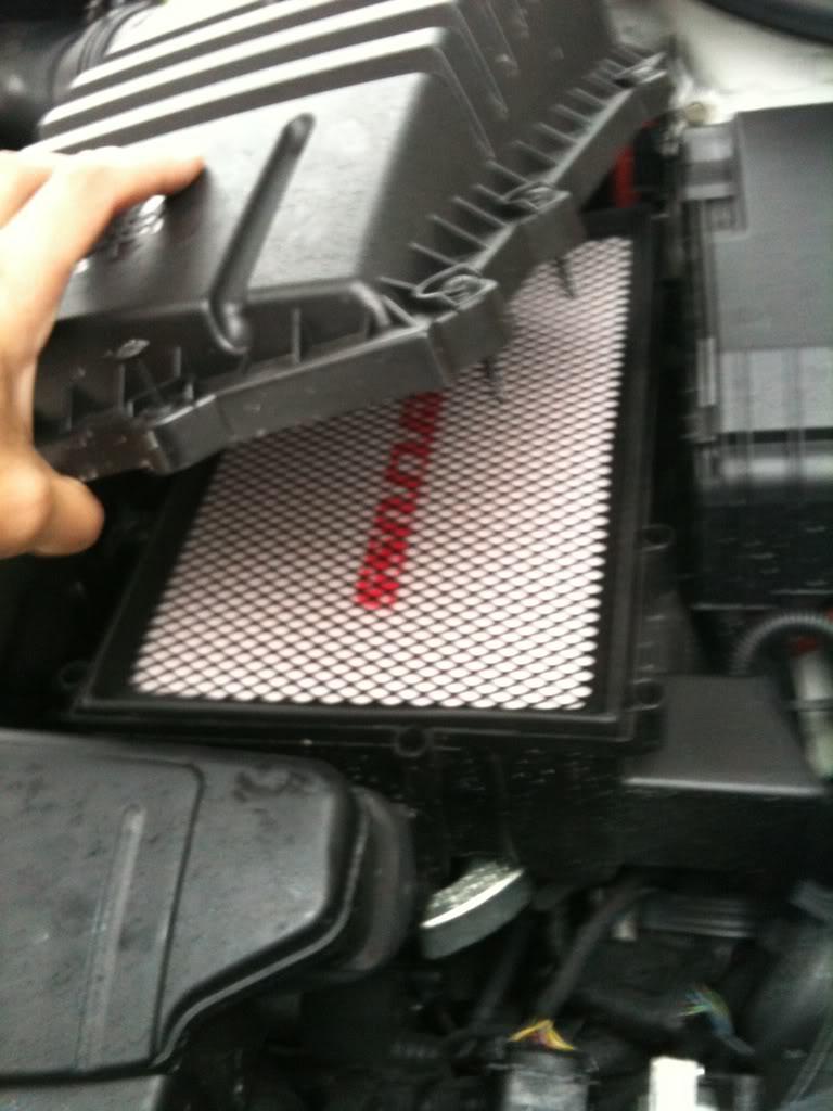

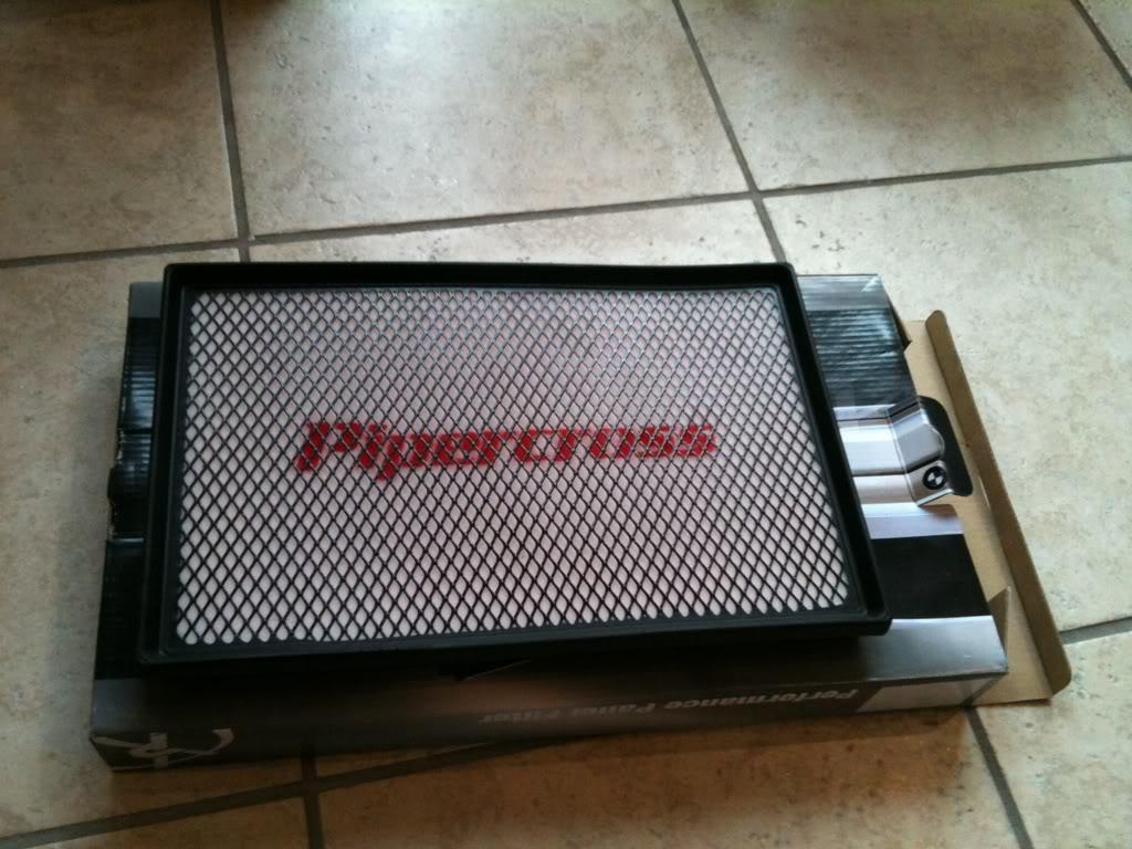

Next I changed the panel filter.

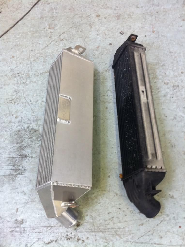

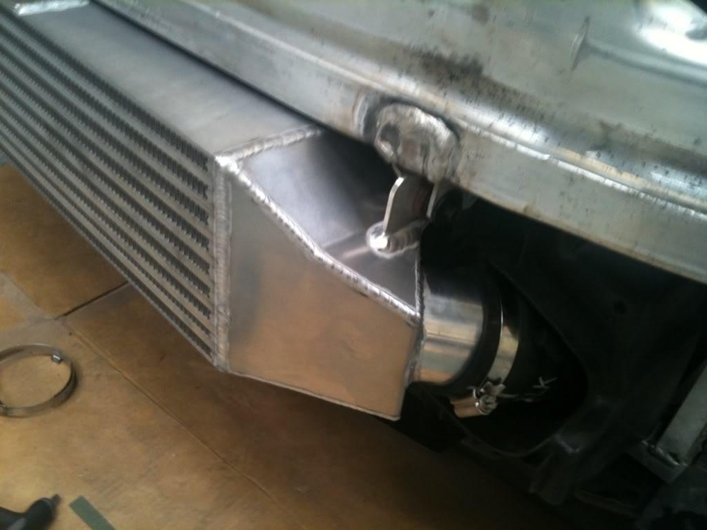

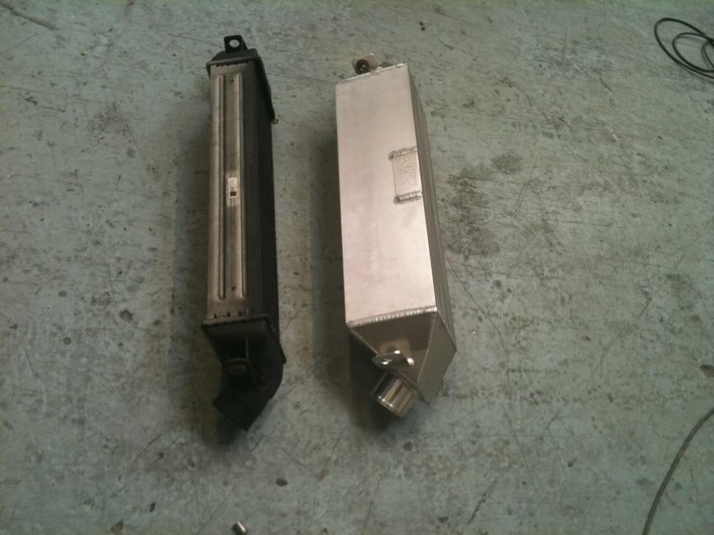

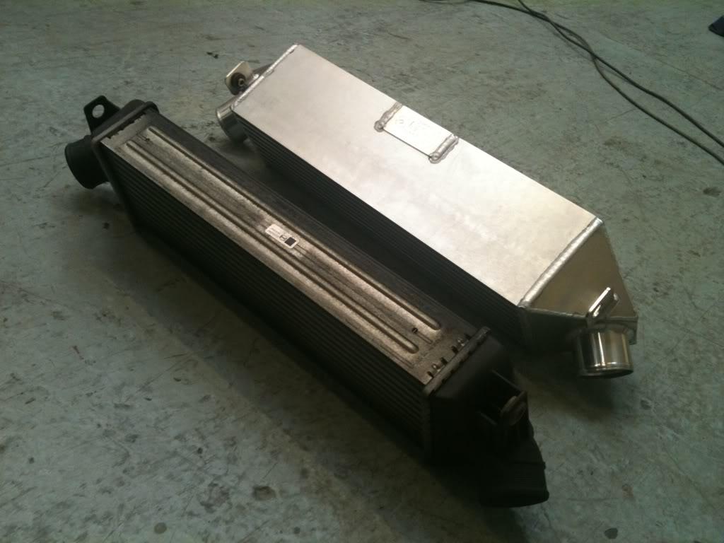

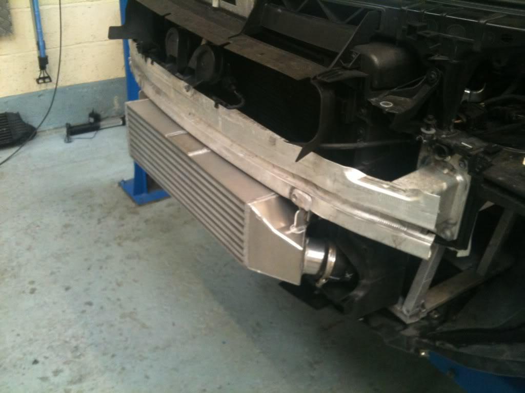

I then looked at the intercooler. The stock intercooler is tiny so I fitted a forge motorsport unit. I got it fitted at Forge HQ, got a chance to meet the big boss Peter who is a really nice guy and really enthusiastic about his products which was nice to see.
Yeah its quite restrictive, especially with the primary cat right at the inlet. Alot of people have decatted this exhaust and seem to have improved things alot.
It being a two pipe system as standard means its actually got greater flow capacity than a single 3" bore, but you pay for it in weight, and the restricive DP.
