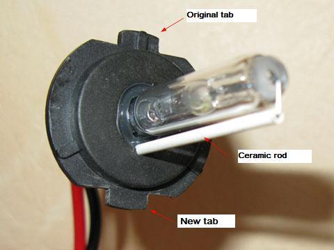

I have the depo lights since februari 2013.
You need a slim ballast, canbus, 35watt, 5000k or 6000k H7 (non C or R) hid kit.
Look for a good  quality kit, so you don't burn your wiper motor (common problem with cheap hid kits in the mk5).
You need vcds to turn on 'xenon without shutters', so you don't get faultcodes and ignitors/start-up works every time (also with the coming/leaving home functions)
You need H7 xenon bulbs with the ground return wires on the good side, otherwise you get ground shadows. You can also cut out a small piece of the socket, to turn the H7 bulbs. See my pictures:
http://www.mk5golfgti.co.uk/forum/index.php/topic,56795.msg697548.html#msg697548 and further in the topic.
Example:
(not my photo, I have steel sockets, so I used a dremel to make a new tab in the steel ring)

Problem I'm having is all kits seem to have the ground wire at 12 o'clock...! Do you know of any that don't..?!?
I couldn't find them with the wire on the 6 o'clock position. So I did the modification myself. With a dremel.
