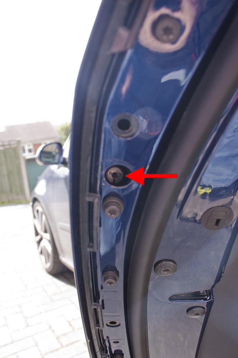

My passenger lock mech needs changing and the guide to replace on here is perfect, however I seem to have fallen at the first hurdle. The screw that sits behind the circular tape is being very stubborn...
This one...
thanks to OP for the pic hope you dont mind me borrowing
I can't remove/loosen this screw... Well not entirely true I can turn it as if to loosen however it just turns without unscrewing and so will not release the barrel module which means I can't remove the door handle or take off the outer door skin.
I did remove the other screws holding on the door skin hoping that I could get a bit of space to get behind and somehow loosen but with no luck. I haven't removed any of the interior cards to see if I can get at it that way.... Does anyone have any suggestions?
Many thanks in advance
Tim

prise the cap of the front and remove the hidden screw.
You don't need to remove the screw at the side, just rotate it so it releases the handle

when I take the cap/sticker off I can turn the screw however it just rotates inplace and doesnt release anything. When I try try the other side that unscrews?

The screw behind the tape will turn where it is. You do not unscrew and remove it. All it does by unscrewing it is to turn a mechanism inside that will release the lock barrel/barrel blank. Try undoing it as far as it will go without forceing it, then pull the door handle open and you should be able to remove the barrel.

Figured from instructions that this element rotates enough to release the barrel however all the screw does is go round and round, no change in tension or movement in or out... I have tried holding the handle and applying slight tension as turning the screw hoping to find the bite of the connection with the barrel but there is no change. When I try the drivers door there is a totally different feeling, as turning you can feel there is a connection to something where as the passenger side just rotates with little tension...

it probably has corroded, so try spraying some wd40
there is no access from the inside

If it helps, the screw on mine felt OK but the barrel didn't release and had seized in position, it was a ball ache to prise out.  I used plenty of penetrant and ended up prizing it out which wasn't ideal.  Everything after that was a piece of cake though  :happy2:

You can turn the screw clockwise or anti-clockwise there is no change in tension surely it should 'tighten up' in order to put everything back together even if I cant get the barrel out?
