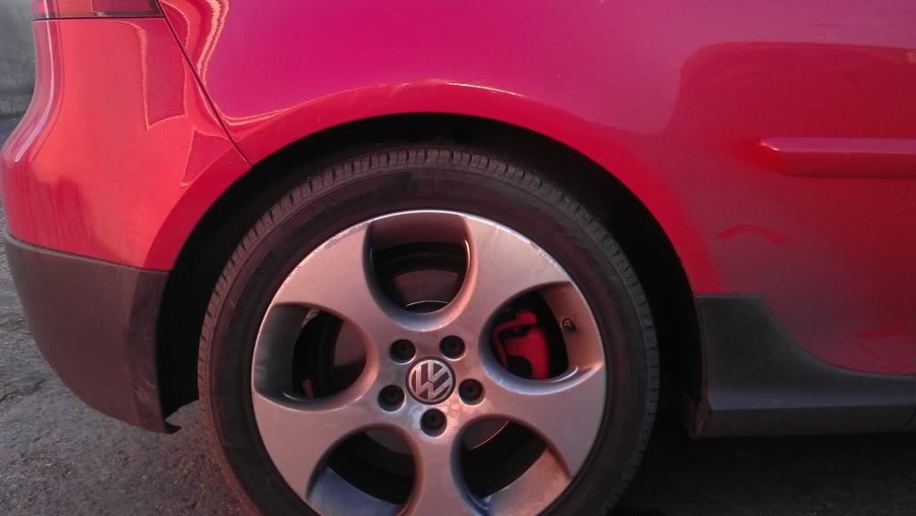

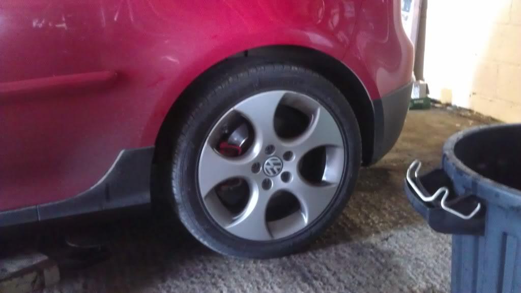

Before:
After:
« Last Edit: December 01, 2012, 02:22:59 pm by podgemasterson »

« Reply #12 on: December 01, 2012, 05:51:26 pm »
that cant be right can it????

« Reply #13 on: December 01, 2012, 06:21:39 pm »
http://www.venommotorsport.com/product_details.php?id=13018&manufacturer=FK&category=Suspension
Looks like you have got the wrong ones, they are for a 50mm strut??

« Reply #14 on: December 01, 2012, 06:51:24 pm »
yes deffo the wrong ones. If ever buying springs and they say they fit an altea then they are NOT for the gti. They have to specify GTI. I found this out the hard way also.
