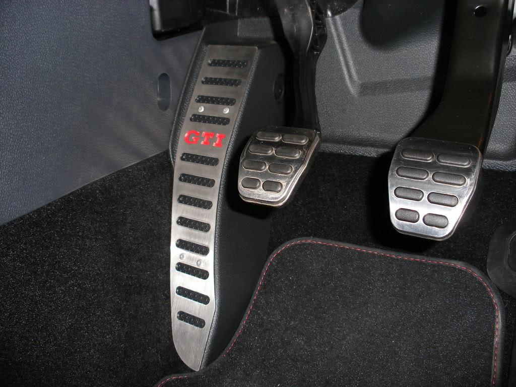

« Reply #8 on: June 28, 2009, 10:08:35 am »
I used the proper bolts that are sent with the foot rest for mine - looks much better this way IMO.
There is a large screw just behind the brake pedal, and a second screw on the right side of the footrest. You can see both in the pic below...
Remove both of these, and the entire plastic casing slides up and out very easily.
You can then fit the footrest with ease using the bolts.
Put some red insulation tape or somet behind the 'GTI' cutout to make it look even better  :wink:
