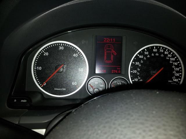

Offline Mandy
  • -Given: 95
  • -Receive: 94
  • Posts: 1701
Re: Help required from early mk5 Gti owners with highline.
« Reply #22 on: December 05, 2012, 10:37:06 am »
Not the best pic
Andy, was your ignition on when you took that pic?
« Reply #23 on: December 05, 2012, 10:40:46 am »
The ignition was of Mandy when i took the pic
Offline Mandy
  • -Given: 95
  • -Receive: 94
  • Posts: 1701
« Reply #24 on: December 05, 2012, 11:23:11 am »
Do you have a pic of the display when the ignition is on? :smiley:
« Reply #25 on: December 05, 2012, 11:24:18 am »
Give me 2 ticks and i will go and get one
« Reply #26 on: December 05, 2012, 11:44:59 am »
Here you go  :happy2:
Offline Mk5 GTian
  • -Receive: 37
  • Posts: 1374
« Reply #27 on: December 05, 2012, 01:24:21 pm »
Mine is exactly the same as Maxitrol's when the driver door is open, either with ignition key in and engine running, ignition key in but engine not running, or ignition key out.
