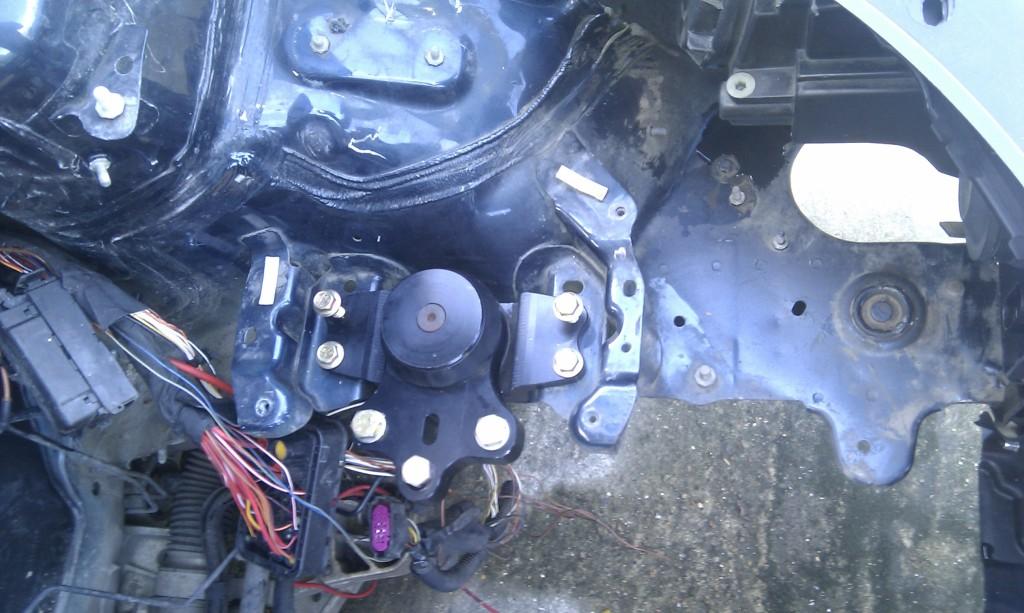

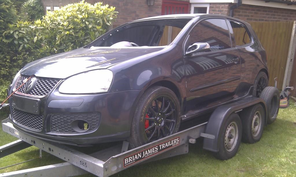

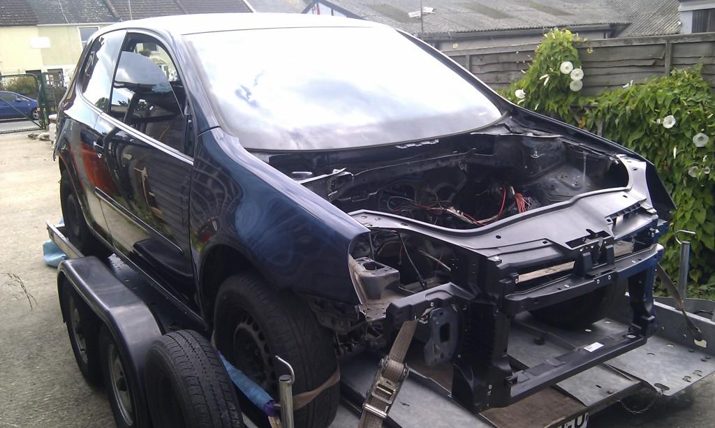

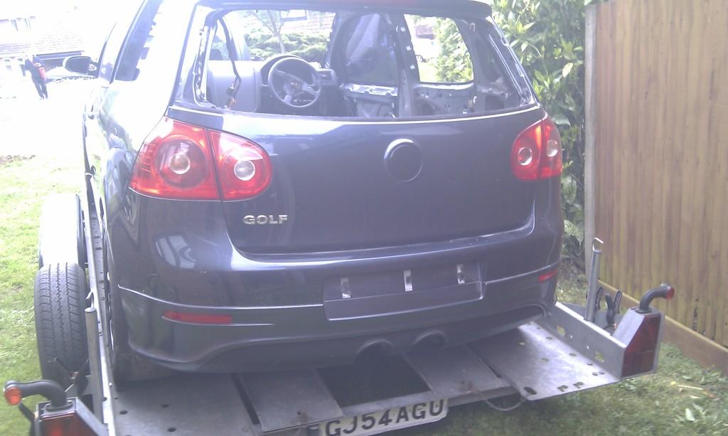

 Ive managed to buy a rolling 3dr GTi shell for next to nothing and have decided to turn it in to my next race car for the Quaife Motorsport saloon car championship (QMN) currently i race a 420bhp mk3.

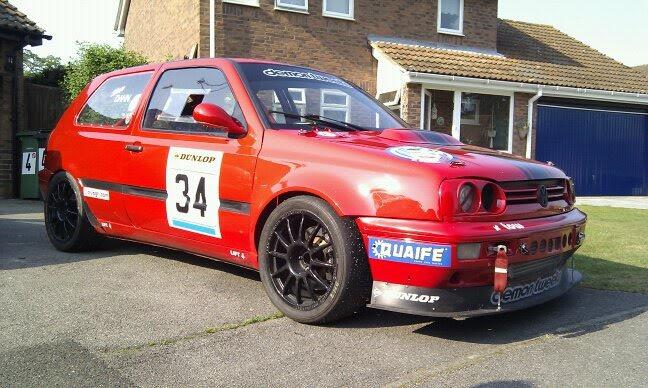

The MK3

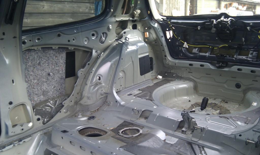

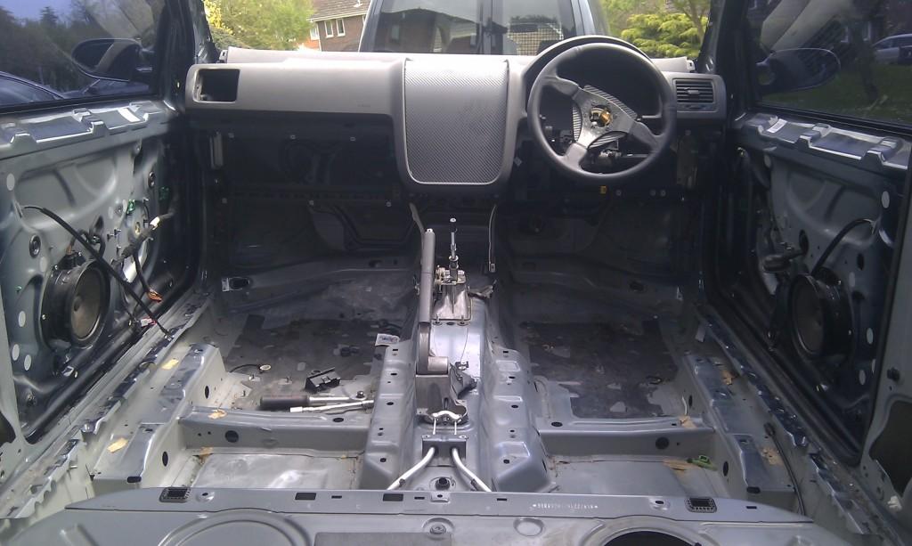

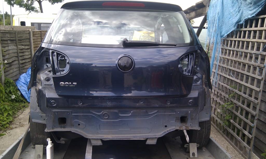

The rolling shell

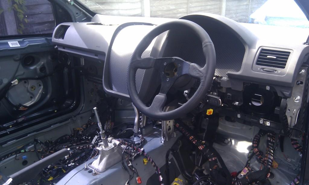

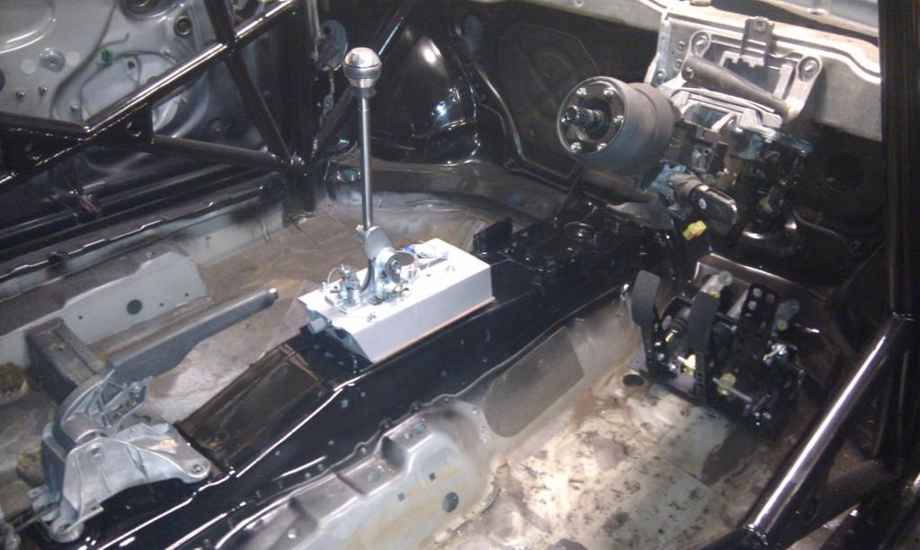

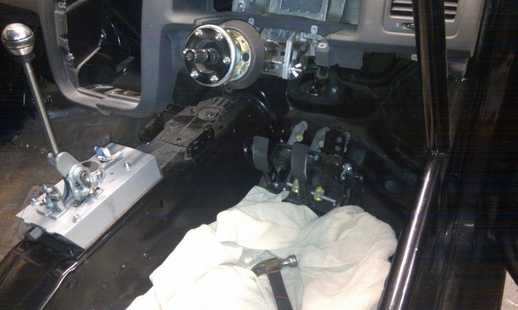

Sqs Shifter

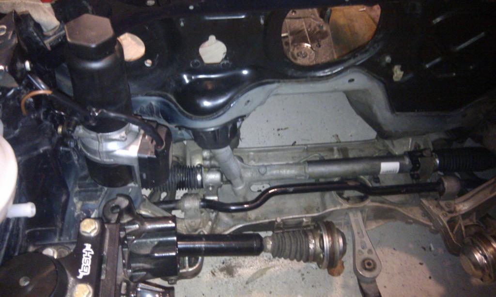

Caddy power steering rack

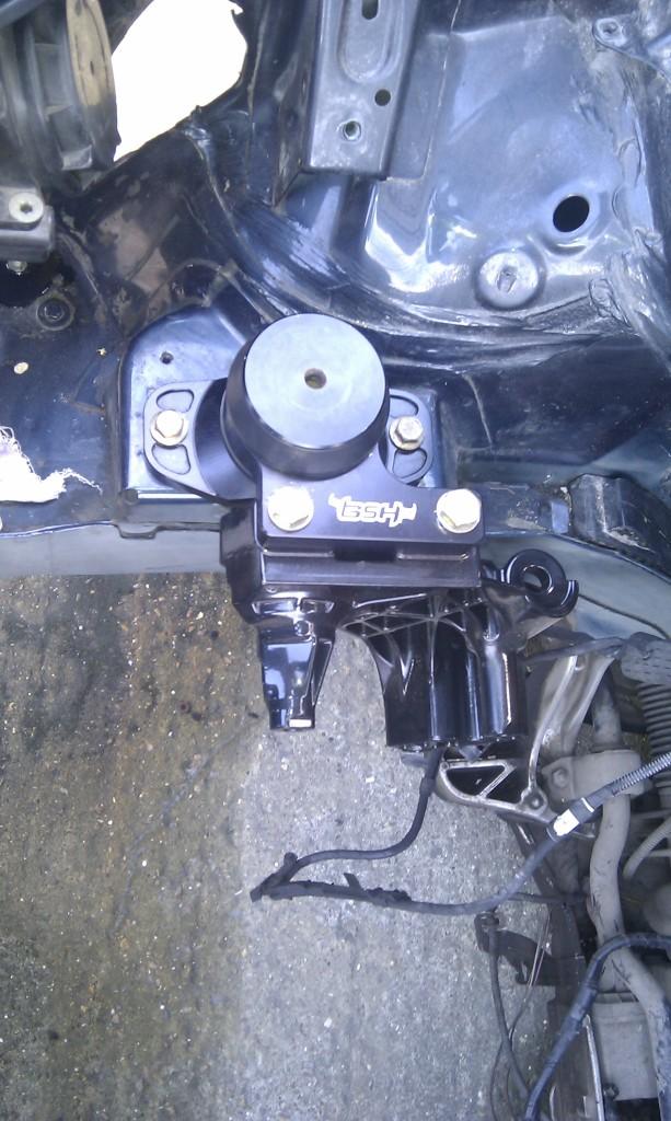

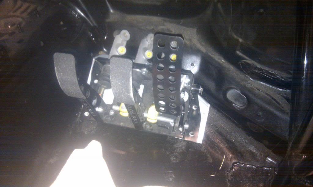

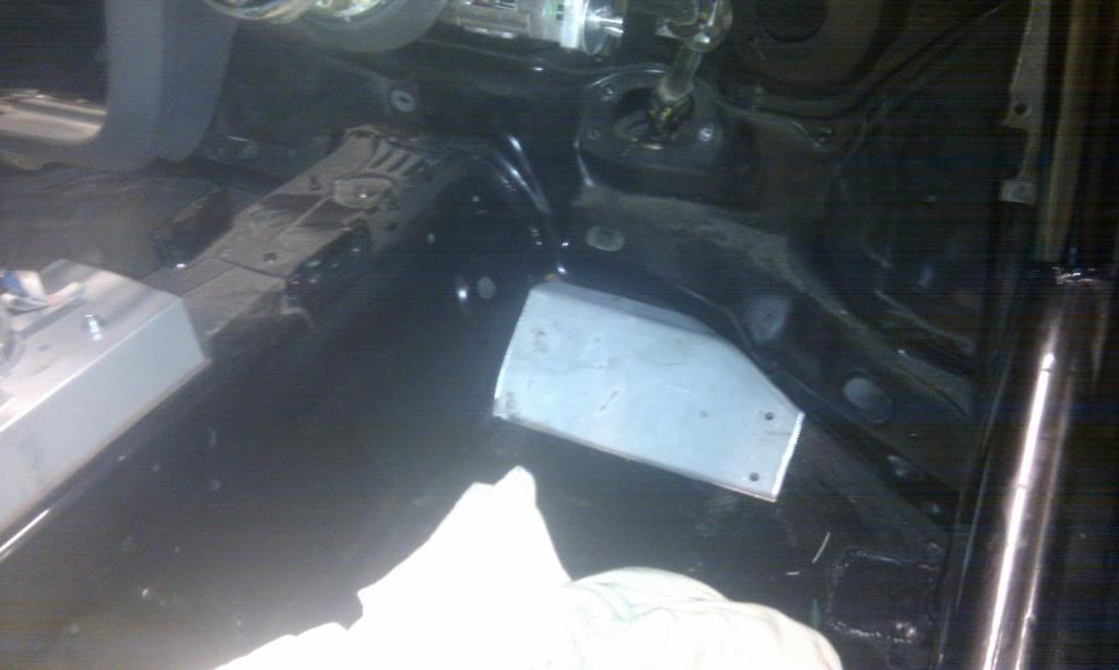

Pedal box mount

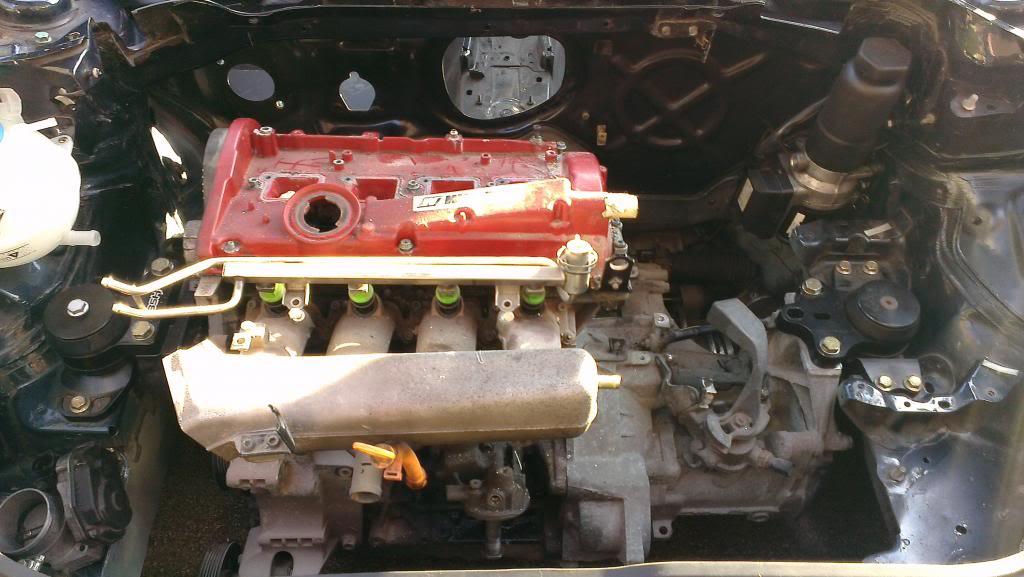

Dummy engine in, Yes a 1.8T only because i'm using my old MK3 engine with the Dog box, the only problem ive found is the drive shafts dont fit the 02j box.

Looking good Steve.  You still running me old BT downpipe on the GT28 turbo?
Check the length of some MK4 golf gti shafts as they may fit.

Hi ive now got a 2871 rebuilt by CR turbos with some fancy internals, Ah would the outer cv splines be the same?
Offline vRSAlex
  • -Receive: 253
  • Posts: 2761
Re: MK5 Race Car
« Reply #5 on: December 08, 2012, 05:07:19 pm »
They should be the same.  You should be able to swap the outer cv's to the MK5 versions if they are not.
