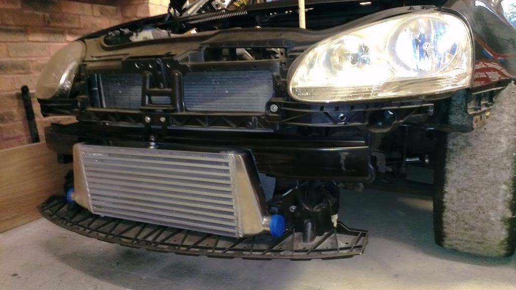

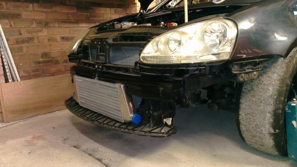

Progress today ive managed to fit the intercooler.
all seems ok
Next job get the inside finished and flock dash

Yep  Its a similar cooler as i run on the MK3 with 420bhp so should be fine I assume they are made / designed to fit in front of the crash bar but i wanted to push it back away from the bumper a bit as we do have the odd nudge, it just protects it a little more. Oh im not keen on the silicone hoses they supply so they will be changed.
THanks again.
Yeah looks good mate, good to see it reached you all ok! The packaging was pretty good. I did look at the piping and it did look 3 ply but you never know! At least the clips were goodens :)
