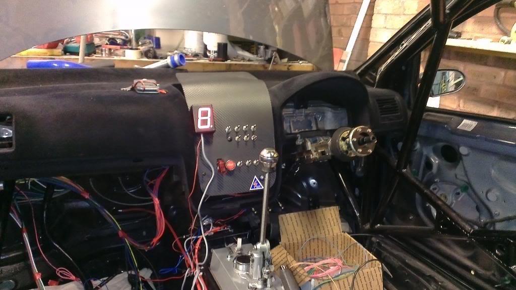

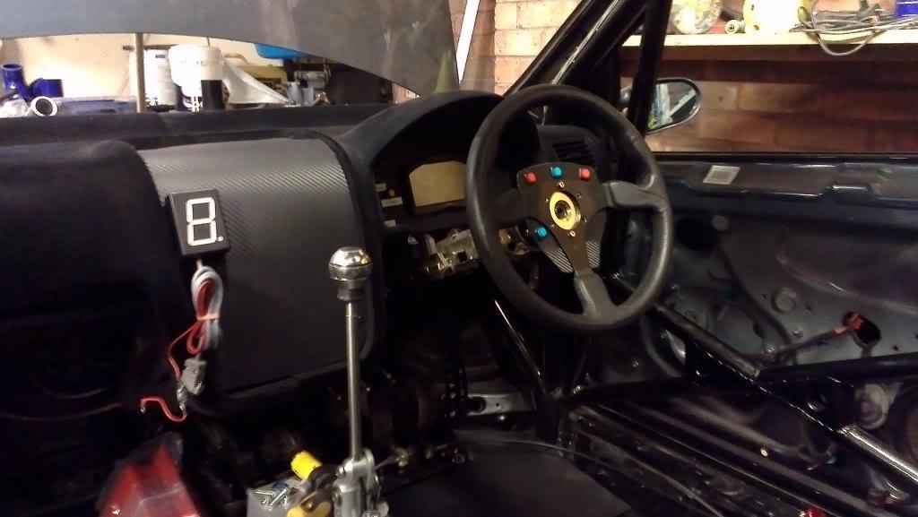

Dash looks awesome! Good job

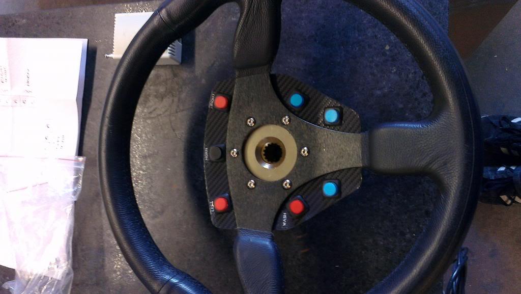

Steering wheel done just need ato add three more buttons.
Next job custom power steering pipes and fuel lines.

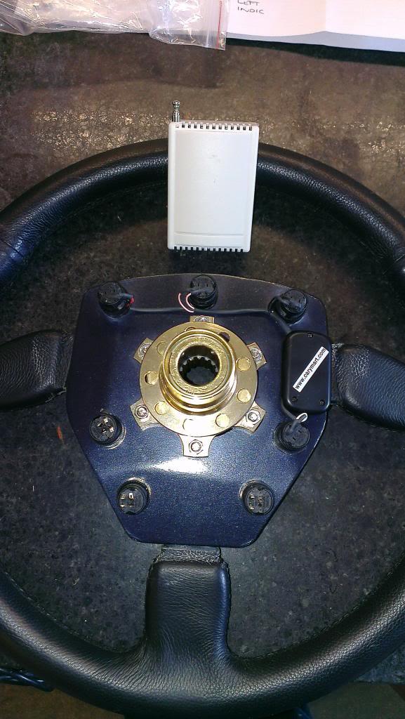

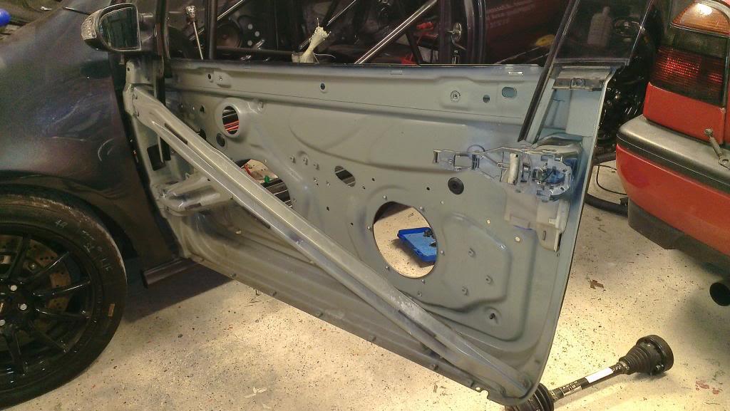

Sorry no updates ive been a bit busy on wiring, Ive managed to strip the n/s door and now weighs next to nothing.
Ive managed to finish four of the eight wireless buttons that will control indicators, horn, flash, wipers etc
