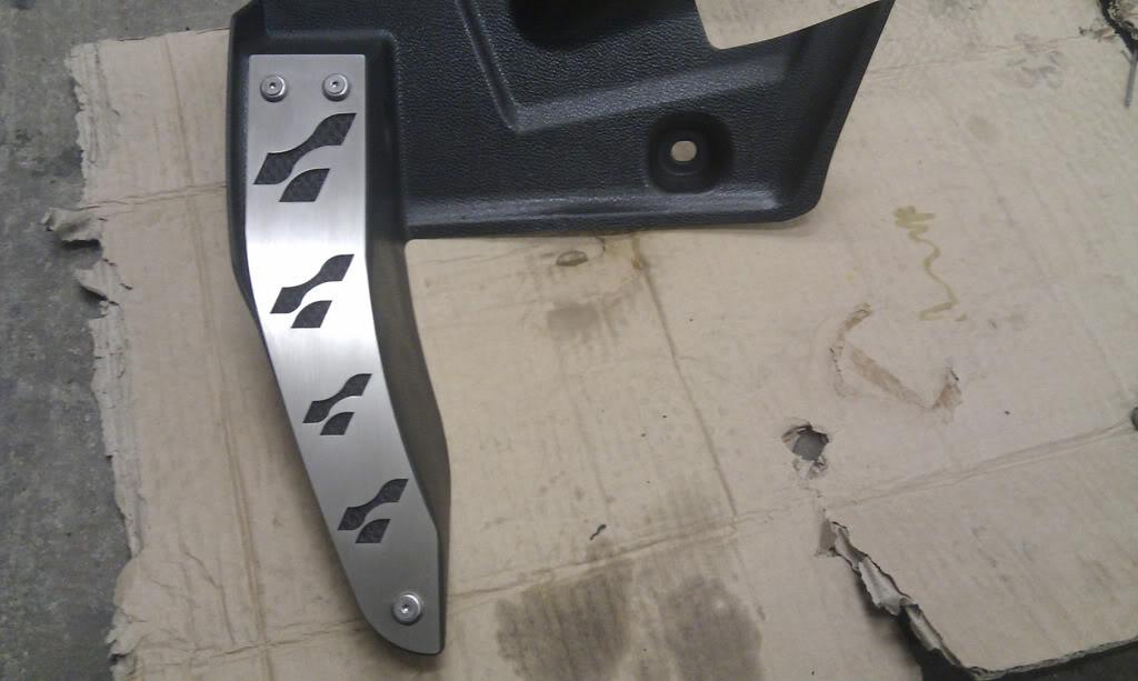

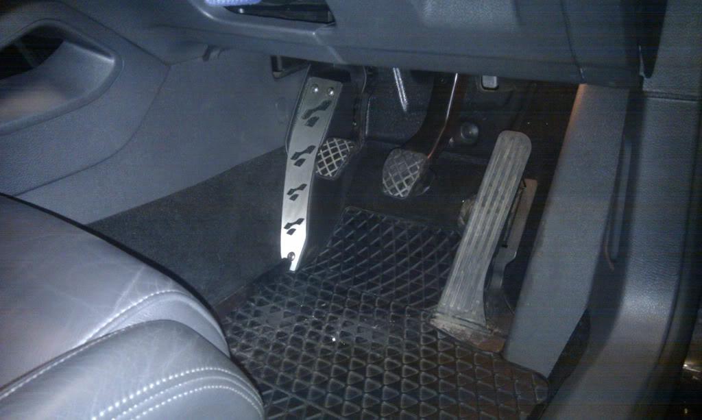

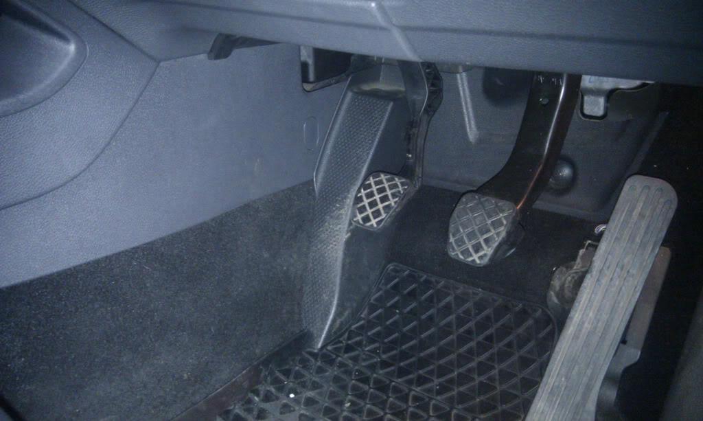

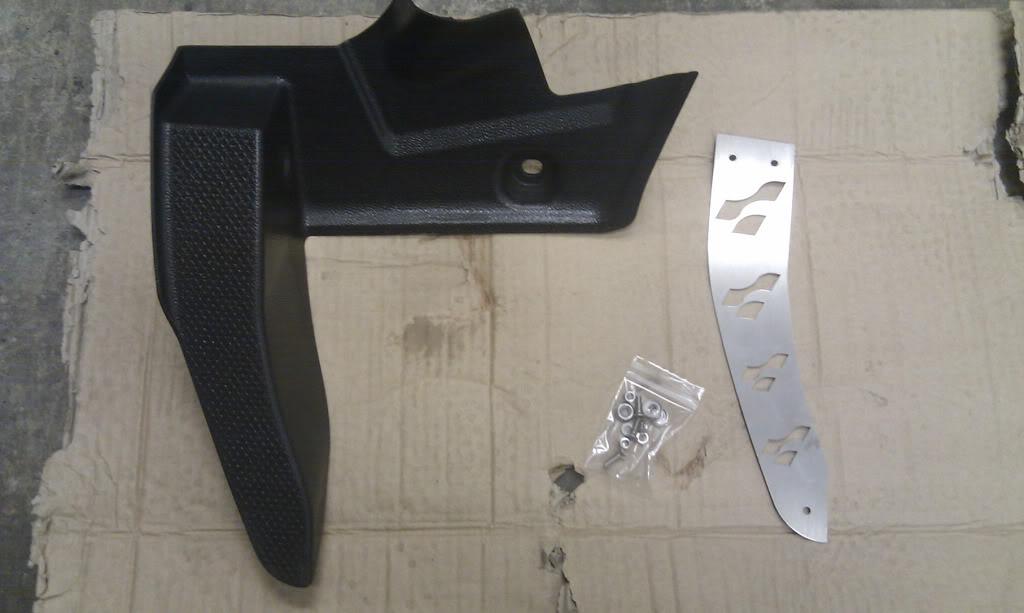

I have pics of when I fitted mine but it is quite easy. Ill dig the pics out.
Remove plastic cover
Line up plate on plastic.
I marked mine up and drilled small pilot holes
Then fit the plate using bolts / screws provided.
Refit cover that now has plate attached.
EDIT: pics added.
Before
After
Jas
