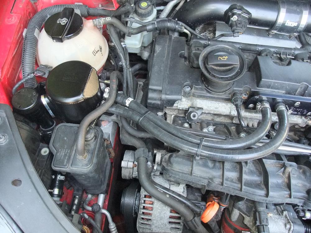

My car has the larger BSH can and is on the right side as you stand in front of the car looking at the engine bay in front of the battery... only issue with that location is that i also have the BSH intake and the "heatshield" metal piece to enclose the cone filter wont fit which is a PITA!

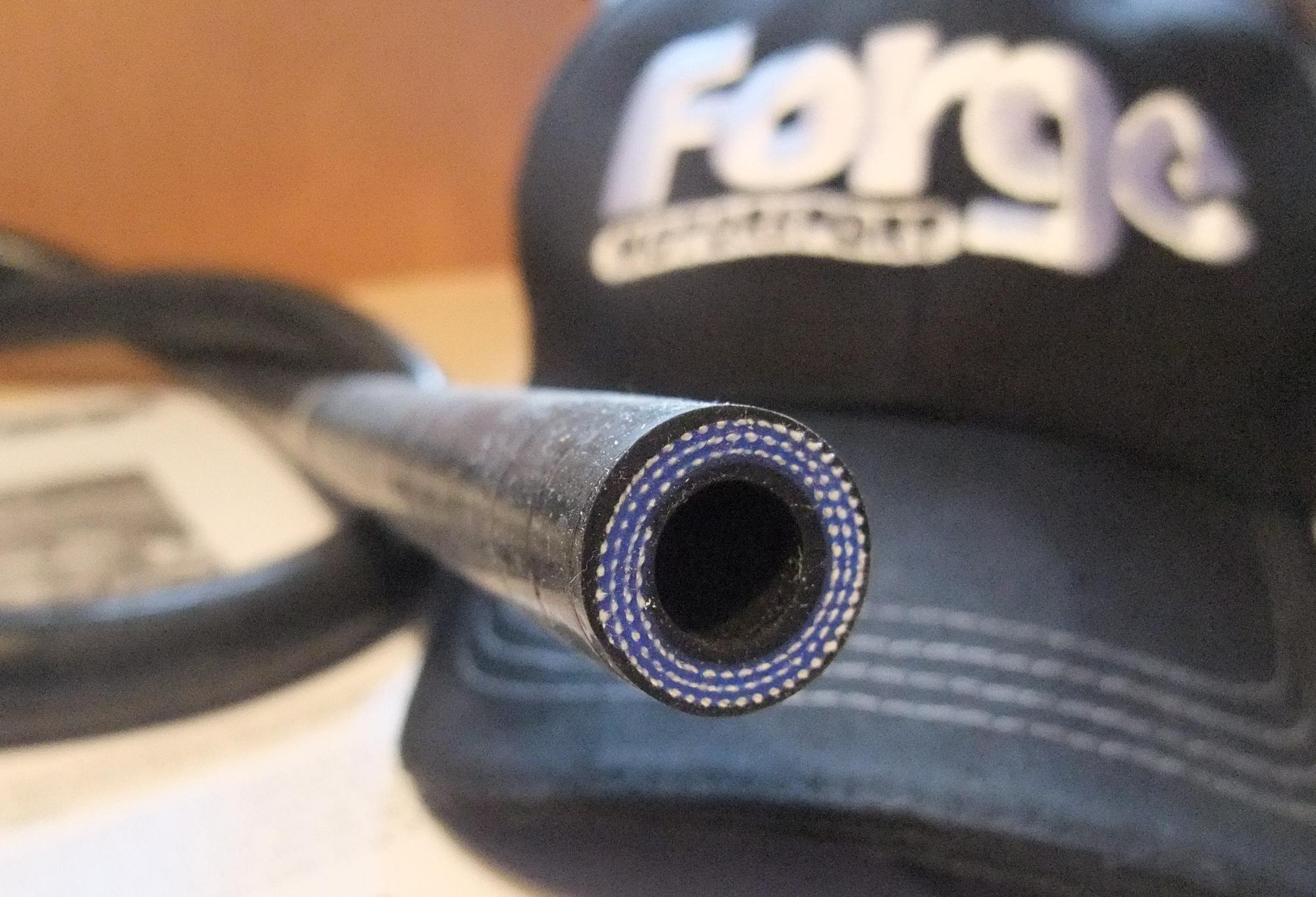

.... x 2 - You definitely should use fluoro lined hoses. They look like this.......................
I got rid of my BSH catchcan :pomppomp:  and I much prefer the Forge.
My fluoro lined hoses are fairly flexible.....................
