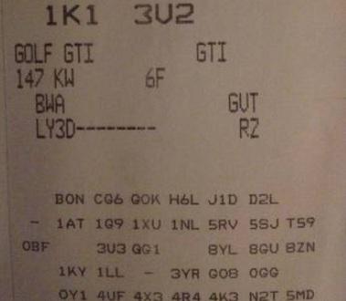

« Reply #10 on: January 07, 2013, 11:22:35 pm »
Look at the production sticker in your manual. Where mine says 'GVT' is the gearbox code.

Ok will do. What is the better code to have and how does it make a difference in recon etc?
From memory it is later BW.. engine and a 2006 year so im assuming gvt box as your sticker.

There are many variations of box fitted to the GTI. I'm just curious as I'm having similar issues.
