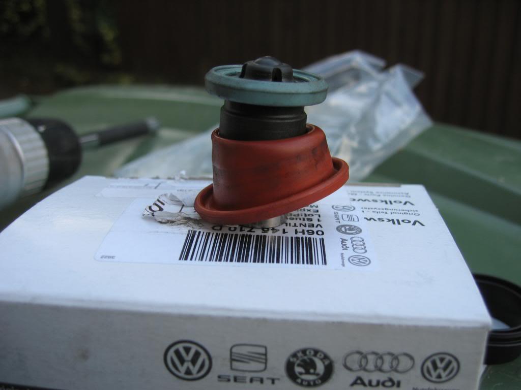

I was surprised when I removed my old DV how well it had fared with no rips or tears, just a bit of bagginess on one side: -

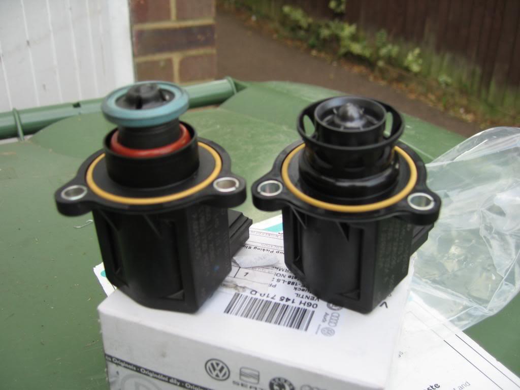

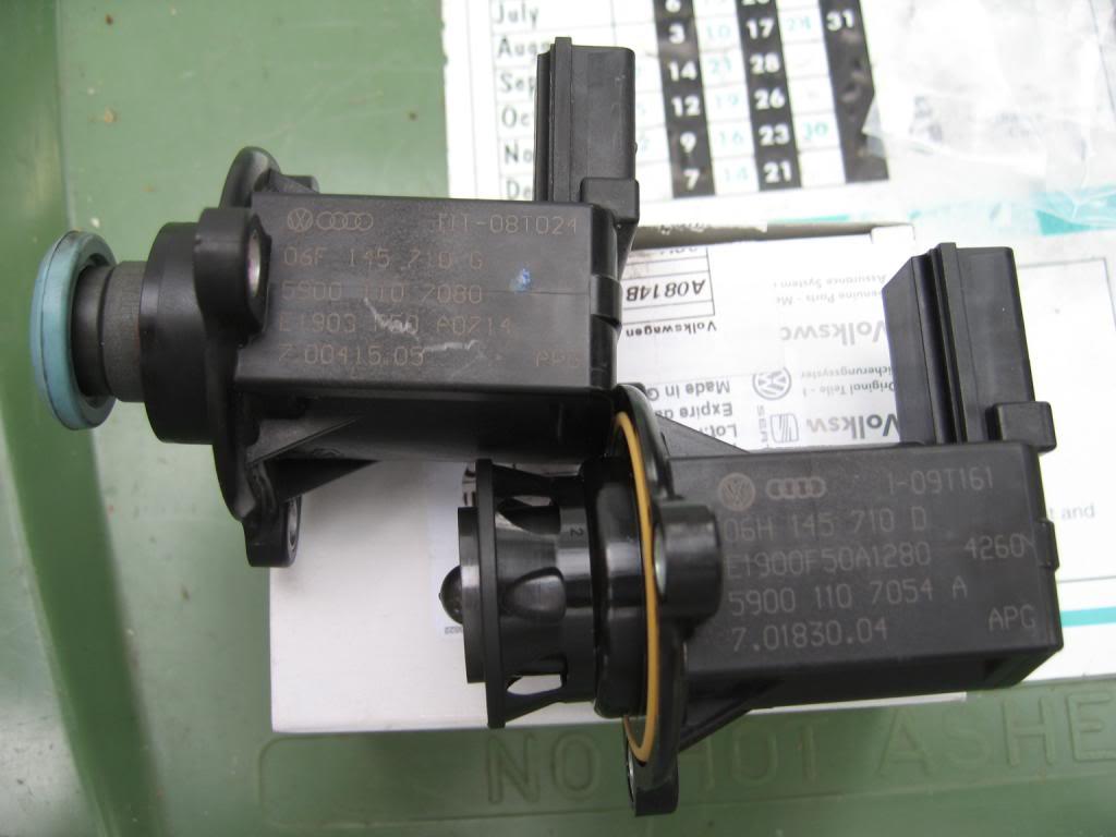

Here's the some pics of the new DV up against the old version 'G' one: -

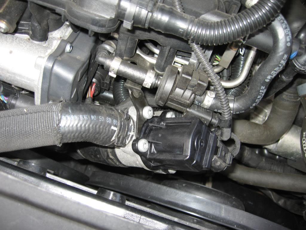

Once installed looks no different on the outside: -
I know it's probably the placebo effect but the car feels better on the new DV and seams to be pulling ever better than before.
Need to get out and do some logging to see if it's holding the boost better than before  :happy2:

Great one Steve, what's the part number for the revision D DV?

It is 06 H 145 710 D  cost about £40 :happy2:

d version Was never meant for the tfsi. It's used on the new tsi engine in the Rocco and new gti which has a different turbo. The g revision is still listed as the correct part for our engines

You will have revision 'G' Luca (mine is also a 2008 model).

Indeed. But there are no piston type DVs that are solinoid actuated available for our engine - except the 'D' out of the TSI. The 'G' is still unfortunately, even its improved form, a diaphragm based unit with all the flaws that brings.
I for one am very happy with the workings of the 'D' on my TFSI.
