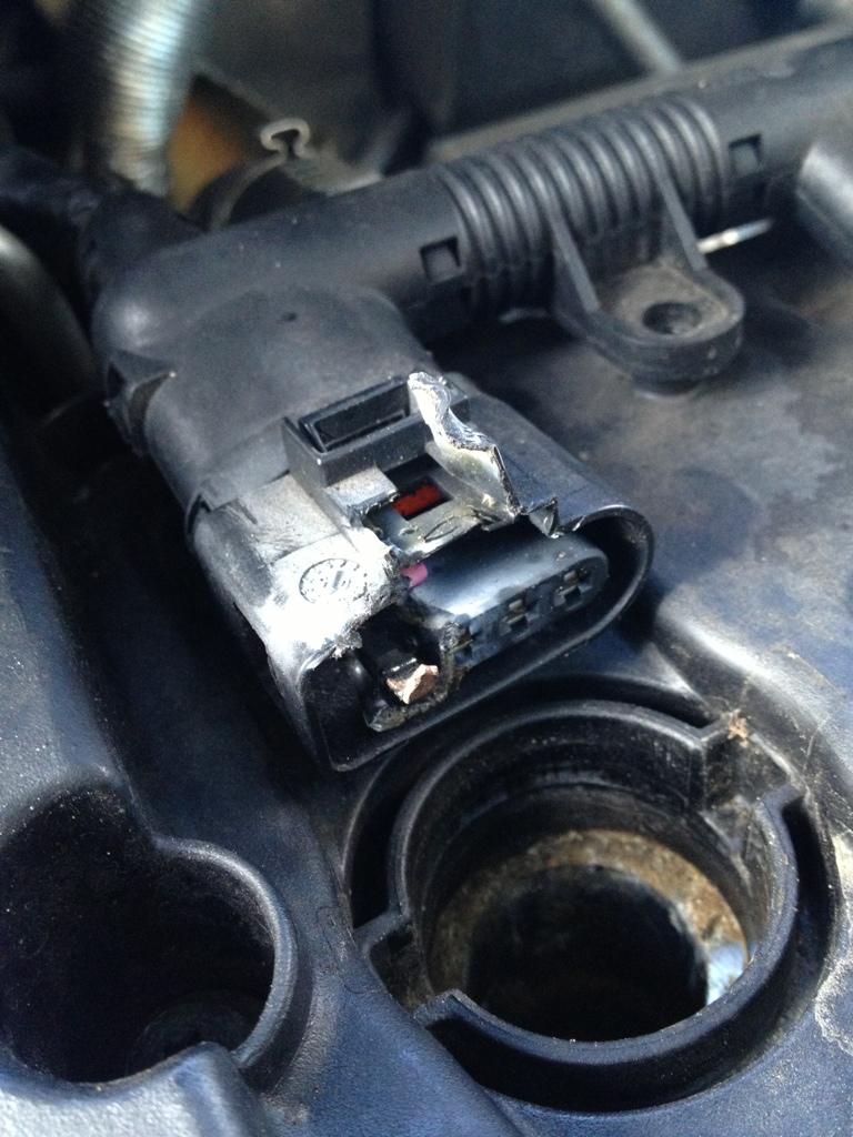

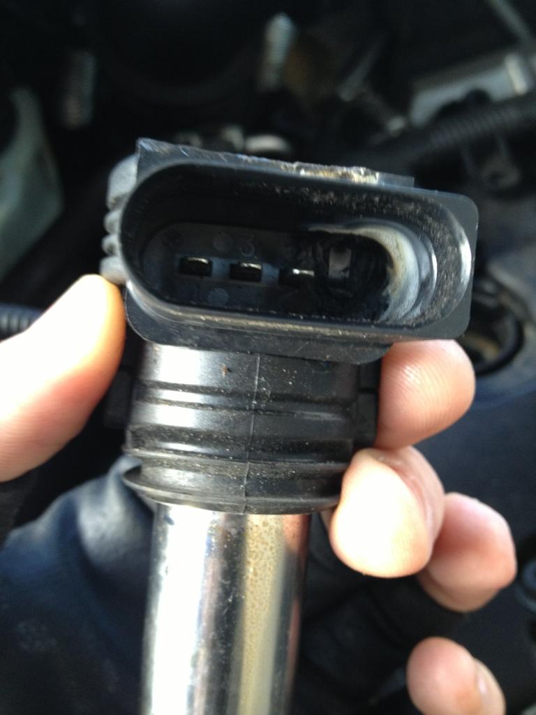

Offline ripmateyy
  • Posts: 342
Re: GTI starting Problems :( **Think we found the problem**
« Reply #13 on: January 11, 2013, 07:10:22 pm »
Found this today...
So went to VW about recall, apparently they cannot help me as 'my car doesn't have a recall on it'  :fighting:
