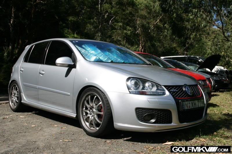

  • Posts: 1825
« Last Edit: July 07, 2009, 03:24:57 pm by wigit »
Re: The search for lightweight alloys
« Reply #5 on: July 07, 2009, 02:54:35 pm »
those look the biz
