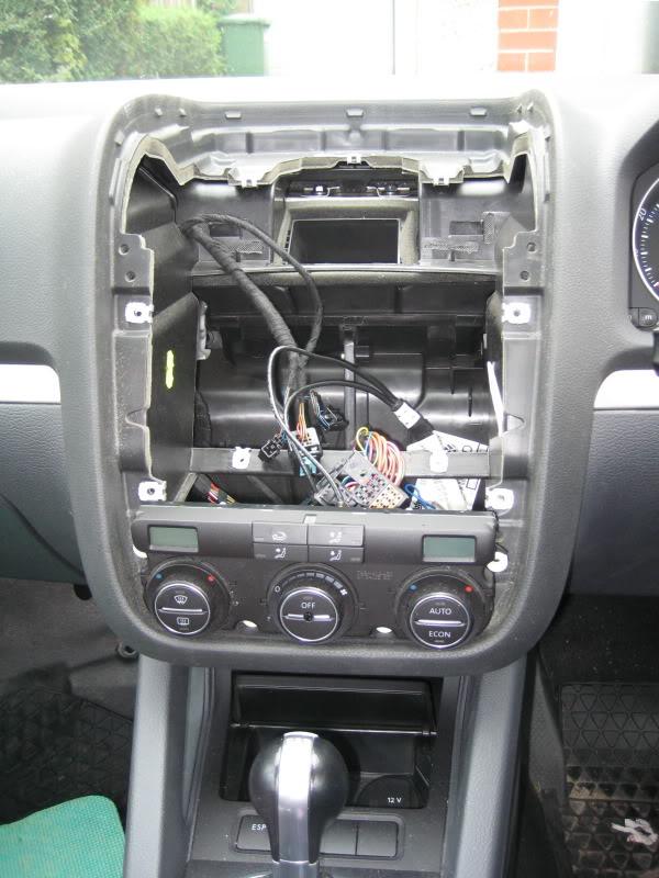

My sat nav's turned up in the post and I've started on the fitment...only I can't find anything metallic to attach it too. Everything in reach is alloy so the magnet doesn't stick. Everything in the hole where the stereo used to be has been removed and not sure how to remove any more of the dash. Any ideas really appreciated.

As already said a few photos....

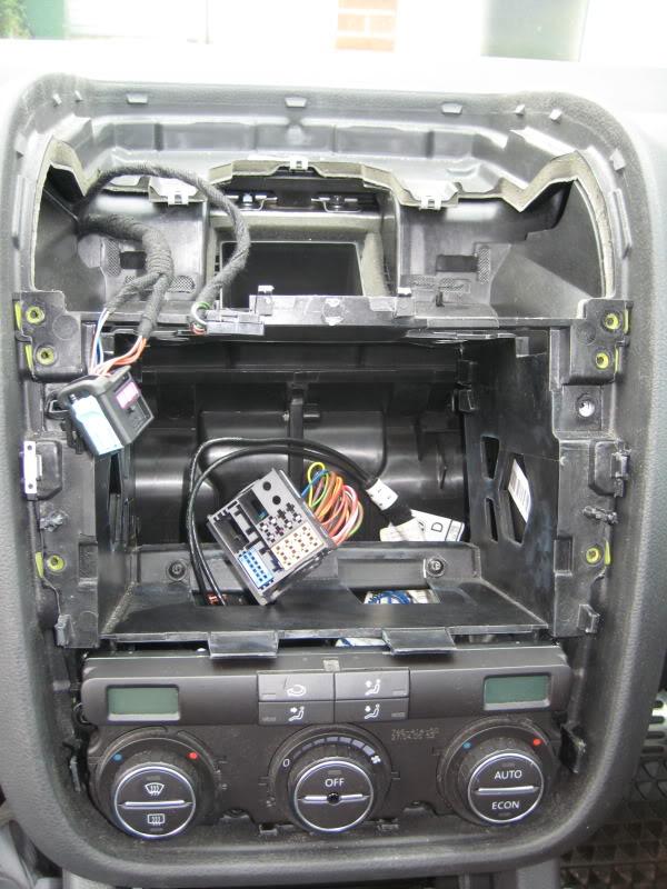

All vents, grills, facias and stereo cage removed.

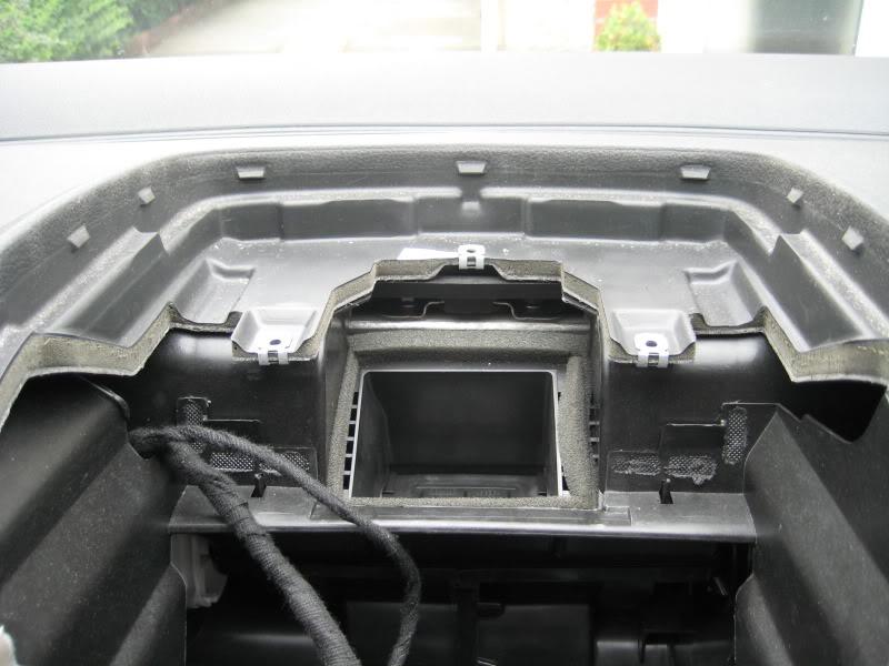

view of the crash bar through the dash.

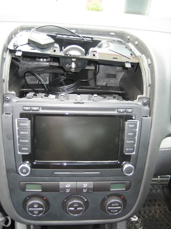

Cage and climatronic screwed back in.
RNS510 in cage with lower fascia in place and top fan cowl back in place with puck resting on top.

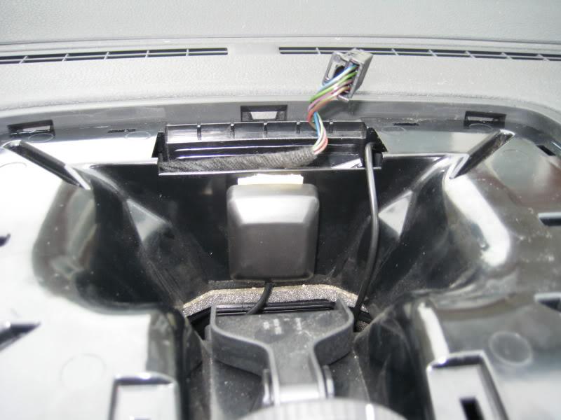

Puck velcroed to plastic fan cowl and lead tidied away.

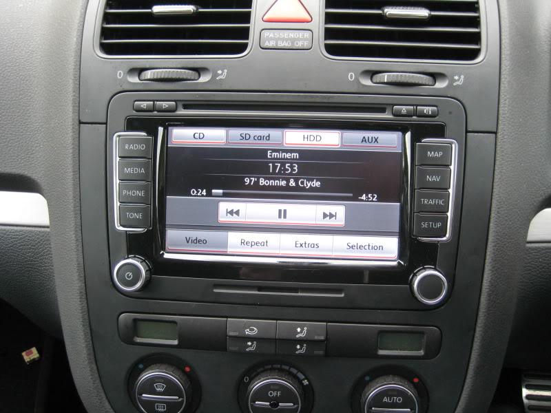

Everything back in its rightful place and playing music from the HDD.

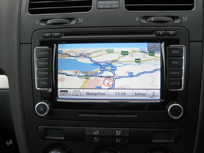

Finally the sat nav doing what it's supposed to...a map view.
It's about 500metres out so need to find out how to calibrate the unit.
Other than that its certainly not a 25 minute job but is a relatively easy job to do. I'm definately not happy with the pucks location though so will be looking into the shark fin option...roof linig removal and all, but thats defo for another day :laugh:
