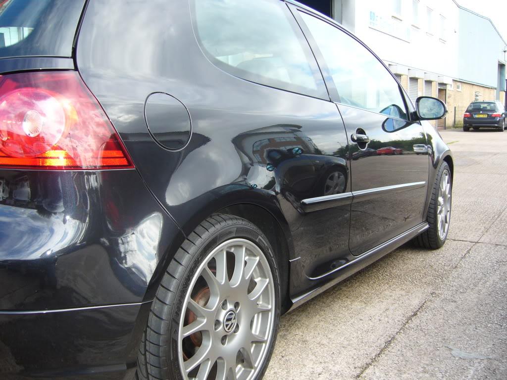

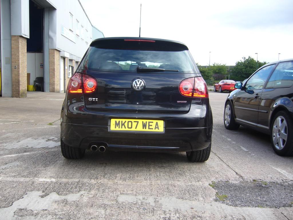

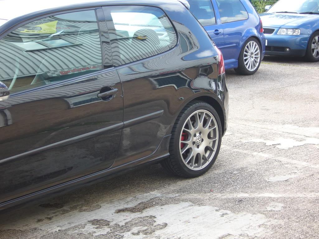

Before...OE suspension whilst outside Awesome.
After with KW Clubsports fitted:
Rides superbly now the settings have been fettled....happy with the way the car sits on the Pescaras which IMO suits the car.
