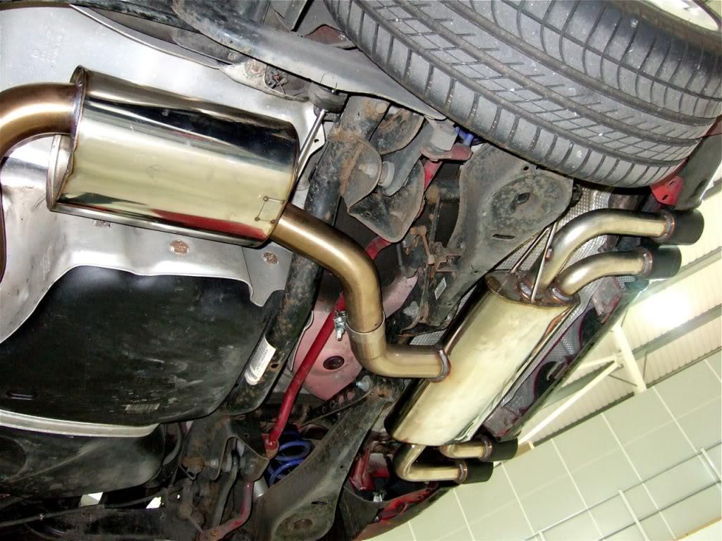

I've got milly quad tails. Still no louder really, sometimes I drive with the windows down explicitly to hear her. Especially through tunnels, then it's very very cool. Think it needs the hi flow and down pipe to make it louder.
....Yes, the Y-configuration quad pipes don't make any significant sound difference. However, the virtually empty rear box plus independent quad pipes make a huge difference - Such that a small resonator box is necessary.
When I'm ready, Milltek are going to build me a slightly louder resonator box to test but I want to get used to the sound mix with my new engine mounts first. Milltek will then subsequently be able to publicly offer two versions of 'loudness' in their usual way.

SO do these actually add much power to the car, or do they just look nice and make a nice sound?
....The Milltek system only makes a significant addition/contribution to power when you have the TBE (High-flow cat) AND you have a remap. The ordinary cat-back will improve throttle response and possibly add 2 or 3 bhp but for performance you need a TBE (includes downpipe) AND a reputable remap (from a tuner whom Milltek have tested with).
