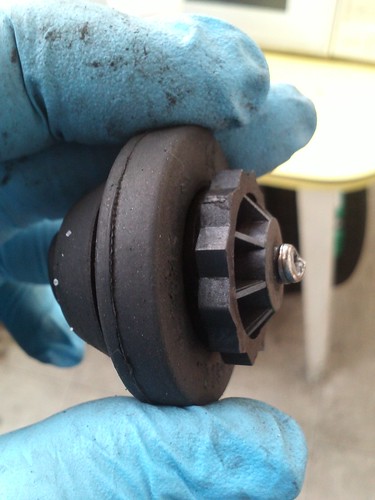

Well, checked my engine cover before heading to work and it wasn't actually connected on the front!! Anyway, took my lunch break to whip it off and see what had happened. I found that on the lefthand side of the engine the bracket was completely loose. And on the right hand side that this had happened to the bit the bung sits on.
IMG439 by sideshowfred1990, on Flickr
Needless to say there wasn't alot I could do about this bit today. I tried tightening up the bolt on the other bracket but couldn't get the star key I was using seated properly as, what I assume is the inlet manifold, was in the way.
As such the engine cover is still loose. But i've decided that instead of replacing the standard airbox, (as it turns out half the screws that hole it together are broken), i may as well buy an induction kit and bypass this problem all together.
Thanks for your help guys, made me more confident on how to sort this little niggle out

Is that the engine mount that's broken?  :confused:
No, it's one of the 4 pegs that the grommet for the engine cover locks on to that broken.
....A very common breakage due to the trickiness of removing the OEM engine cover/filter box.
