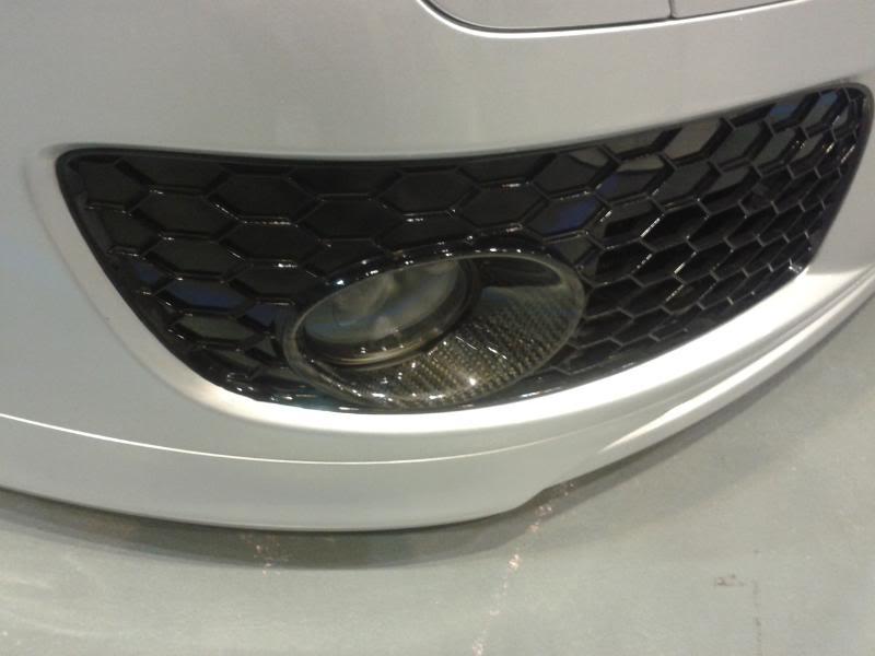

This one,
I'm am pretty sure Big Al with the silver 4 door GTI on air ride has his sprayed in gloss black.

Here is a picture i took of Al's grill at Ultimate Dubs Last year as i was so impressed with the attention to detail.
Edit:
That's the one alright :)
Looks horrendous but you have to admire the effort and craftsmanship!
The gloss black looks the sex!
