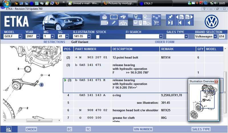

Would someone ETKA be able to help me with a part number? All it says in the description is bearing.
The number is 0A5141671E
Any help would be very much appreciated because I need as much ammo as possible to get this clutch problem sorted.

Hi Luke the part number you have given comes up with the clutch release bearing with hydraulic operation,
hope that helps mate

According to Google, its the concentric slave cylinder / hydraulic clutch release bearing...some people call it different things.
It was fitted to 1.8Ts and 1.9 PD engines as well as others, its a pretty universal part across the VAG range.
