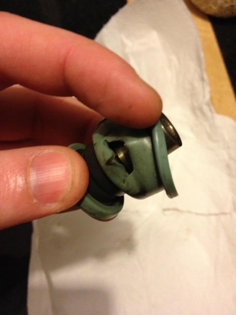

Ok fellas, now all you veterans will laugh and say "of course". But when i bought my GTI back in November is was the first turbo car a have ever had. It seemed to hold boost nice and really flew the gears.
Thinking of having my re-map done soon, so decided just to replace my DV with a new Rev G version just for precaution and better results.

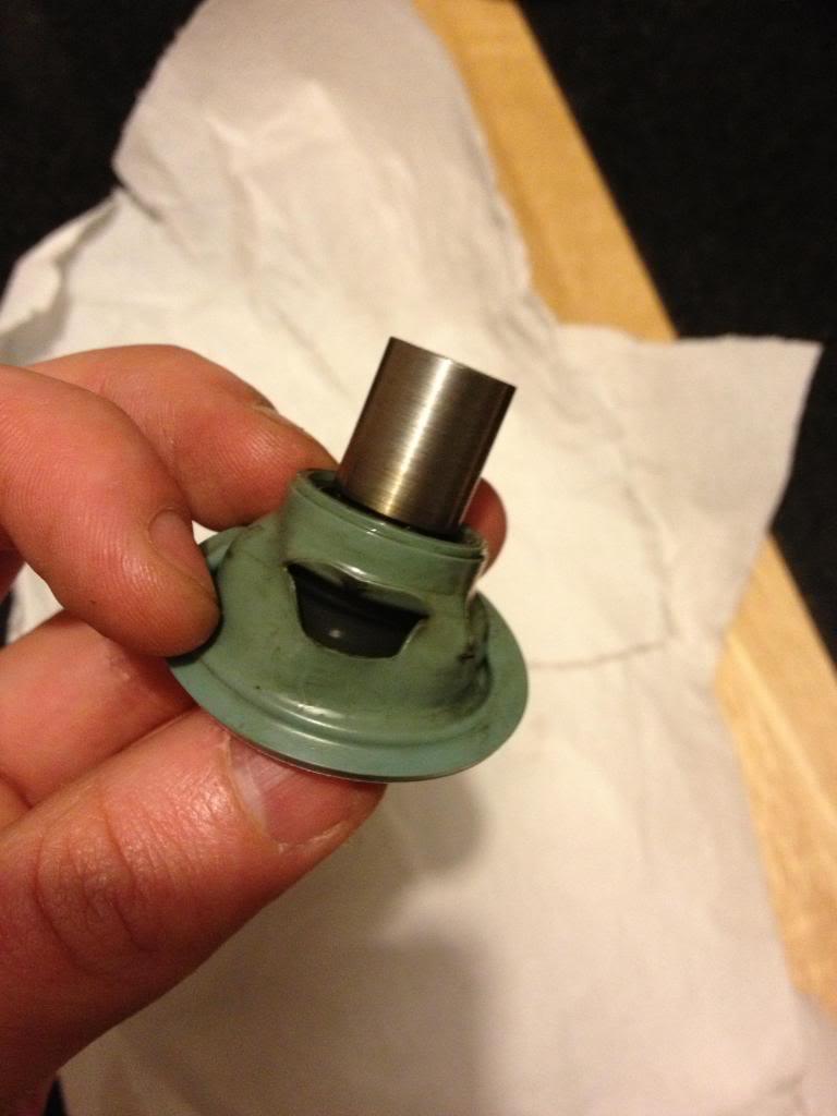

Not think it had a tear in my DV, took it off and wow was i shocked....it has a massive tear in it.
Now up till this point i really thought it was fine as the performance was good. Put the new one in and OMG !!!! It is a totally different car.... unbelievable the difference it made.
Know i know quite a few of you will be like as if you couldnt tell......But if you buy your car from a deal and you dont know what its suppose to feel like then it hard to tell, as in my case there were no tell tales sign that people have spoke about of here....like loss of power or a whistling noise.
Or well, just a message to other non-Vag Veterans, just change it anyway - you might be surprised like me.....Loving the GTI even more now.
Pics of tear:

Good news, and cheaper than a remap!  :laugh:
With similar results.  :laugh:

And stop biting your finger nails :laugh:

Any indication in the service book if its had it done.....Just one of them things, if you feel 10% unsure if it has a rip (like i did), then just change it, the new Rev-G felt so much better.

Sure will mate....Cant believe how big my split was and still felt fast.... :confused:

That's a massive split!

G is the way forward, every one says it hold boost better, and its not pron top split with it been thicker material.
