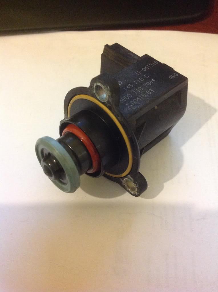

I had  mine changed from a rev C to a rev G a couple of weeks ago just as a precaution just before remapping.
This is what my rev C looked like:
In perfect condition even after 6 years :happy2:
You havent been beating it hard enough then........... :P

« Reply #21 on: February 19, 2013, 10:42:10 pm »
Yeah need to try harder to push my rev G to the limit :laugh:
Although mine is a low mileage example. 6 years old but only 34k on the clock.
