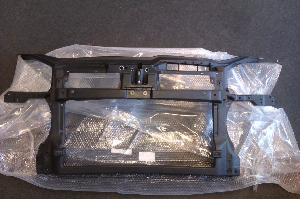

Had this turn up at the begining of the week...

Now you have got to strip the front down :)
Just waiting on the bumper to be painted and then built up then I'm good to go  :happy2:

how did you get on with this panel? i got a gti front panel but it's had a hit and been badly repaired with an epoxy of sorts. i got hold of one of these aftermarket panels to see if it would be better. it looks bang on but compared to the original panel it seems to be slightly different. upshot is that the bumper looks like it's going to not fit right. i think i could resolve by removing the bumper foam but would rather not.
did you have a similar issue?
