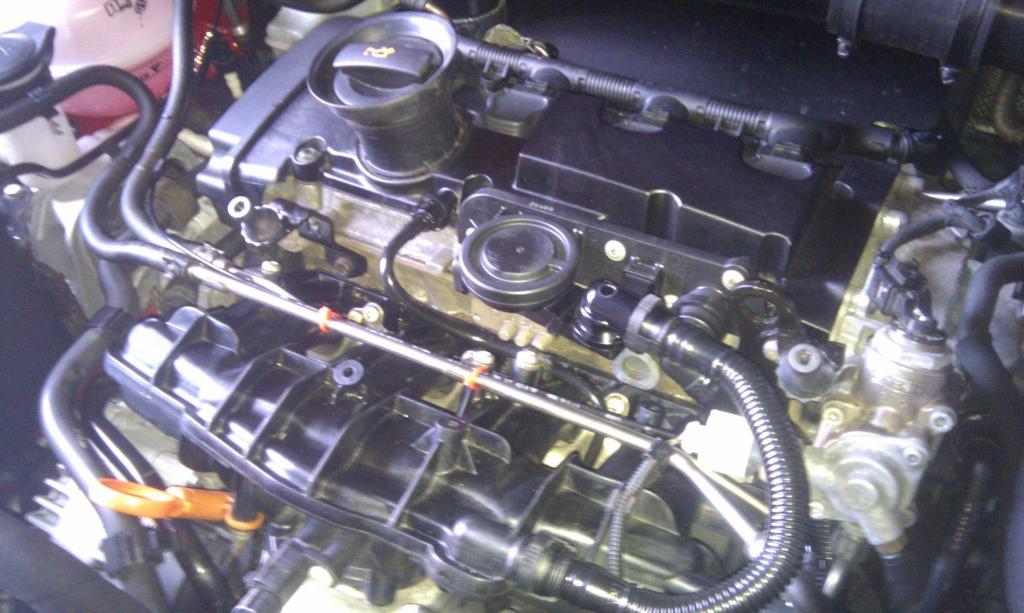

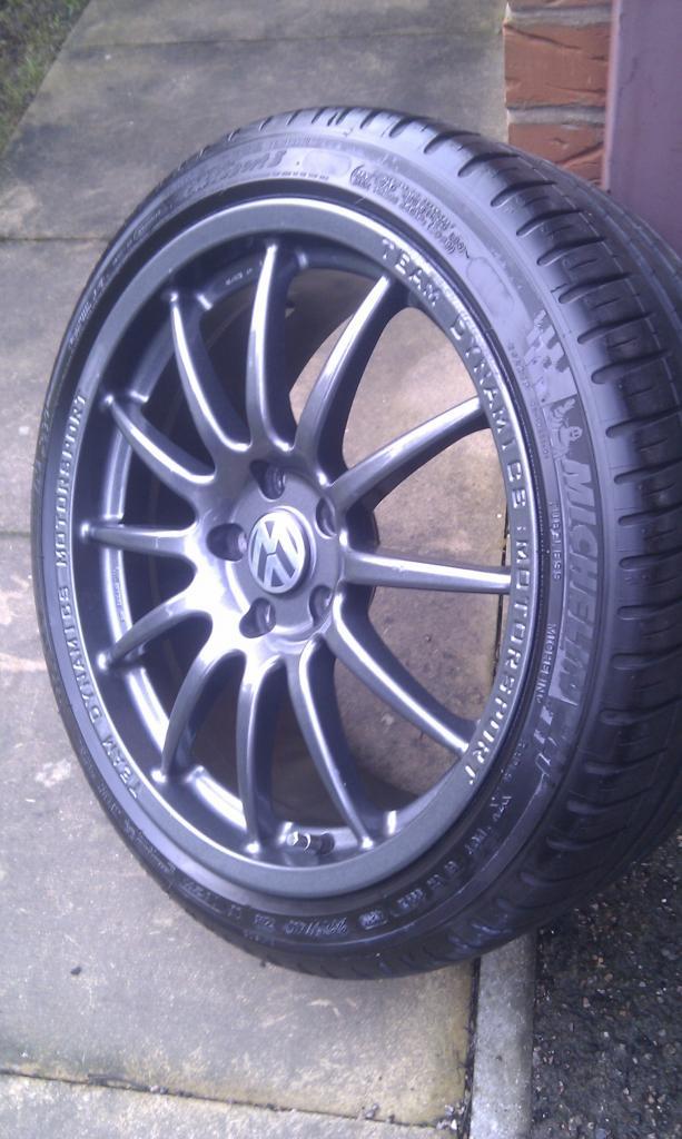

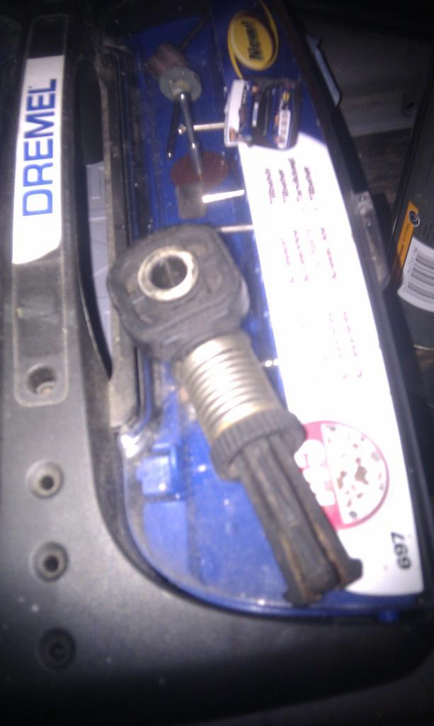

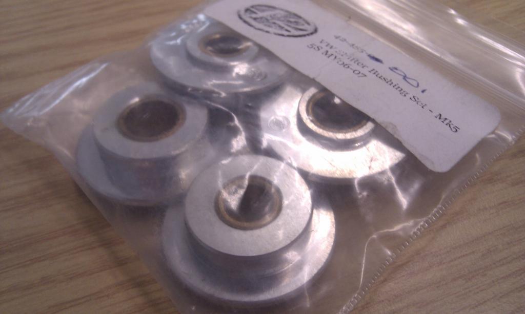

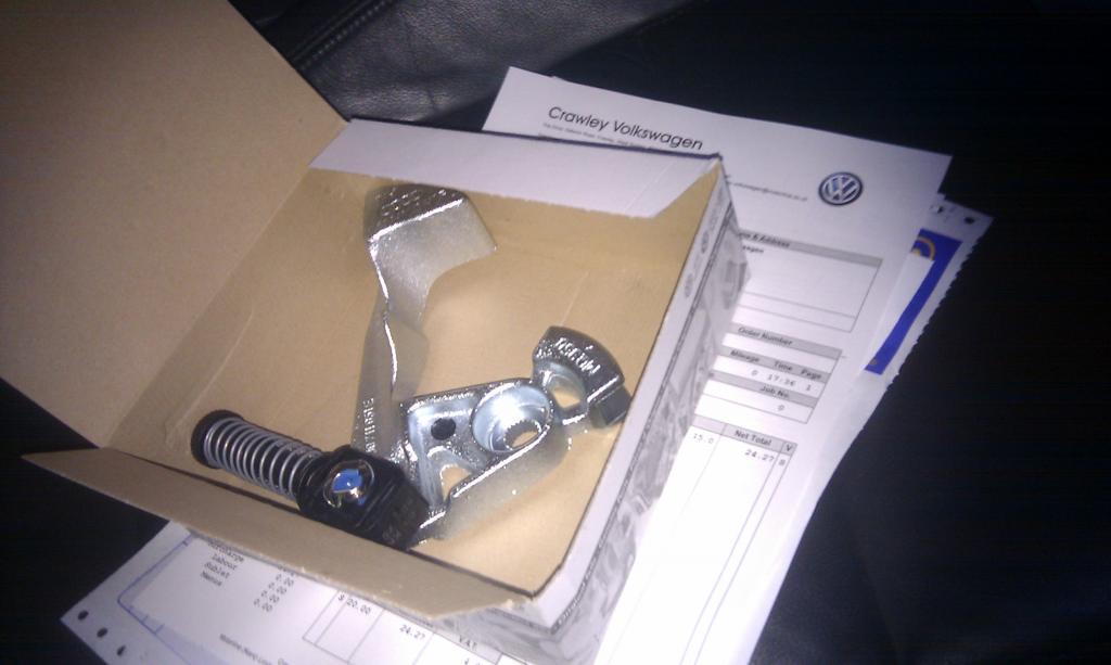

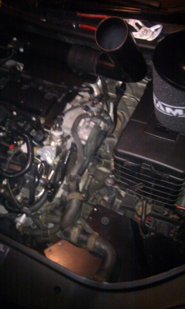

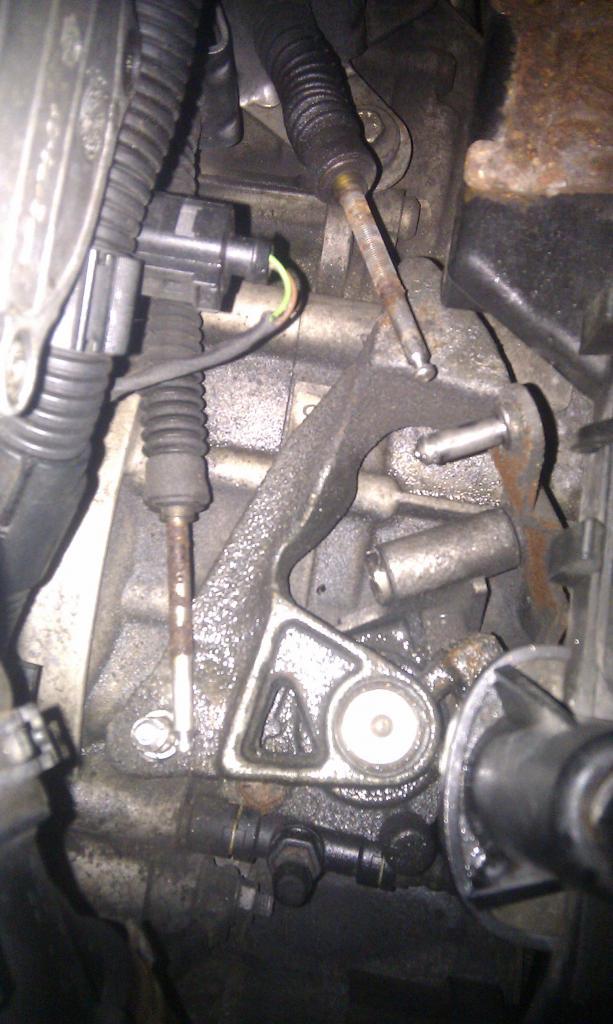

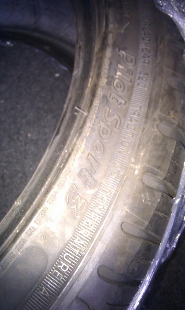

Picked up a few bits this week.
New wipers, OEM Edition 30/S3/TT short shifter and some 42 Draft bushes, plus picked up a pair of Michelin PS3s for the rear:
To fit the shifter and bushes I removed the intake:

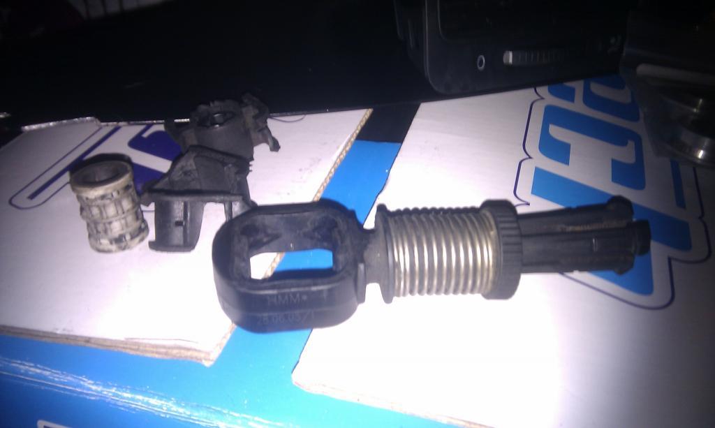

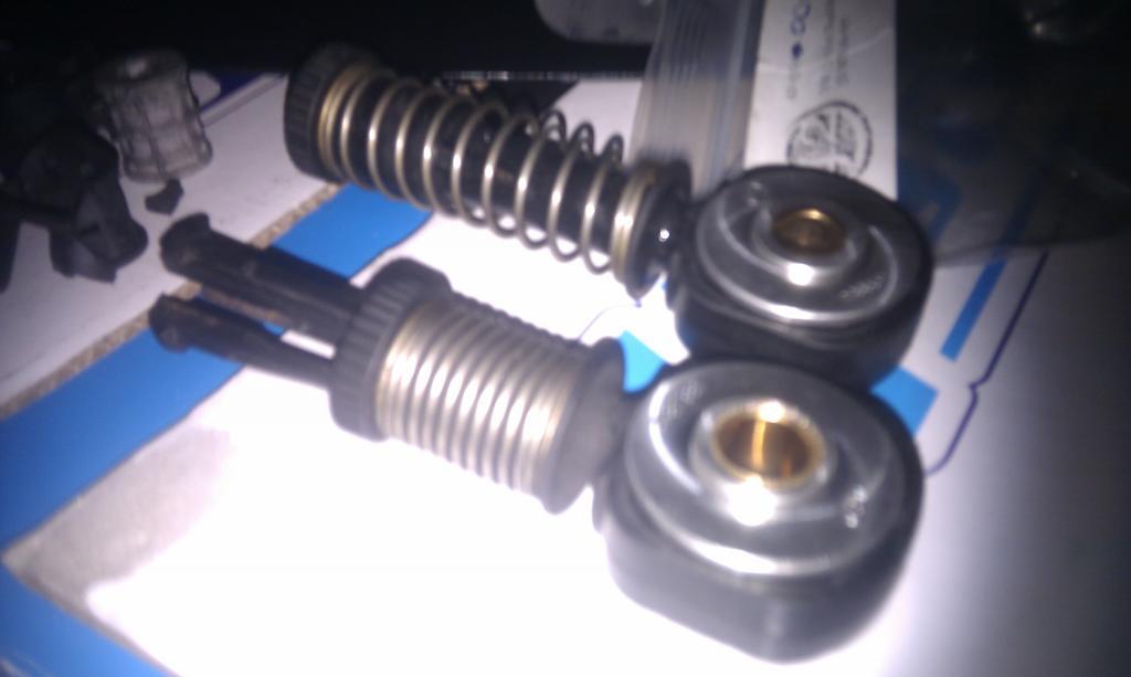

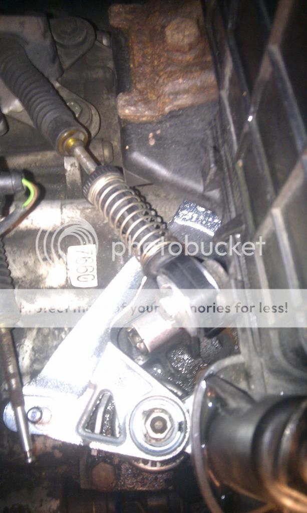

Then remove the shifter end and took out the rubbers to replace with the new solid bushes:
Remove old shifter:

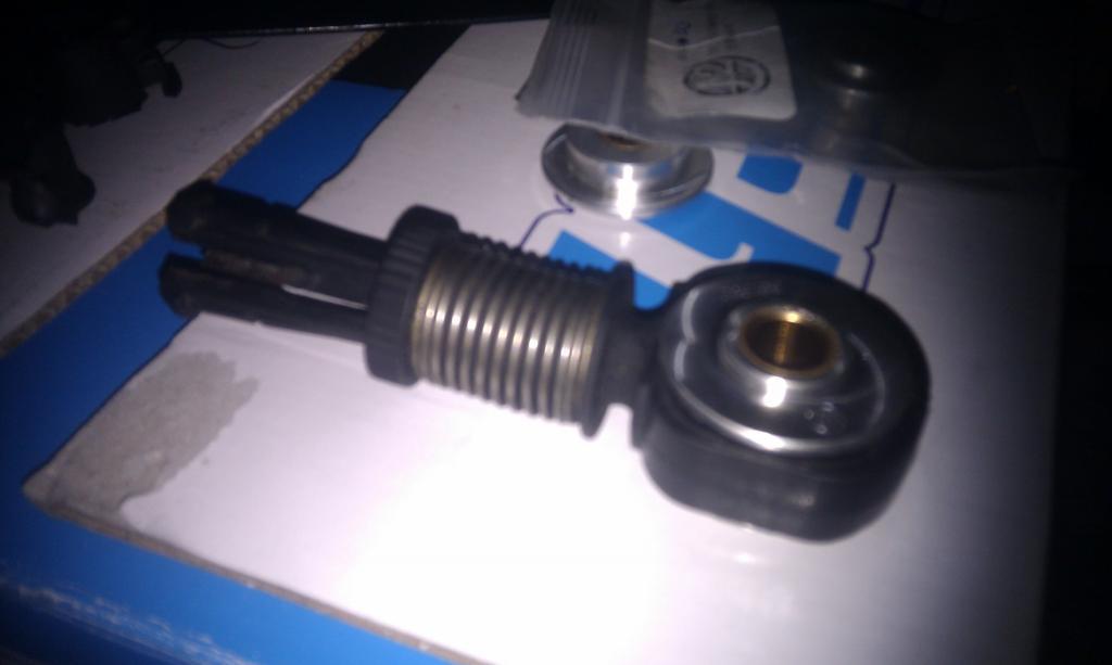

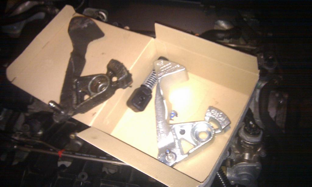

Old vs new, pin is slighty in a different location to reduce shift by about 10-12%:
All fitted:
Shift feels much better and the bushes made a nice improvement.

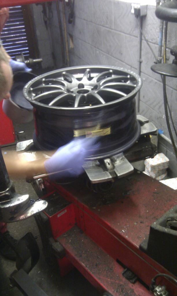

Took the car to my brother garage to get the tyres fitted:
All for now  :happy2:
Si

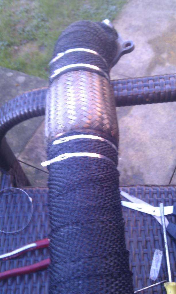

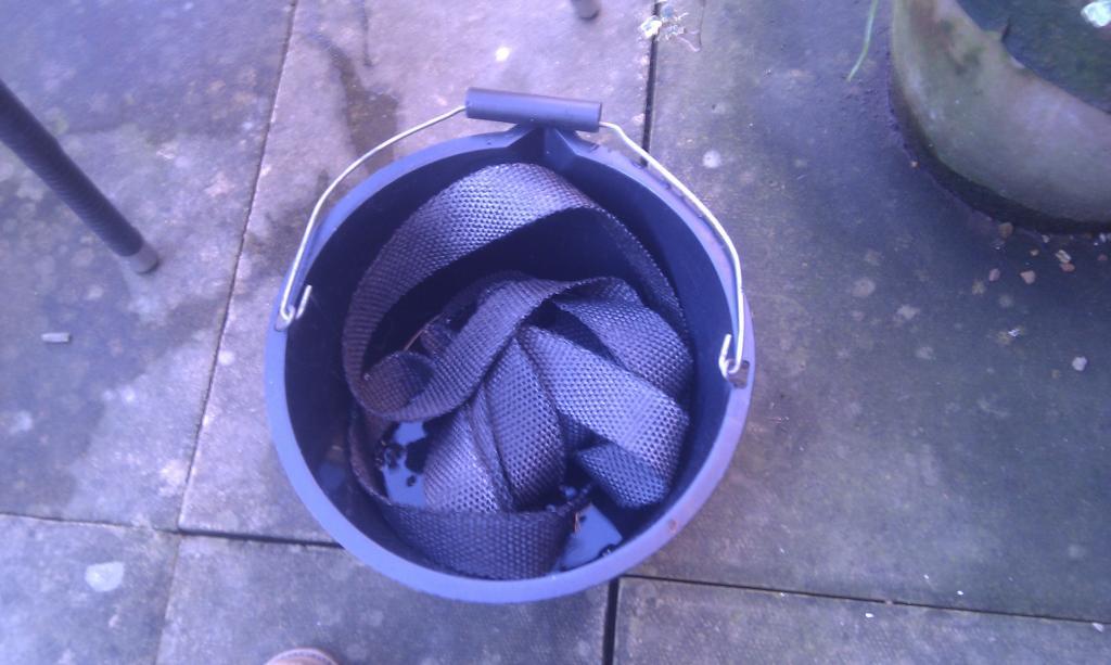

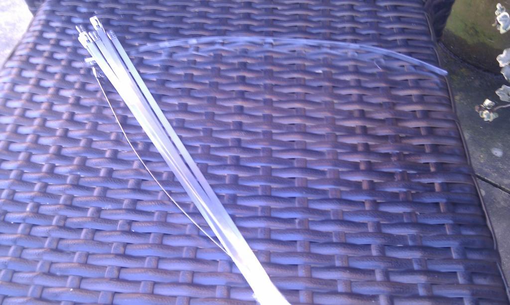

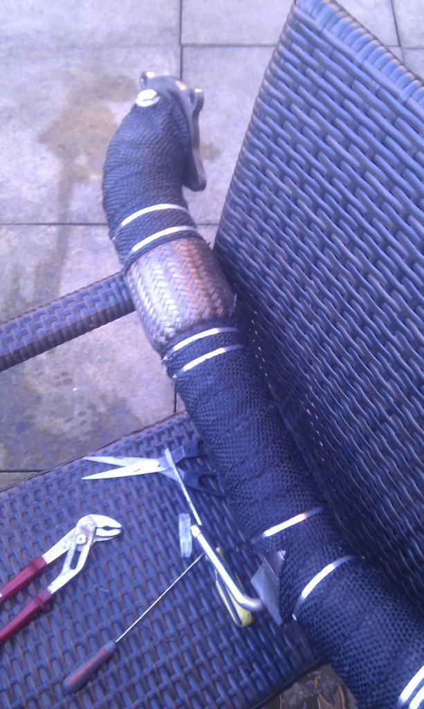

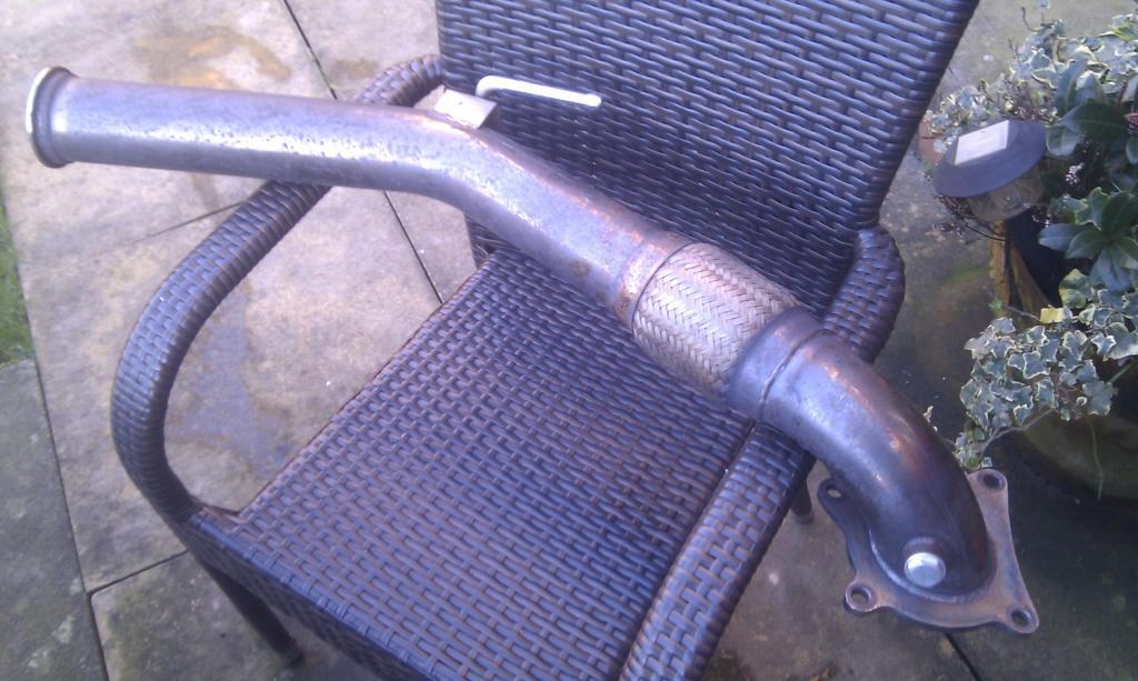

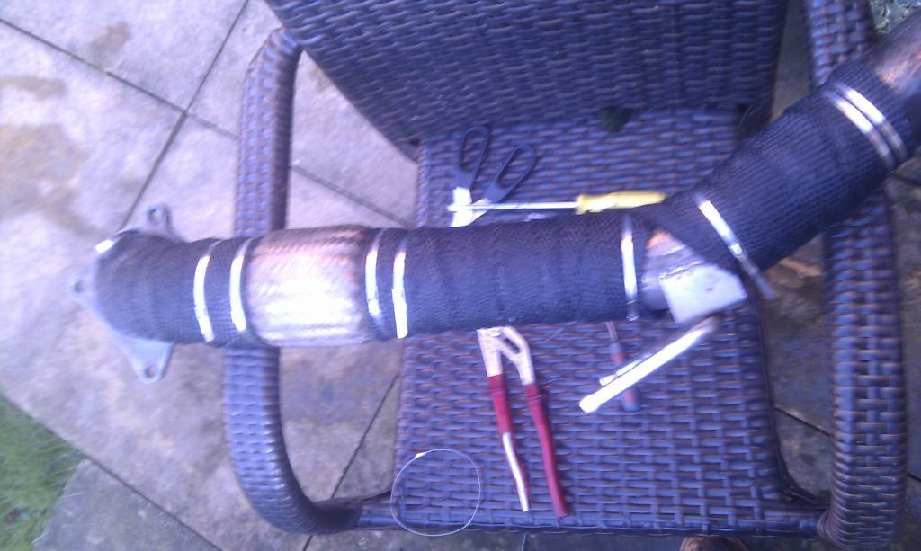

Wrapped my 3' decat downpipe at the weekend with some heat fabric:
Soaked tape in water first for tight wrap:
Stainless steel ties:
All done  :happy2::
Very pleased, hopefully be fitting in the near future.

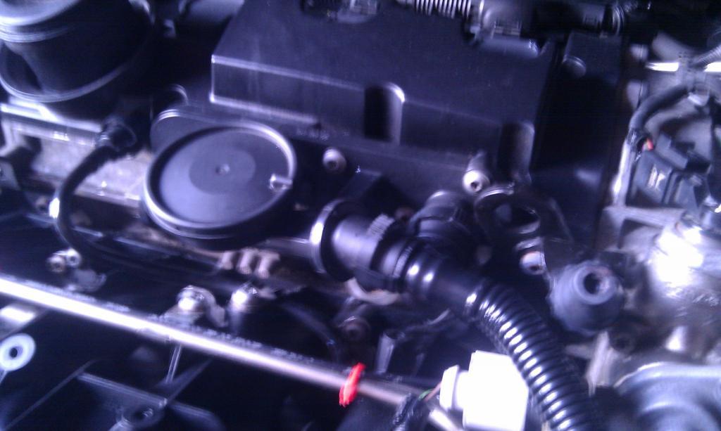

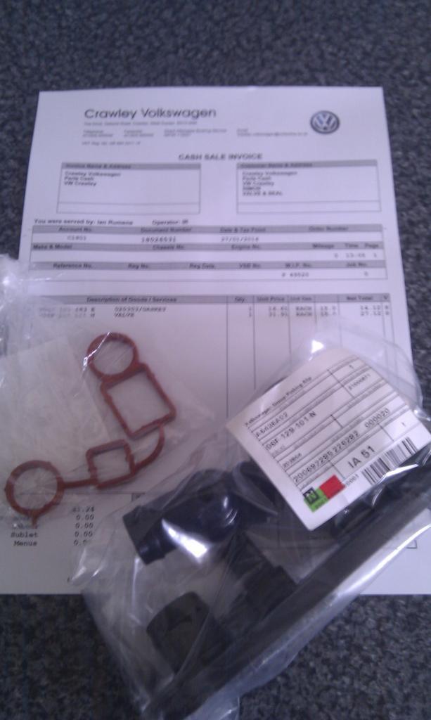

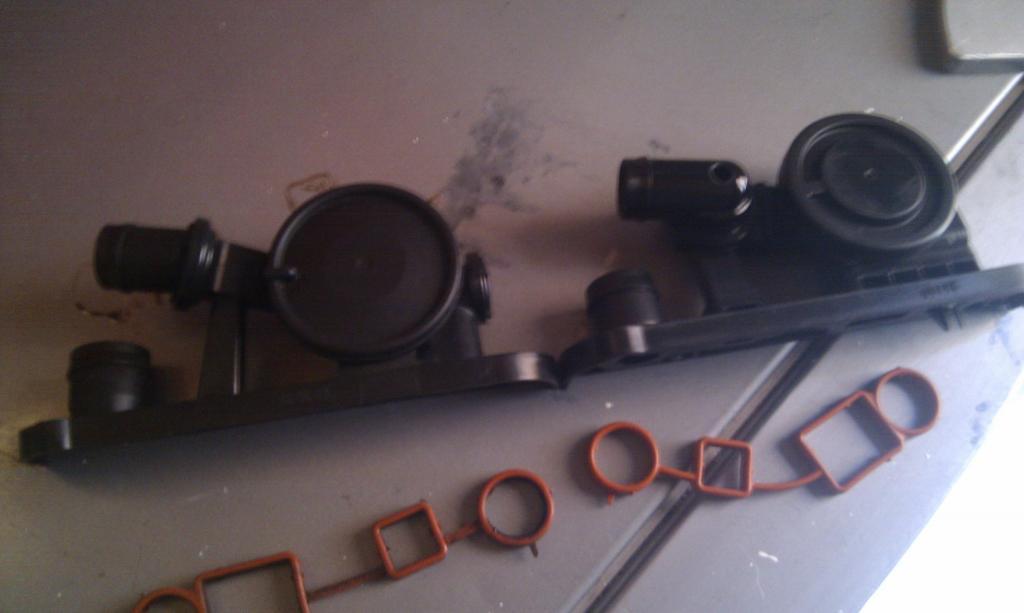

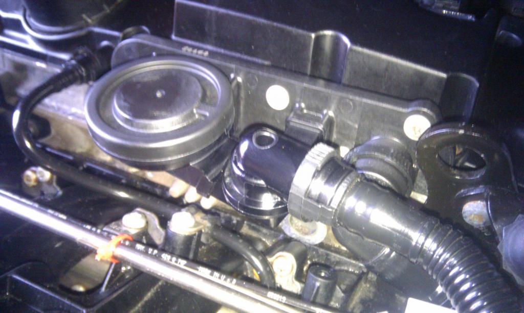

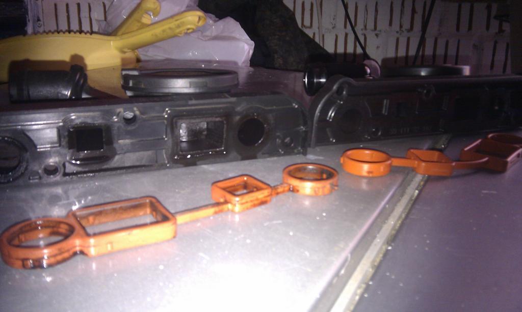

Picked up a new PCV valve this week, N revision.
Off with the engine cover and replaced old one:
Old on the left, new on the right:
All fitted:
Another maintenance job off the list  :happy2:
