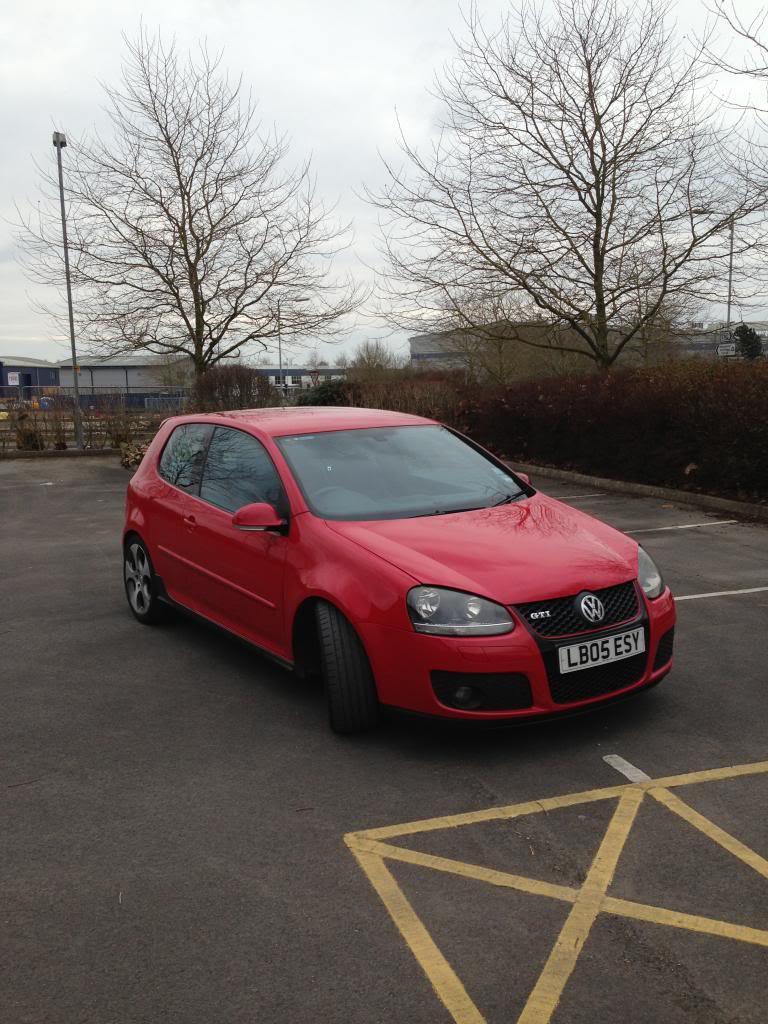

hi there everyone just brought my first golf gti and after a week of owning it i can say it will be my first of many  :drool: i love it  :smiley:
a bit of info on the car:
80000 miles 1 owner
heated leather
18"monzers
sat nav
everything else is completly standard
cople of things i want to do  :happy2:
wheel refurbishment
coilovers
miltek exhaust possibly only cat back
and maybe a couple of other things
now for some pictures
clean time

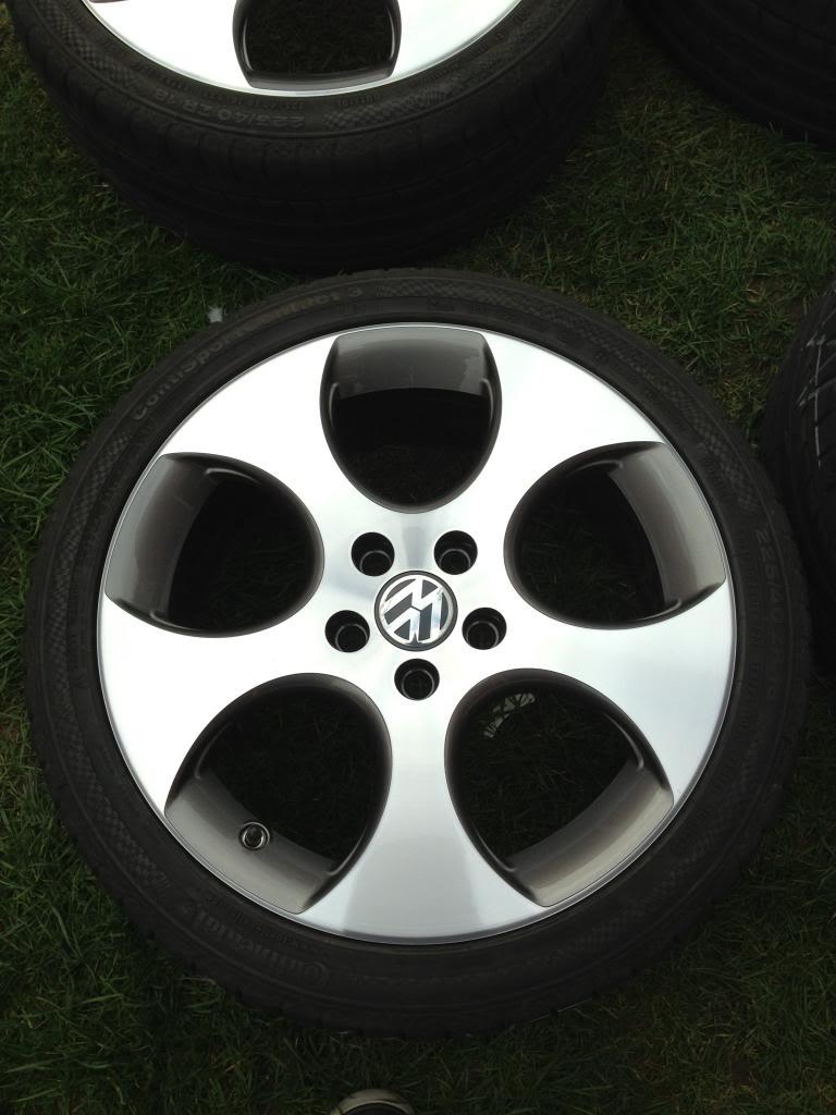

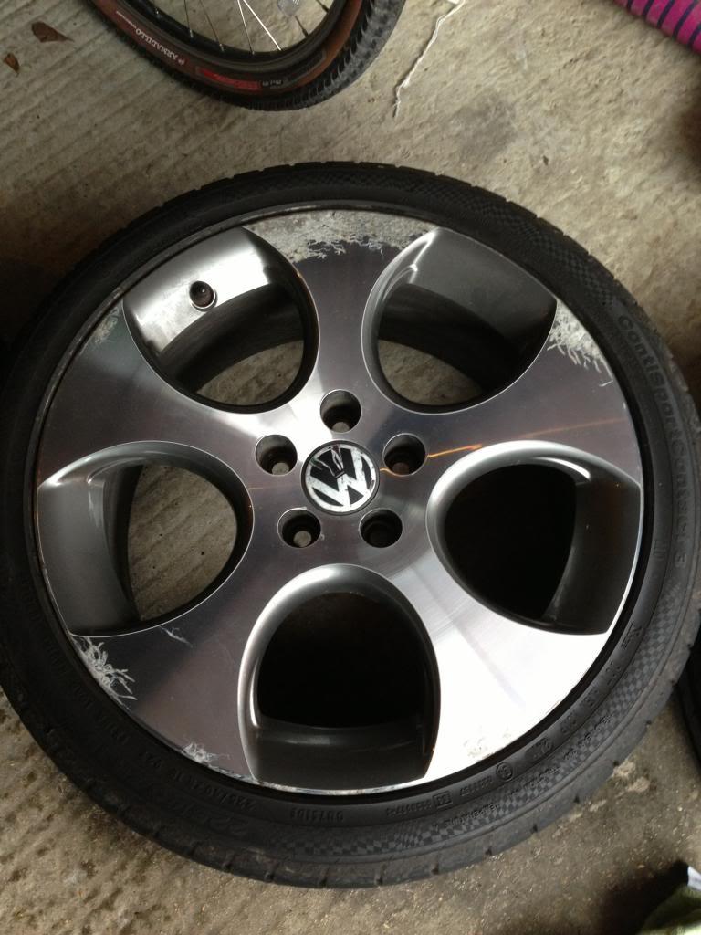

as you all know the wheels on this car were absolutly minging! so i decided to get the monzas refurbed :)
here are some pics so you get an idea of what they were like before:
and after they were done:
so chuffed with the results, had these done at platium alloys in swindon can highly recomend them :happy2:

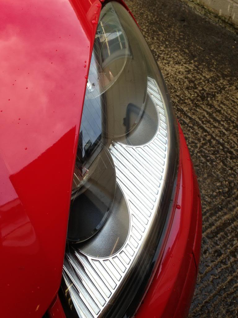

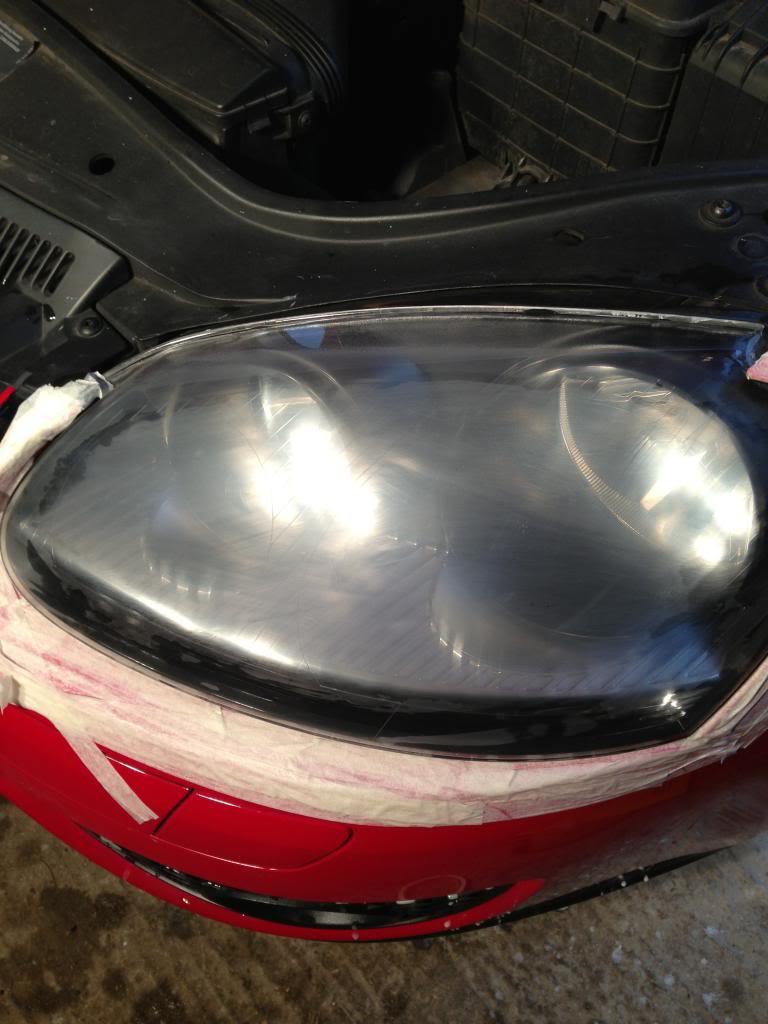

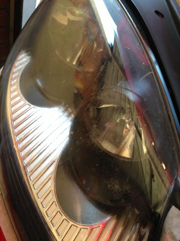

another par of the car that needed attention were the front headlights, they were very corroded scratched and starting to go a bit yellow.
as you can see from the pics:
to start with i really didnt know what to do about this problem as it was really bugging me as i like things to be mint ;) even resorted to looking at buying a new set of lights witch would cost in the region of £140!! after some searching online i found out that you could wet sand them and they come up like new so i went out and bought some sandpaper
1500 grit
2000 grit
2500 grit
3000 grit

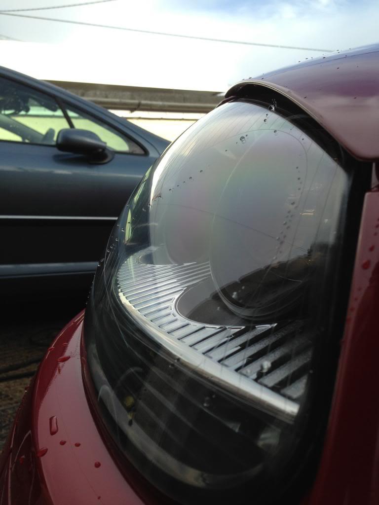

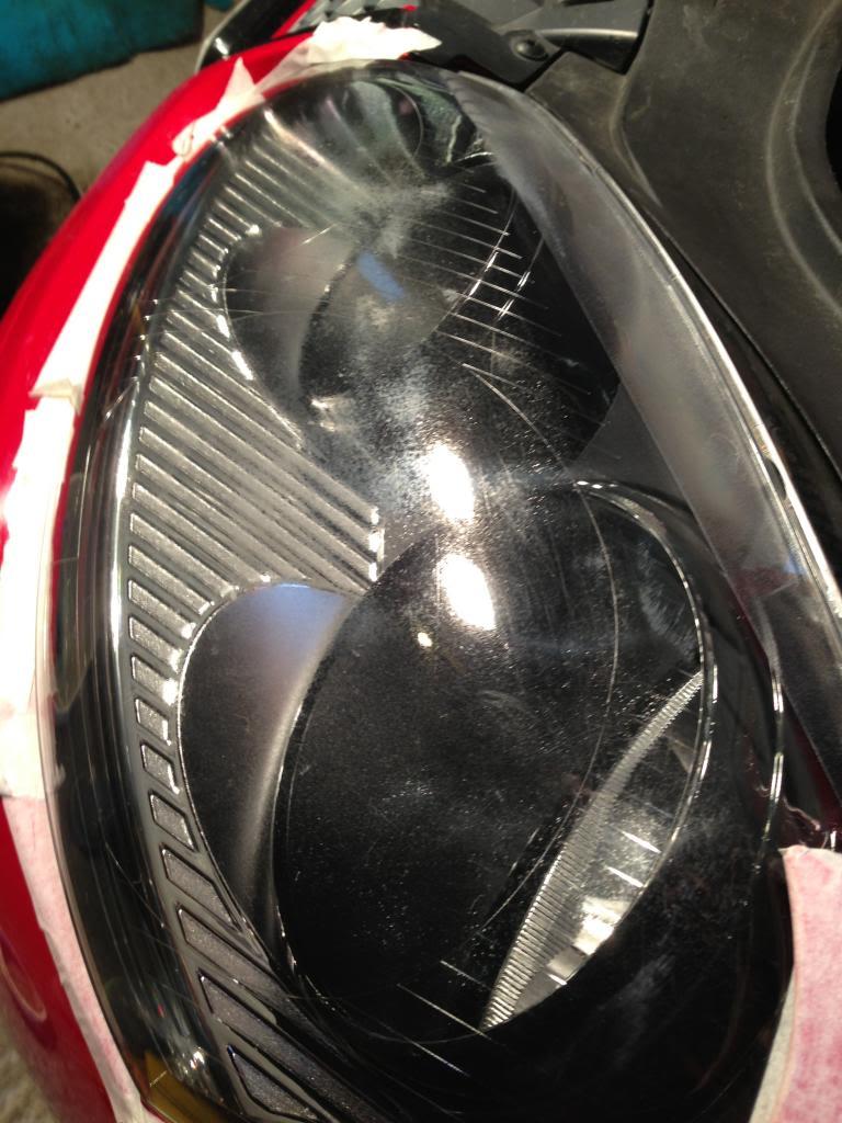

then set to work on the lights starting from the lowest and working my way through to the highest here is what it looked like during sanding:
think this picture was taken after the 2500 grit at this point i was thinking WTF have i done to my pride and joy!

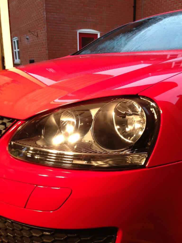

but with at bit of patience, time and some meguires ultimate compound and electric mop they came out like this
and after even more polishing and waxing
sorted  :drinking:
