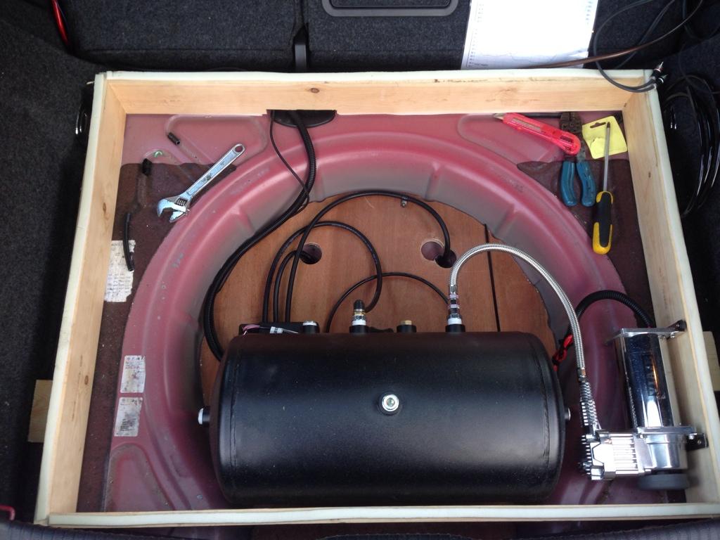

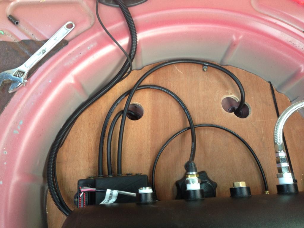

Started mounting everything in the boot.. Manifold etc
Threaded the pipes straight through the 2 grommets that are in the boot. And the rear air pipes just go through the control arms, straight into the air bags. Then the front air lines I've just followed the brake lines under the belly pan. And the fuel lines under the belly pan on the other side.. Just used tie wraps to hold it in place and put the belly pan back on to cover them up.
I routed the wires through to the center console where the power socket it and the controller sits in there, the wire is long enough to reach outside the car for playing about haha :D
Ill finish up later. More to come xD

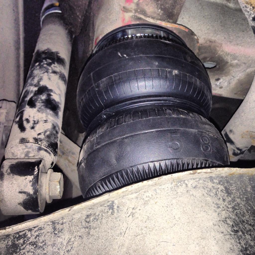

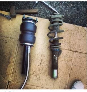

Rear bags where really easy to fit. Just had to cut the included bracket down if your using after market shocks like I am. I just ended up using a jig saw with HSS blade.
Then you have to drill the hole at the top of the spring holder bigger and put a "nut sert" in there then hand tighten the bag onto it. Pretty simple.

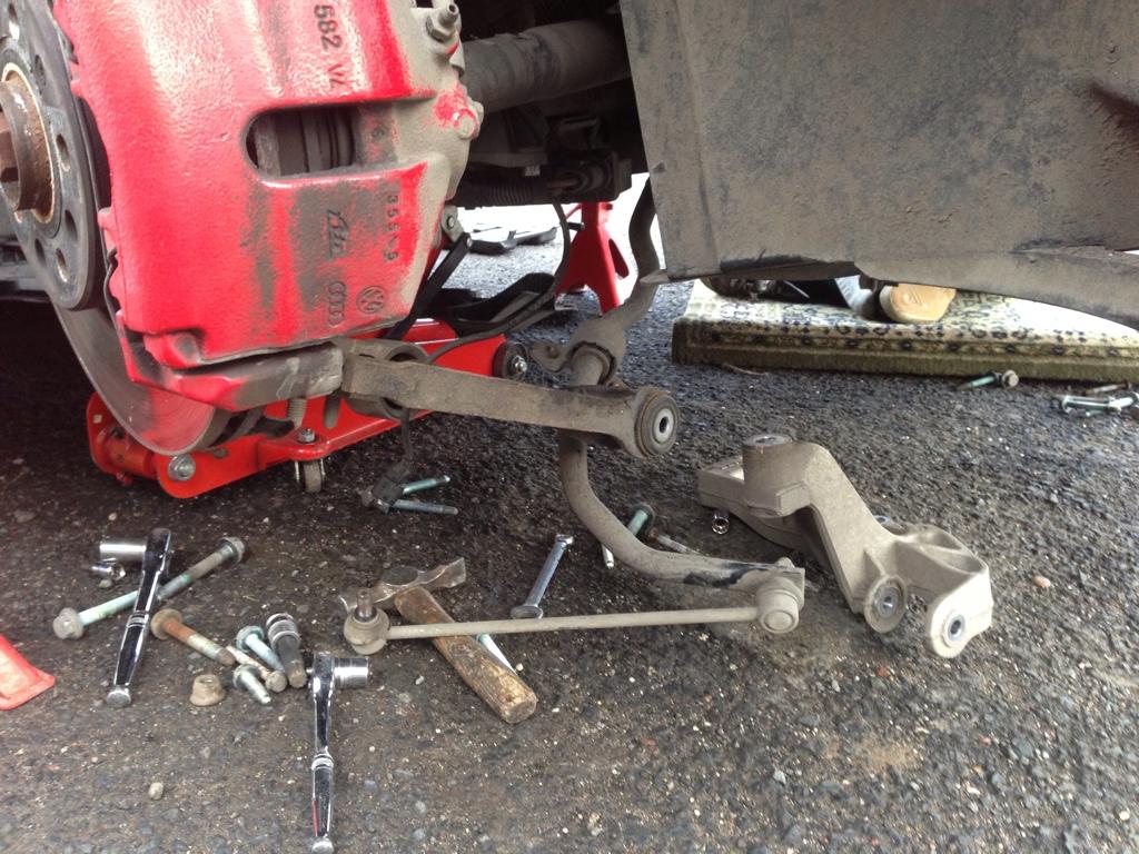

The hardest part of doing to job was taking out the anti roll bar! What a b*****d. Had to take all the sun frame off. And in the end ended up cutting one of the drop links to get it out. Because all the subframe had been removed I had to get 4 wheel alignment after..
Here's comparison to a Ap coilovers and new slam air bag:

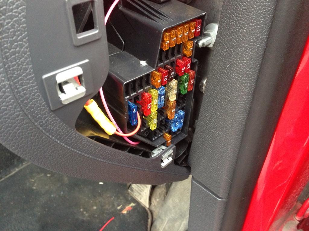

Wired the ignition into the fuse box. Used a volt meter to check which fuse stayed live whilst cranking the engine.

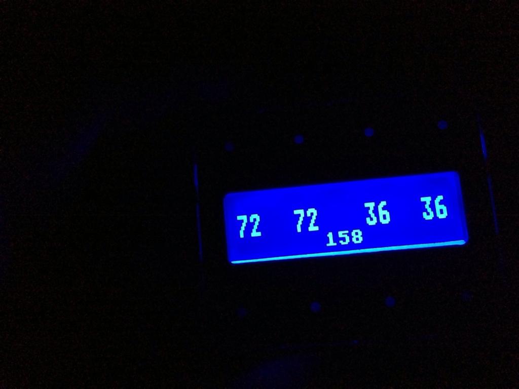

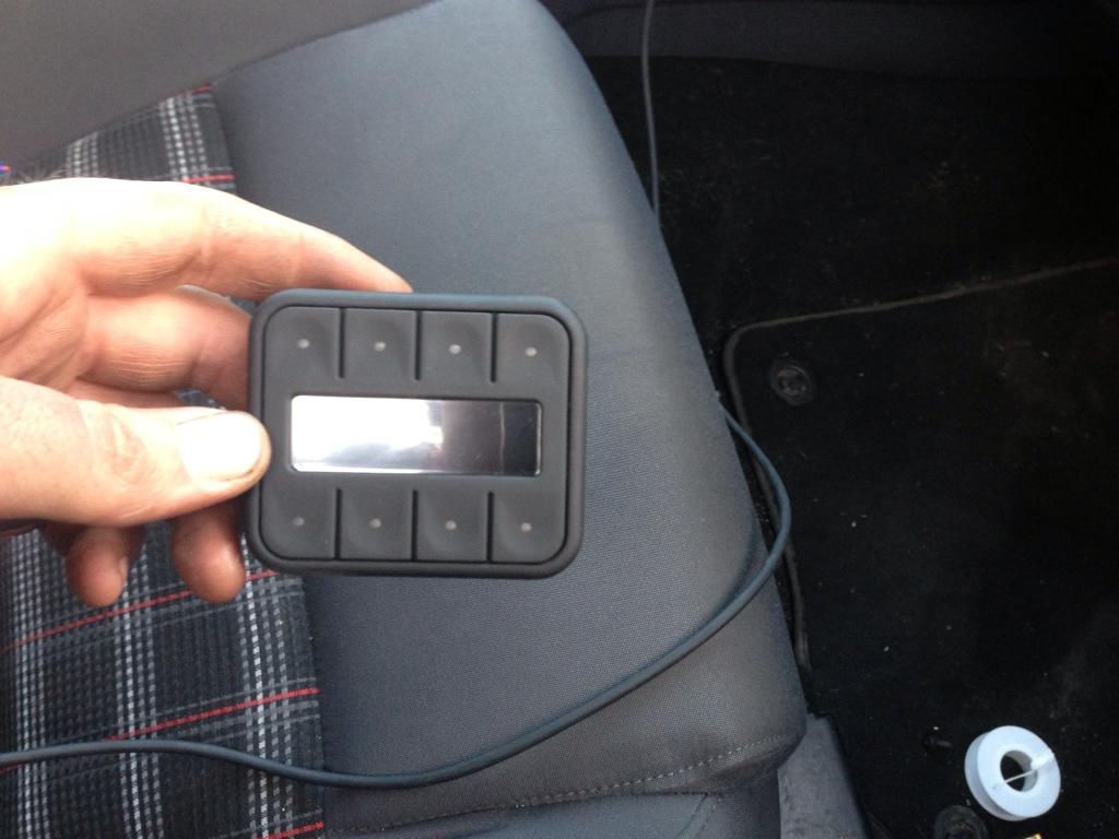

Here's the controller turned on:

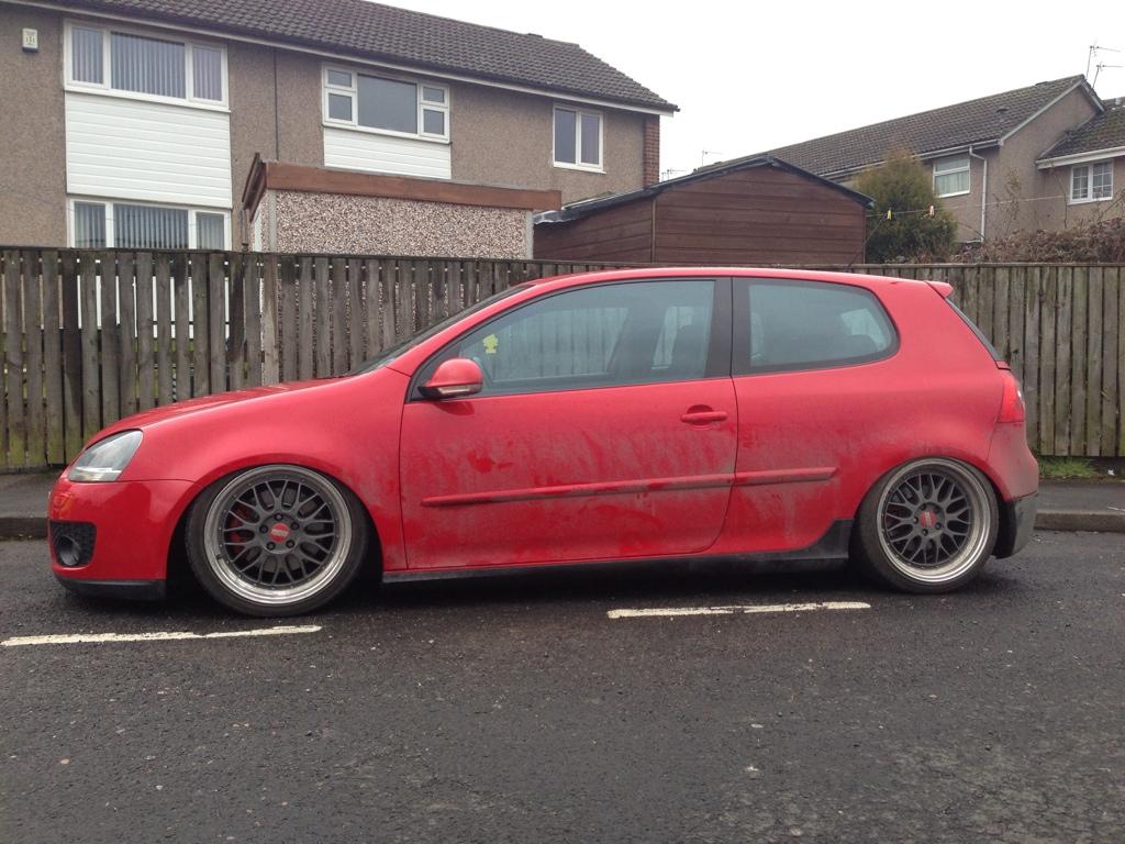

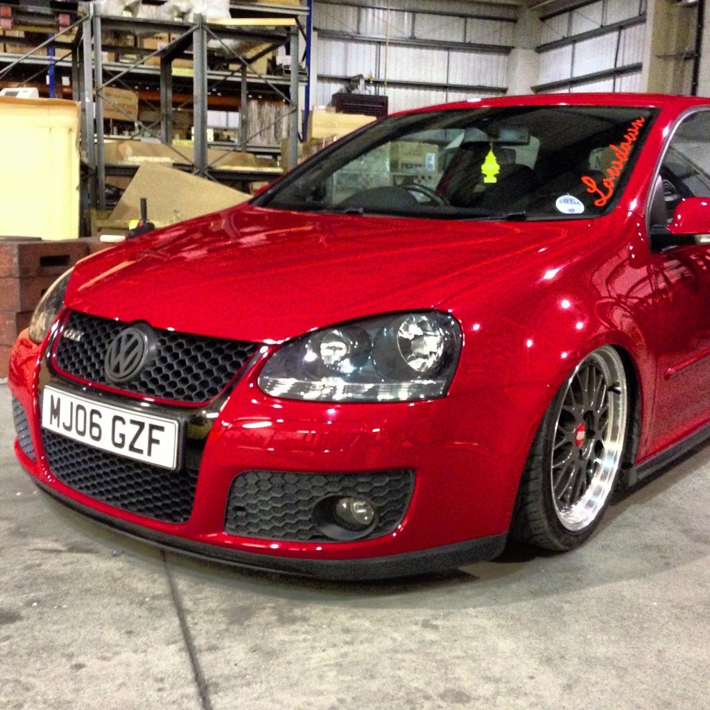

And some slammed pics... Car is filthy here though:

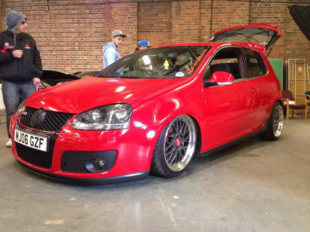

Some mint clean photos at elsecar mega meet.. I need to get the chassis notched tho because it will only go this low on the front.. Could go about inch and half more:

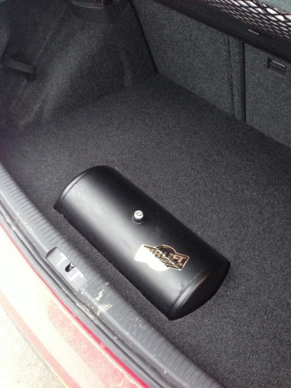

And the competed boot build.. (For now) carpeted.
