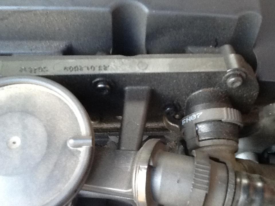

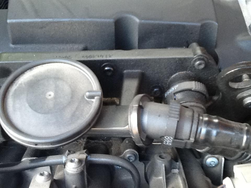

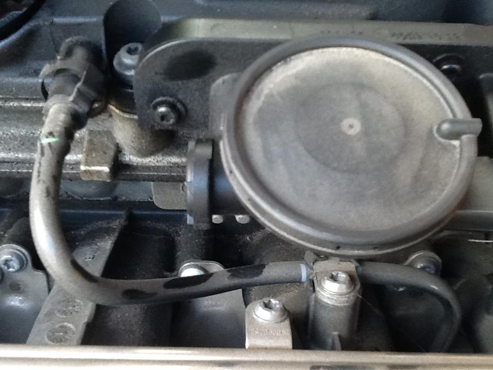

My car has been very sluggish at low revs over the past week or so. When high up in the revs, it still feels quick but at low revs it feels breathless and as if something is holding back the power. I've checked the dv and its the revision g with no tears and the pcv is working as it should (engine sounds rough and chucks when oil cap removed). Looking around the pcv valve their is a small amount of oil over the surrounding area but I don't know if this is considered normal or not so have put some pics up below. Anybody got any ideas what else it could be?

Also, has anybody got any comment on the oil around the pcv? Not anything to worry about?
Nothing unusual fella :happy2:
