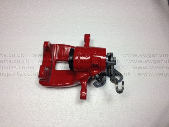

Grabbed some MK6 calipers from eBay recently as my rears have been in desperate need of a swap. (bind on everynight)
I'm not so sure these are MK6 calipers, as I was under the impression they were lighter, as you can see from the image below, these are MUCH heavier, and also the spring attachment is different... if I offer up the other caliper then the brake fluid hole is at the top:
They were advertsied as MK6 rear calipers, to fit MK5, amongst others...
What do you guys think?

Just looked on Genuine VW parts, and you can see (abelit the caliper is the other way around) that the shape of the face is the same as the MK5 caliper above... not square. :confused:

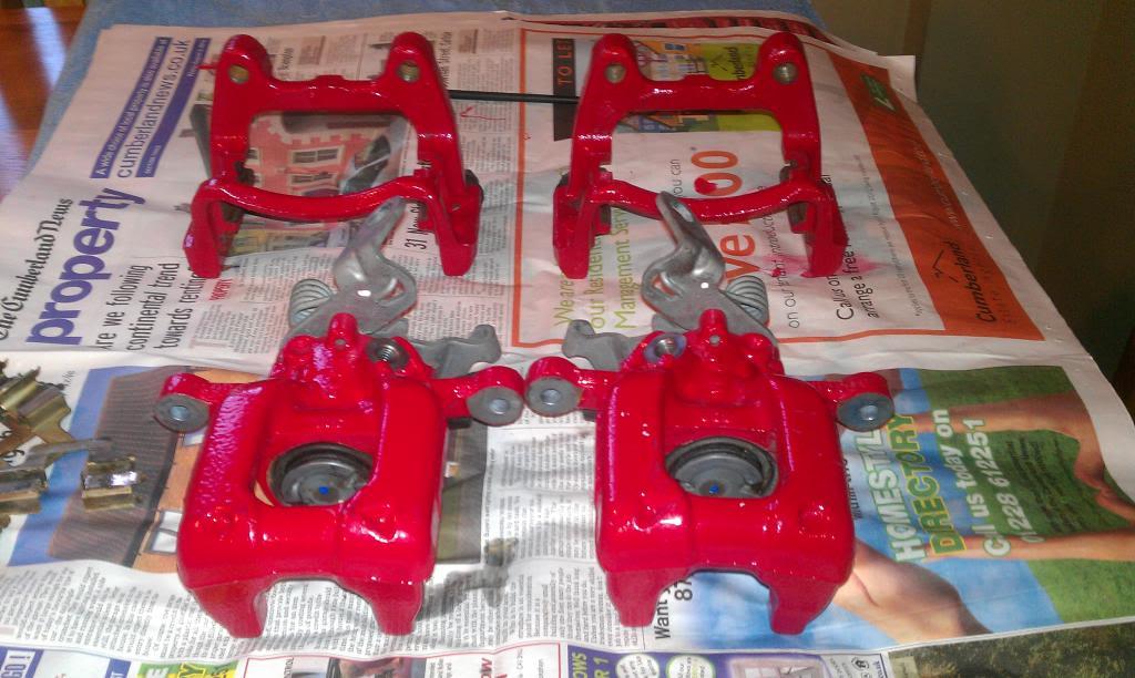

Those are exactly the same as the ones i have - here.......
Sorry cant find the photo I had of the brake line you need and don't know the part No but the pair were only about £8 from VW. They work absolutely fine with the standard Mk5 discs and pads and there's no isued fitting the handbrake either.

Actually mate, your carriers are different, mine have a straight edge and not the kidney shape of yours (yours are like the mk5), the caliper is the same as mine though :rolleye: weird this, lol.

The weight thing will be minimal you'll never notice, it's not even a kilo, they did however improve my braking loads.

By the looks of it your using MK5 carriers (or early MK6) and late (Bosch 2010+) MK6 calipers; it's funny how VW mash these things together... in some respects it will save me having to remove the old carriers (spline bolts) if they bolt straight on. :smiley:
