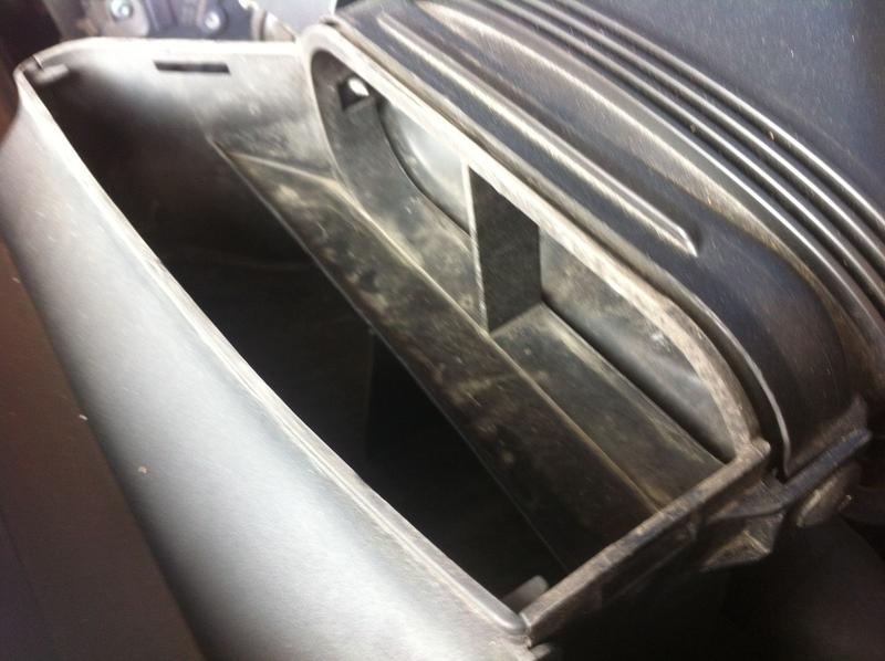

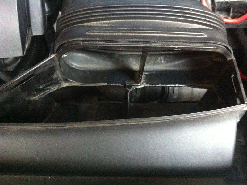

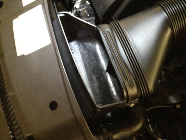

Andy, agree with bacillus.
To minimize that small loss of power even more I'd recommend to remove the lip inside the small box behind the grill.
Remove the cover/cap and you'll see what I mean.
there:
this lip:
removed:
smoothened:
Before this most of the air went into the engine bay.
BTW, I'd go for an OE paper filter.
