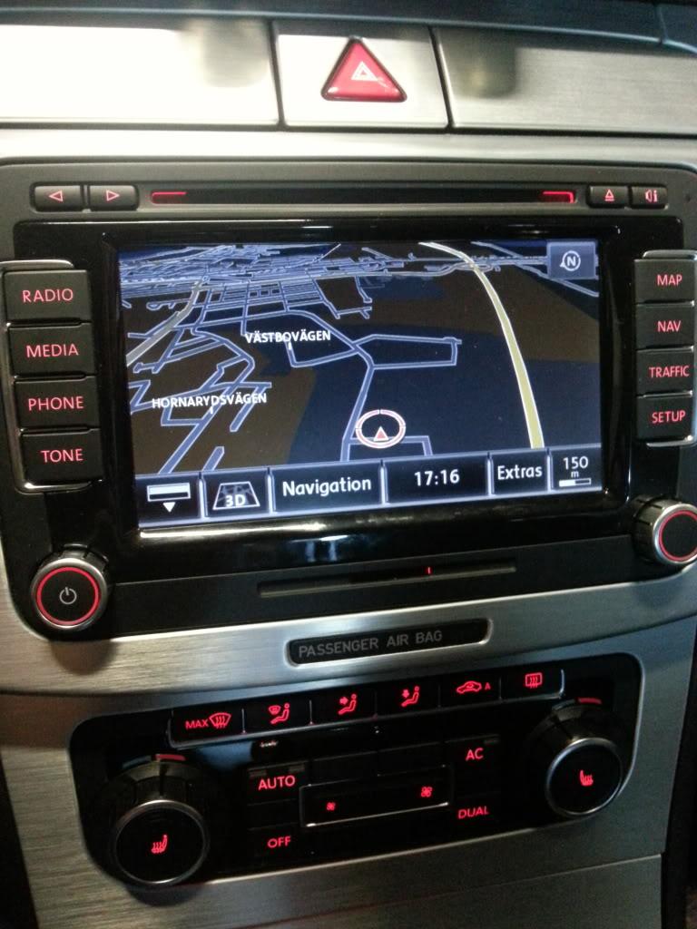

i see...
is there any chance i can see unit version i have? coz all i can see when i hold settings button is this
is there way i can see maps version that are installed atm?
this is how my unit looks like

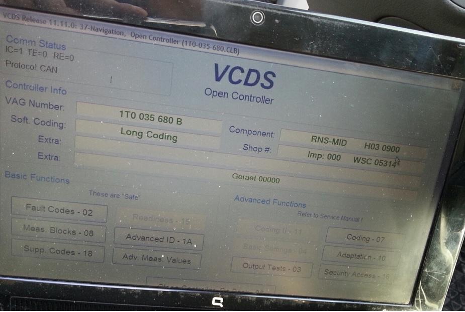

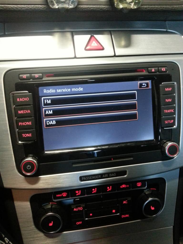

« Reply #12 on: March 18, 2013, 02:28:14 pm »
ok guys Ive been at local servis and I did check up on my device. I took this pic and this is all info I could get from the dude.
It stands device unit but not sure if there is software version.
Whic SW do you recomend I should Install, that works properly with v9 7918 without problems on the sound, batery drain etc???

« Reply #13 on: March 18, 2013, 04:06:25 pm »
You can go up to firmware 3810, without any issues on your H/W
1T0 035 680 B from software version 1000, 800,  900, 1100 , 2660 and 2700 to version 3810  :happy2:
Where you based? as someone local may have the firmware on Disc you could borrow

« Reply #14 on: March 18, 2013, 04:10:01 pm »
The new features are :-
Voice Control (requires microphone – see Volkswagen RNS 510 Microphone Connection for voice control)
NEW hold down the setup button for 30 seconds and get the following menus: FM, AM and the new VERSION INFO (map version and type, hw and sw versions)
