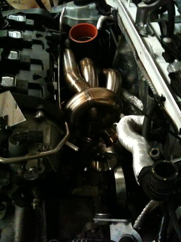

Hi Jonny,
Regarding the manifold - from that angle it looks like it could obstruct the intake system?!?? :confused:
Is there space there to get it past?

Hi Jonny,
nah the turbo will hang quite a bit further down...the compressor housing needs to clear that (and it will) so the intake tube/hose shouldn't be a problem as its smaller!

Hi Jonny,
Loads of room, enough to have a 3.5" intake system, which is what im planning for in the future..

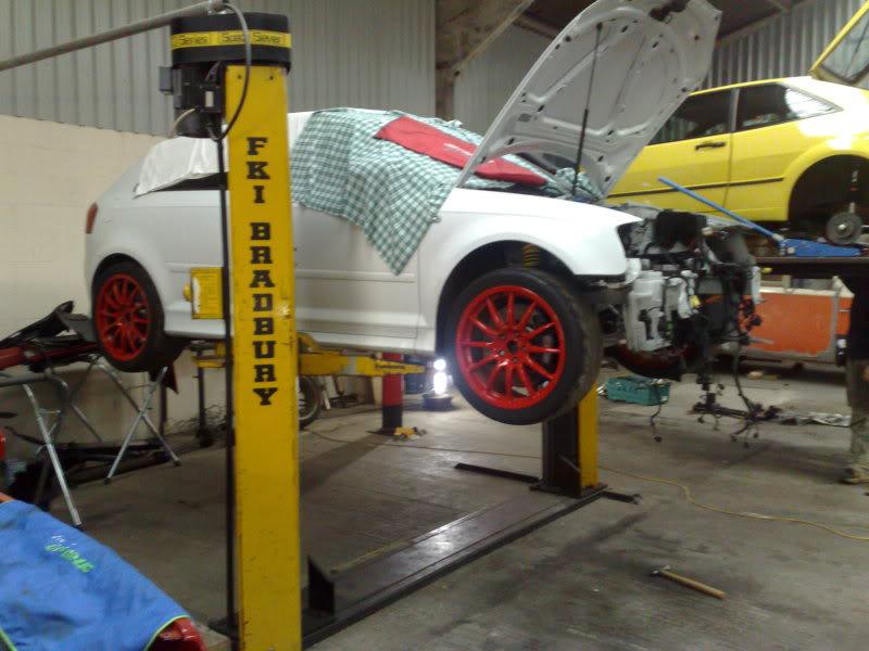

Ok so all of the parts are FINALLY with me! And we have managed to get the car back on its wheels.. Its really nice to see it coming along so well! This really does feel like the final stretch now..

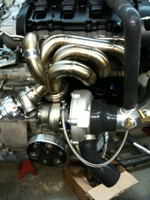

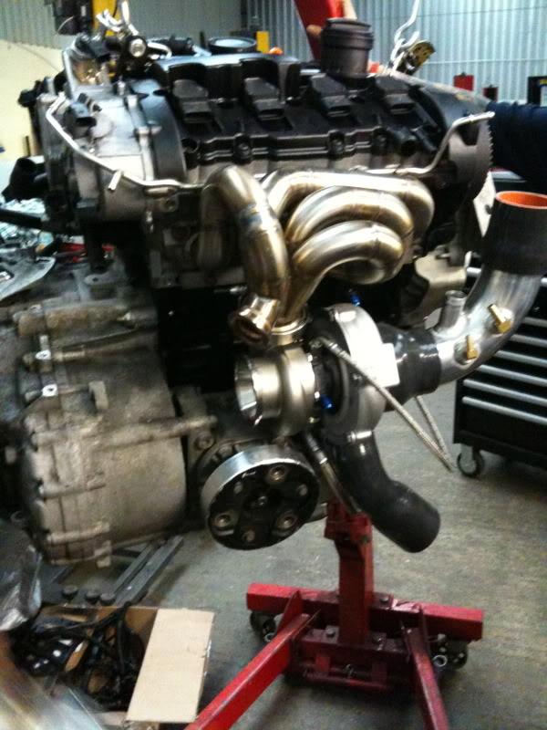

Ok so first of all a few more bits from the states arrived..
GT3076R turbo with anti-surge .60 AR compressor cover and Tial V-band SS .63 exhaust housing..
The beauty of this turbo is that I can make only a few changes to it and it will be able to flow a huge amount more, that should get me to my goal of 600hp running moderate boost which is the aim..
Of course it would make sense to try some of the bits first time round but I need to start somewhere. We need to baseline the car and understand what can be improved on before we start improving if that makes sense!!
Rather nice looking turbo and manifold!!

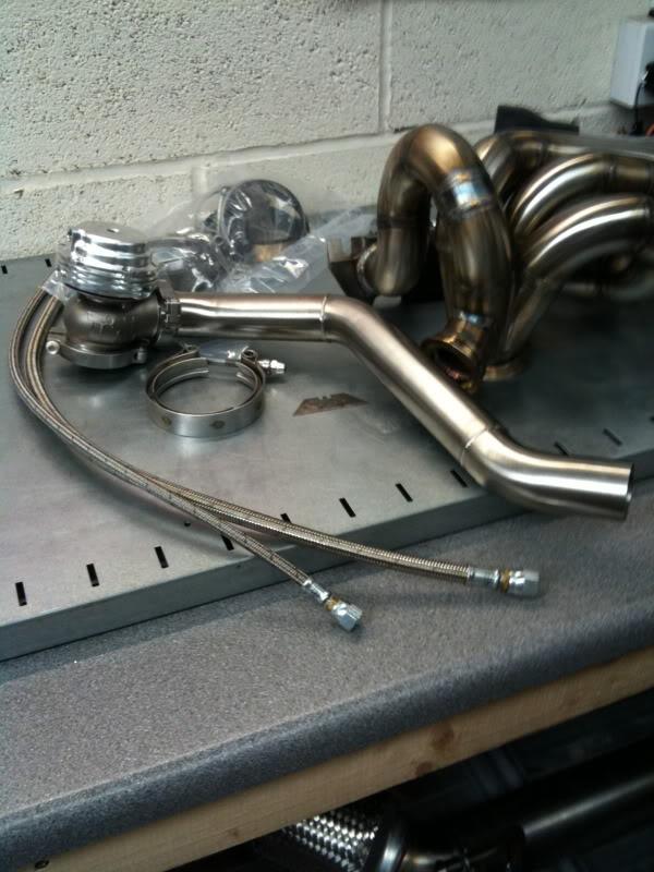

Tial 38m MVS wastegate and dump tube

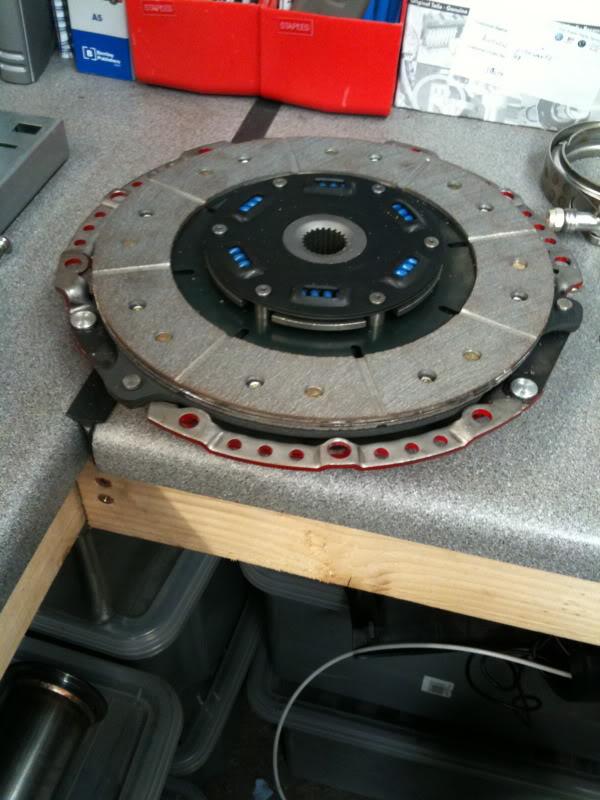

Southbend Stage 5 Clutch

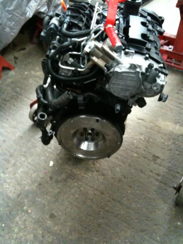

And flywheel fitted to the motor

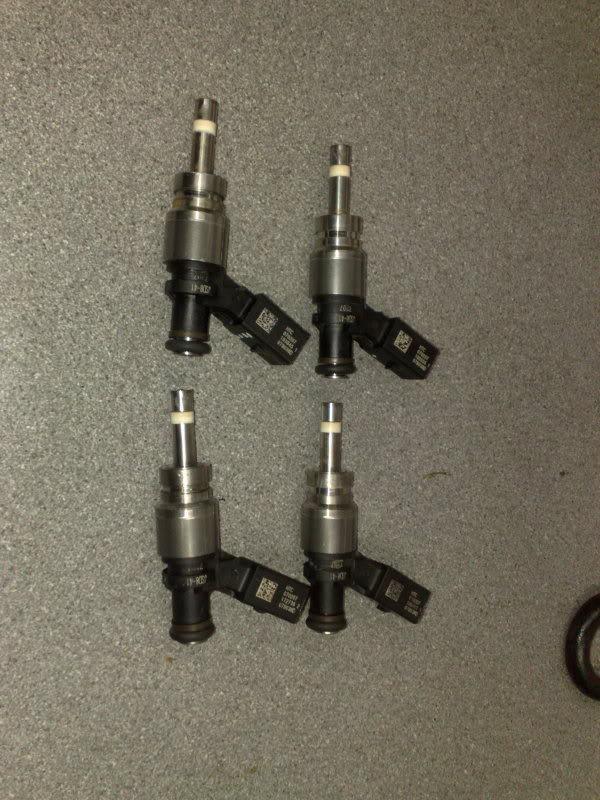

Injectors back from ADS all cleaned up

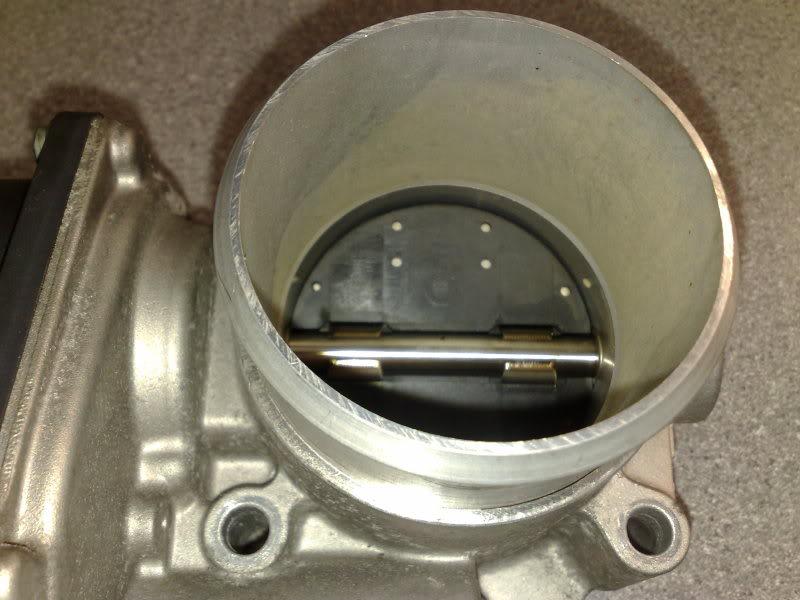

Nice cleaned up throttle body, this was full of oil..

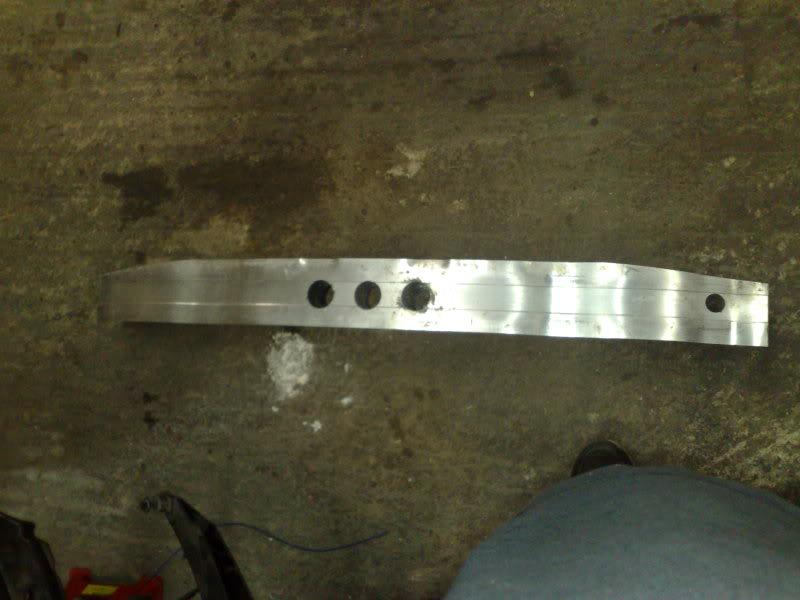

Crash bar lightening! Work in progress..
A/C compressor removed and the A/C compressor / Alternator bracket cut down, saved 1.2KG on the bracket alone! Compressor is a further 8kg! Add in all of the pipe work, radiator and gubbins and it comes close to 20kg saved from the full A/C removal..

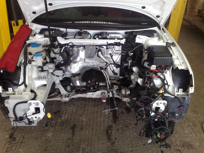

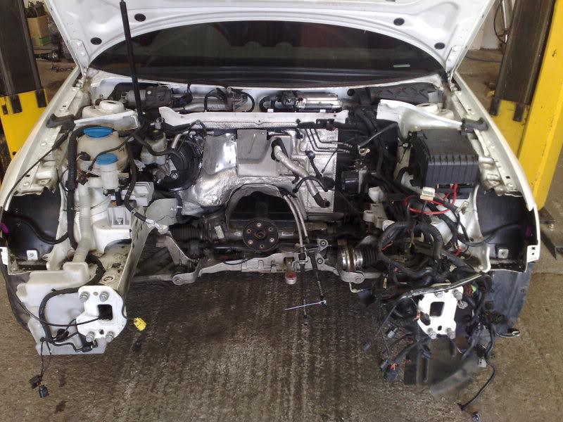

So now it was time to clean out the engine bay and get the car back on its wheels!
Engine bay before..
And after..

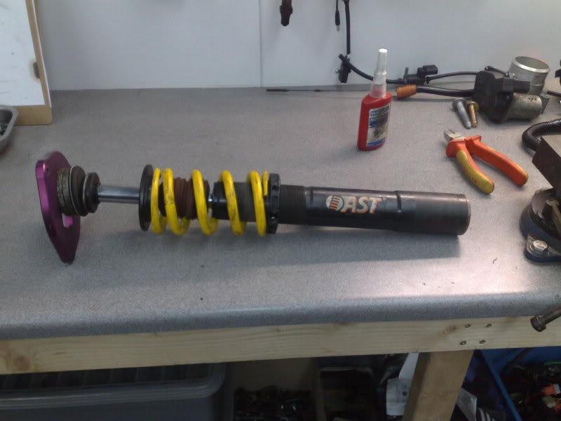

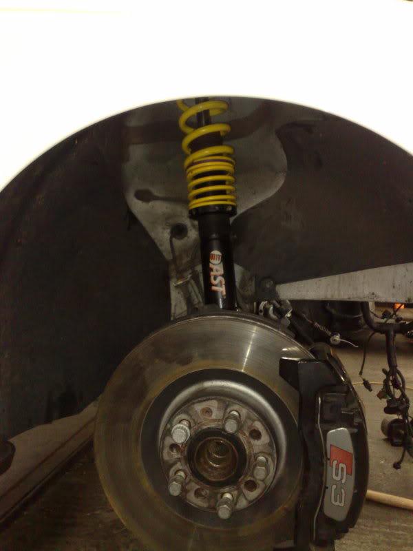

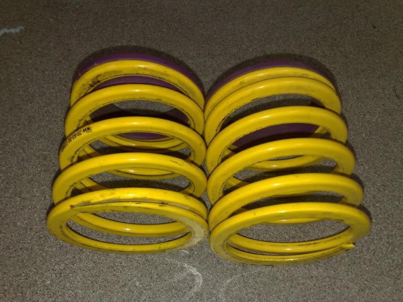

Also a big thanks to Matt at VWR for supplying me with a set of helpers for the dampers, with the short motorsport springs it was becoming a problem..
Dampers before.. (problem is pretty easy to spot here)

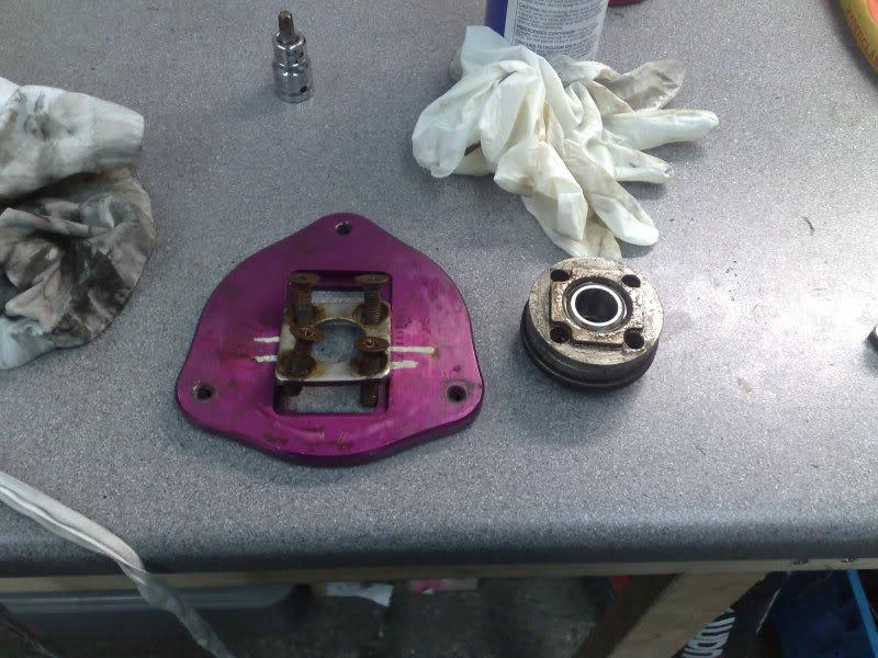

Top mounts, quite a bit of corrosion on these but all cleaned up now!
And all built back up!
Starting to look like a car again now!!
Pretty low!! Haha..

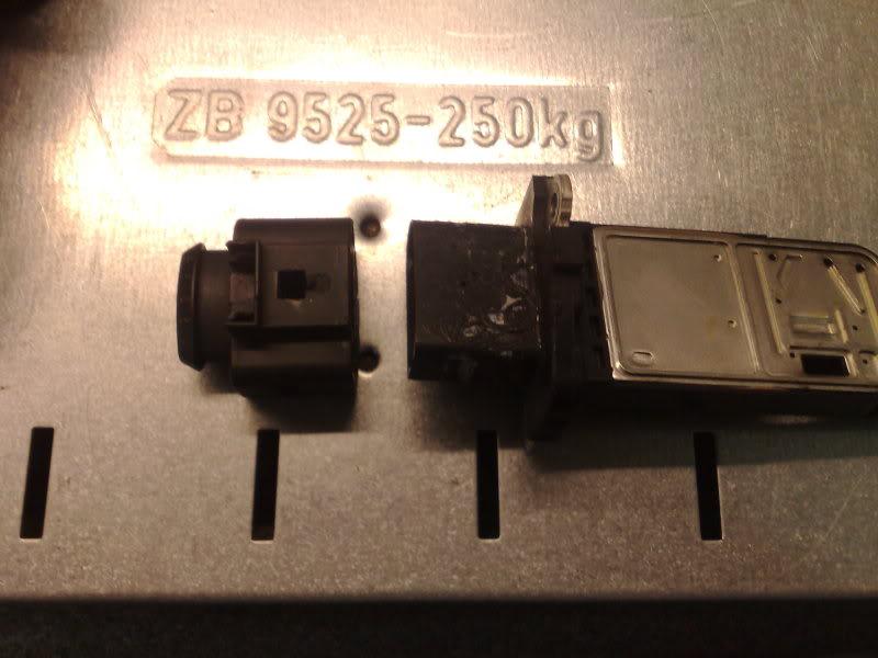

Connector glued onto the MAF after the clip being broken, nice! 8 broken connecters found in total, pure lazyness!

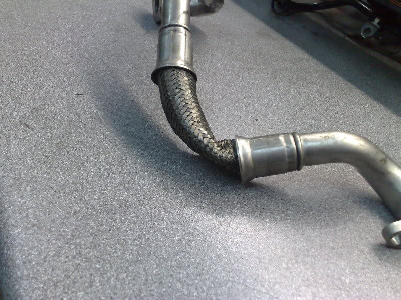

Oil return line from the turbo badly kinked..
Anyways im kind of glad to be honest, no I know its all going to be perfect! So I don’t need to worry about all those little bits!

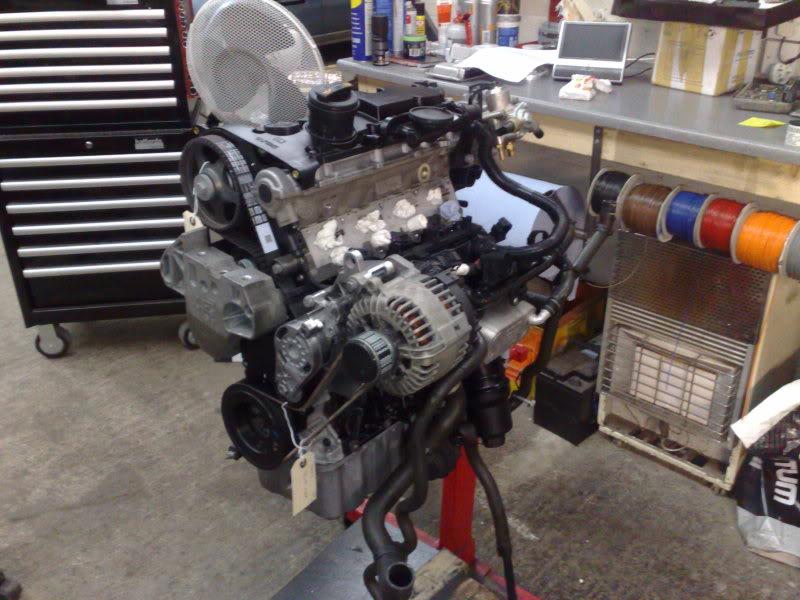

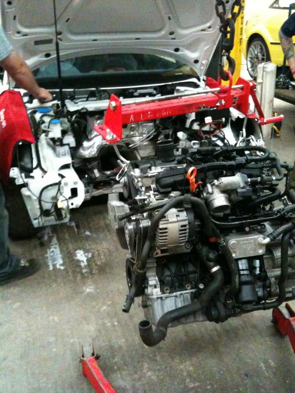

Im heading down to see the car later on today and the guys are planning on test fitting the engine complete with clutch/flywheel, gearbox, transfer box, turbo, manifold & lines etc into the bay to check for clearance on the downpipe and dump tube..
For sure there will be some work required to make it fit but its all looking good!!

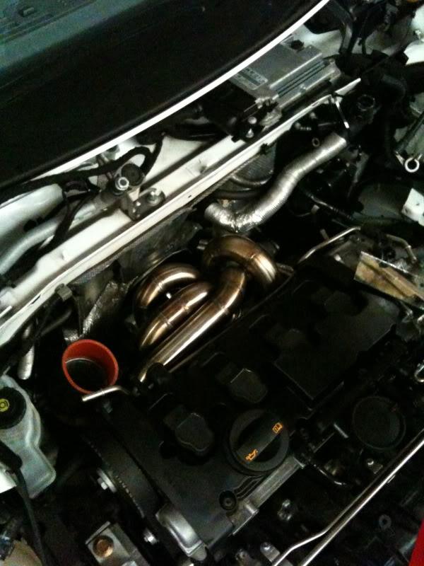

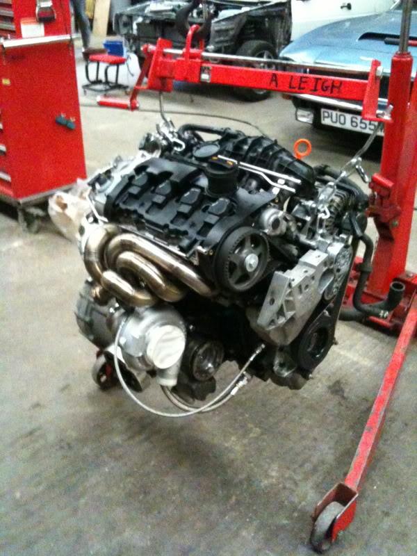

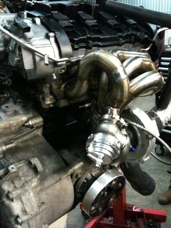

So I went to check out the car earlier. The turbo and manifold and on the engine along with the clutch/flywheel and gearbox and transfer box..

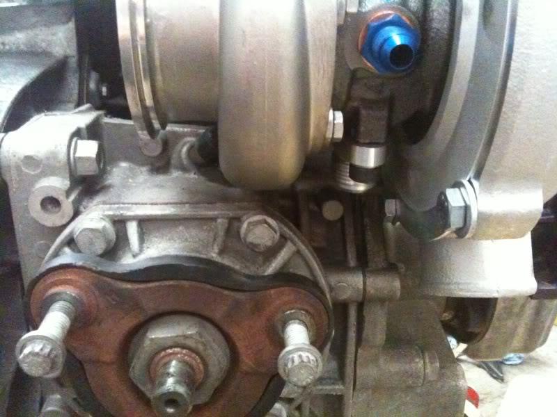

Clearance from the exhaust housing of the turbo to the transfer box is pretty small, only about 12-15mm so were having to protect the transfer box.
To get around the problem I decided to use the new product from Zircotec, a flexible ceramic matting which is way more effective than the other metallic heat barriers.. Not cheap but it works unbelievably well and is only 0.25mm thick!
The whole of the transfer box facing the turbo will be wrapped along with the intake pipe which will sit above the manifold and finally the gear linkage cables and other small parts that could be damaged with heat..
The plan for the near future is to have the manifold, dump tube, exhaust housing and downpipe all ceramic coated, this will not only help to control the heat build up around the turbo but will retain heat inside the turbo and exhaust which should really help response..
When that’s all happening the turbo will be upgraded by Owen Developments to full WRC spec to cope with the extra heat.. And to gain some performance over the standard Garrett unit, there is lots that can be done!
Anyways some more pics of the turbo and manifold on the engine..
Ready for the engine!
Almost there lol..

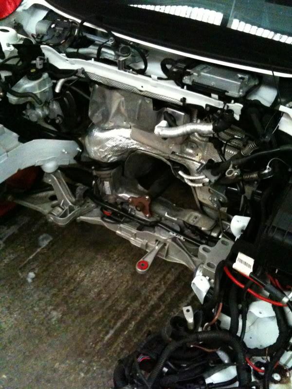

And finally in the car for its first test fitment!
Good bit of news is that the turbo intake pipe fits with the brake master cylinder, something that all of the LHD turbo kits have needed work to achieve when fitted to a RHD car. Luckily we made lots of measurements to get around this problem and BSH have supplied the pipe and it fits! ONLY just but its going to be ok..
The only problem really is the downpipe, because of the prop on the S3 there is very little room and so the downpipe will need a fair bit of work, that’s the job for tomorrow!!
