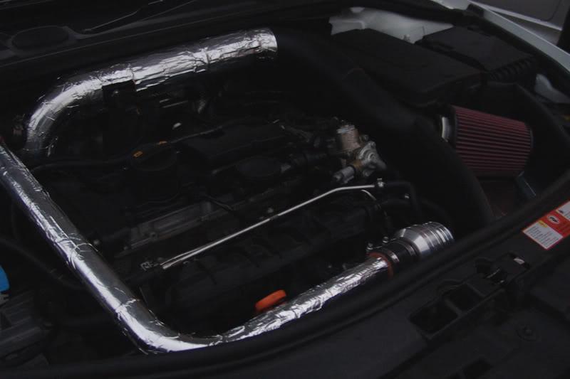

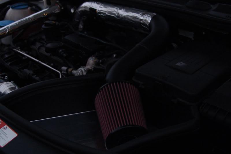

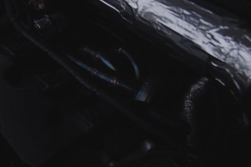

First jobs when I was back was to finish off the heat protection on the intake and DV recirc pipe, these are both very important to keep cool, and with the intake pipe running above the manifold and the recirc pipe running along side the engine both are subject to lots of heat soak!
Heres a pic of what they look like now..
I have already had numerous comments about the fact it looks like its been covered in tin foil but its really not lol.. The main areas are wrapped with the ceramic heat matting from Zircotec, which works amazingly well!! And the rest in high temperature silver tape, which I ‘acquired’ on my last trip out!
The results seem very promising, with the intake pipe being cool to the touch after a long drive with mixed conditions, stopping in traffic and WOT etc.. So im pleased with that!!

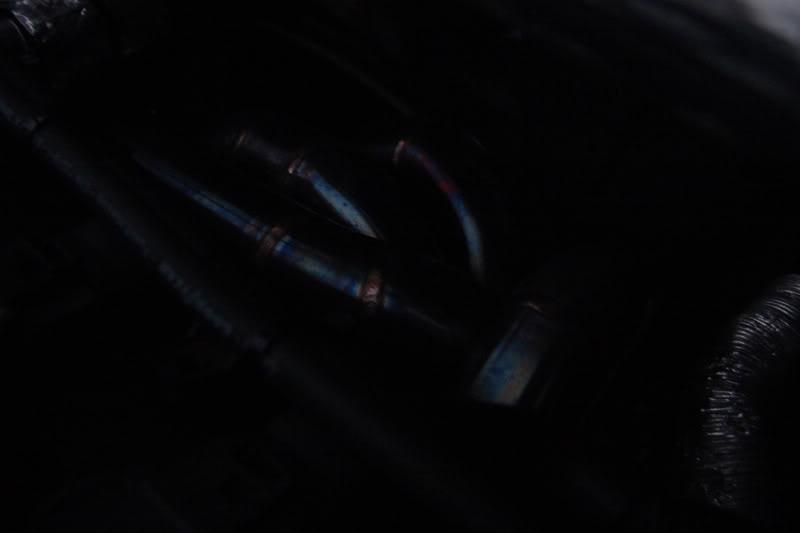

And some pictures of that lovely manifold.. Its going all sorts of interesting colours now!!
The engine bay still needs lots of work, at the moment its really nothing to look at.. Unless you know what your looking for anyways that is..

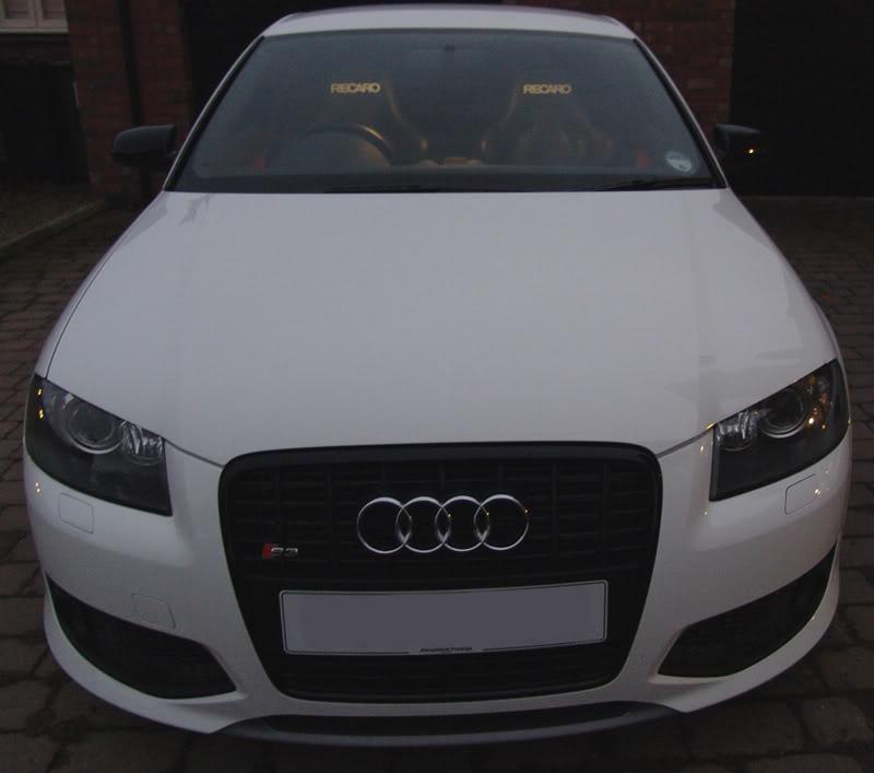

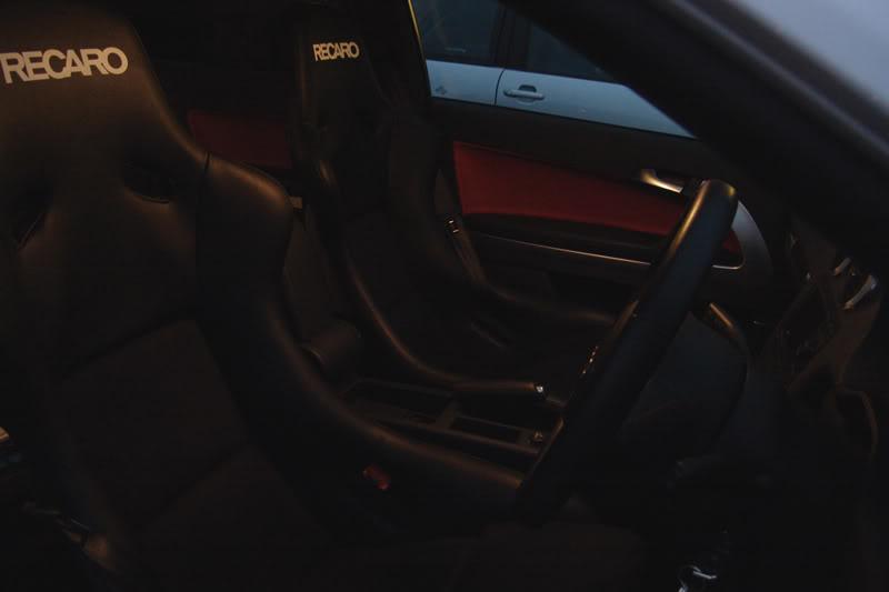

And another picture of the interior..
I think that the Recaro Pole positions look great in the car, really suit the standard interior.. After all these are the same seats that all of VAG use in the first test cars for on track activities, so there kind of OEM lol..

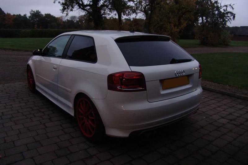

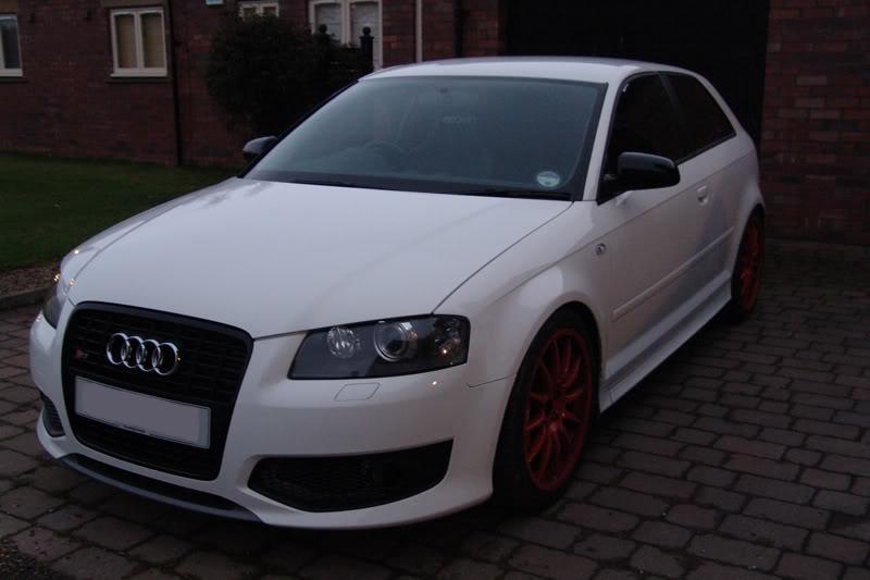

Now a couple of pics of the car..

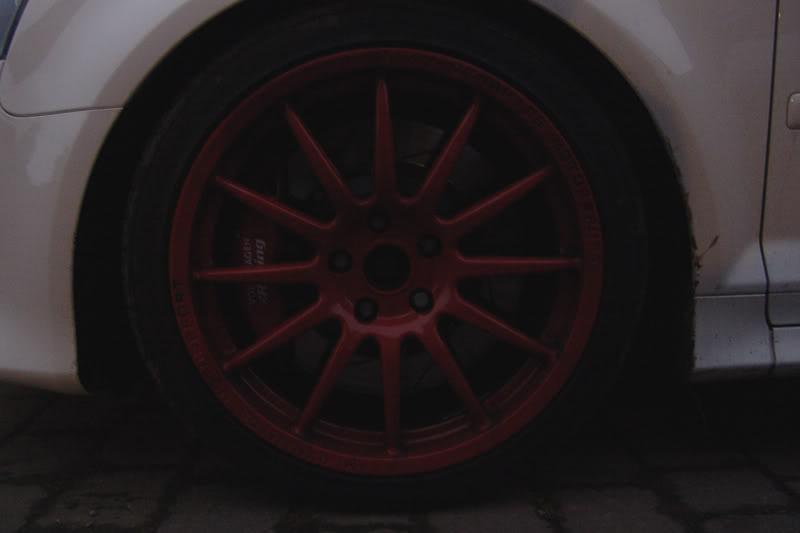

Still really not sure about the Red wheels, but sometimes I like them.. 99% sure that im going to change to textured black powder coat pretty soon but for now there are some other bits that I would rather get sorted out first..
