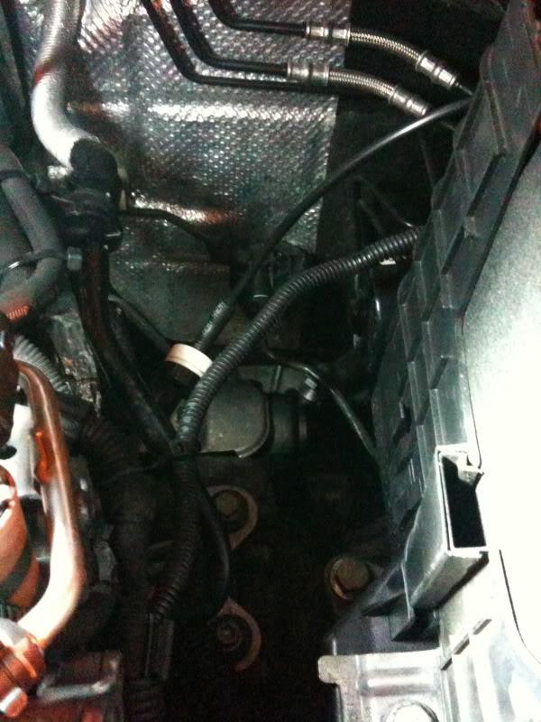

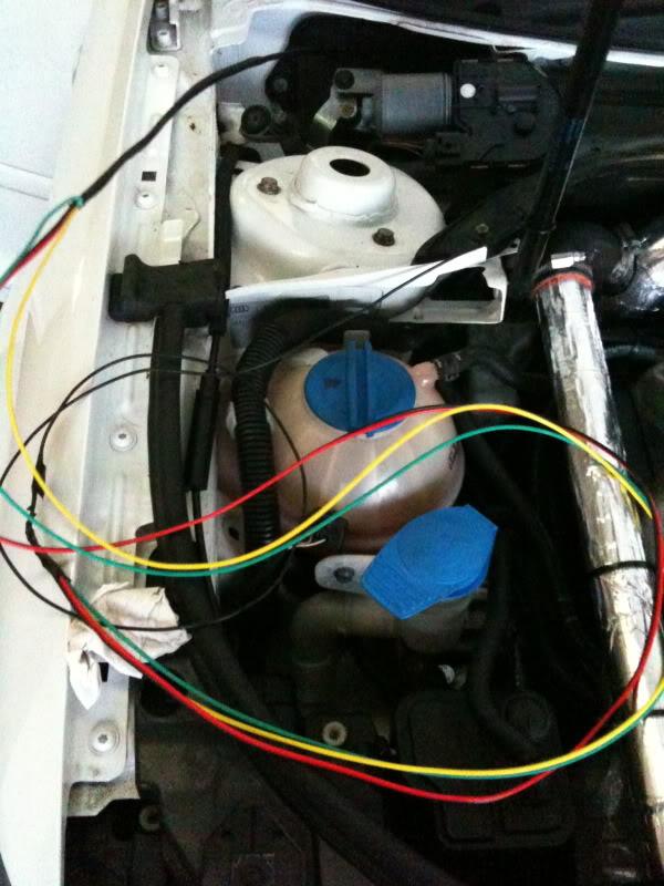

So today I decided that we should get on and fit the WOT box..
The instructions show lots of electrical tape, dodgy wire cutting and all in all a pretty nasty install..
We went about it in a little bit of a different way.. Just so that you would never know it was there unless you looked for it.. Really pleased with the install and again a big thanks to Andy for his superb work on the car!

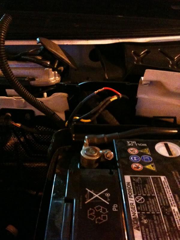

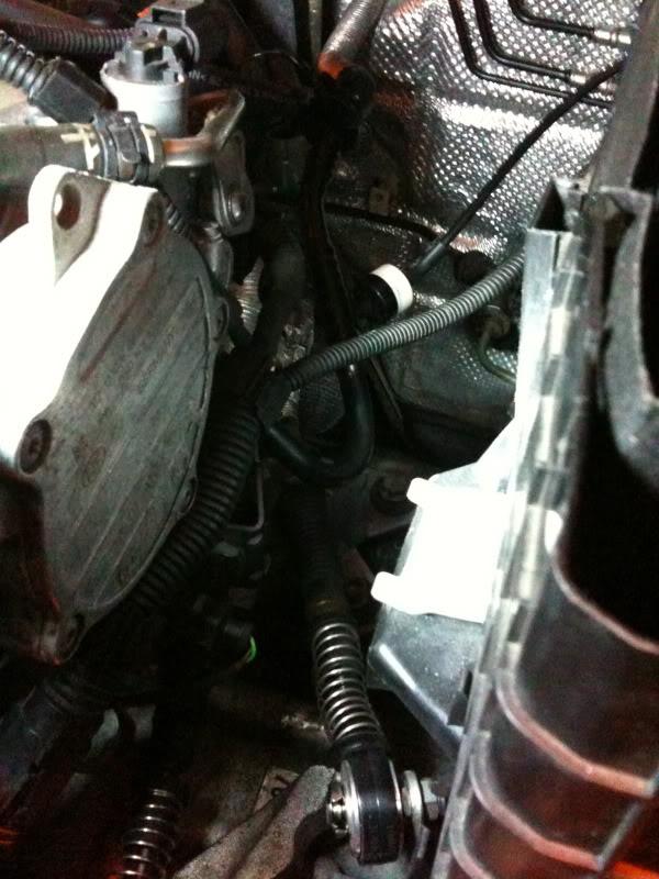

Ok so first of all we fed the wires of the loom from the driver side through into the engine bay..
The loom then travelled along the scuttle panel and dropped down out from the stock engine loom grommet on the passenger side..
All of the connections were cut / soldered and sealed with heat shrink for a perfect and reliable connection, no splicing or electrical tape in sight!
OEM loom covers were used for that OEM look in the engine bay and make sure that its all keep away from moisture or heat..

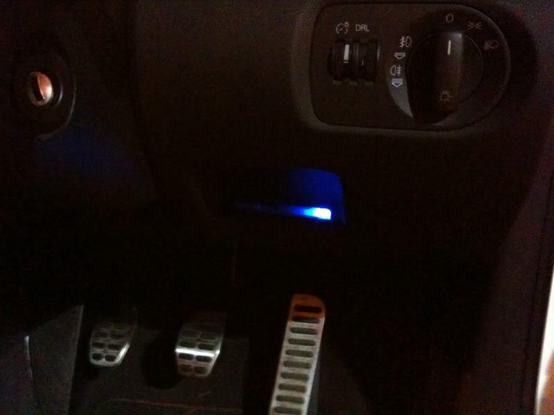

The main WOT box loom then feeds into the driver side dash cubby which the main controller sits, this allows for easy view of the LED to check that the WOT box is first of all armed and ready to go and also operating correctly..
