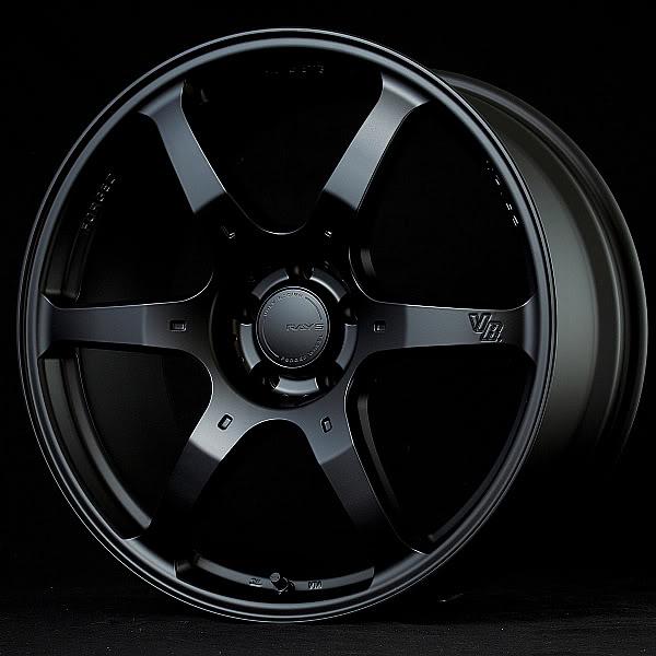

I have also ordered a set of the Volk VR.G2 wheels in flat black
Specs are 18 x 8.5 / ET42 / 5 x 112 / in the high 7kg range for that fitment..
These are set for delivery early Jan, cant wait!!

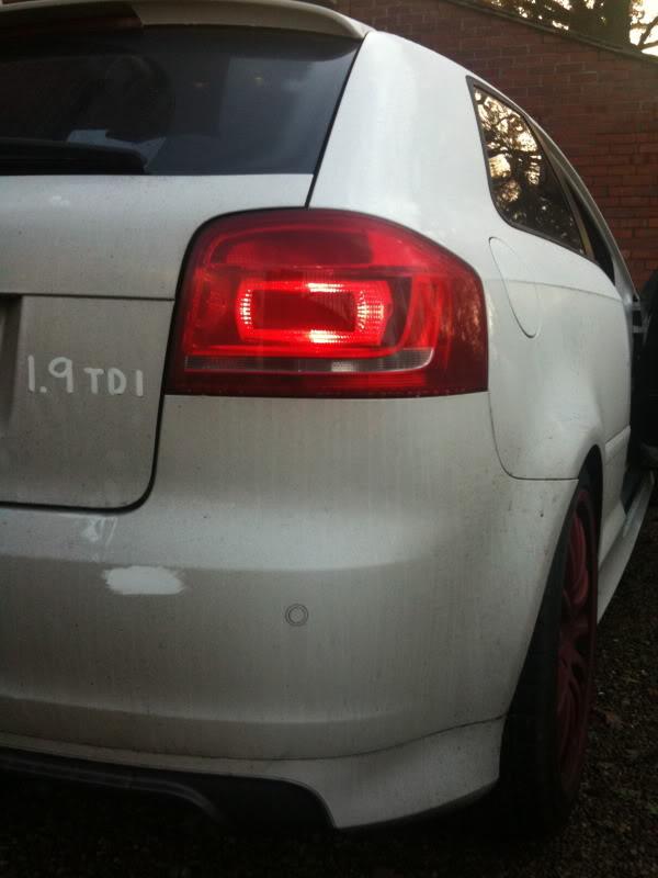

Nice touch the 1.9 TDI bit perhaps you should get some proper badges.  :wink:
Looking forward to seeing this at the Pod. Do you have a date set?
Offline jonnyc
  • Posts: 2180
  • Herrooooo!
Re: JonnyC's Audi S3 Project..
« Reply #486 on: November 09, 2009, 07:16:28 pm »
Na the car is fully de badged, I would rather it that way to be honest.. The 1.9 TDI badge was courtesy of a mate lol..
