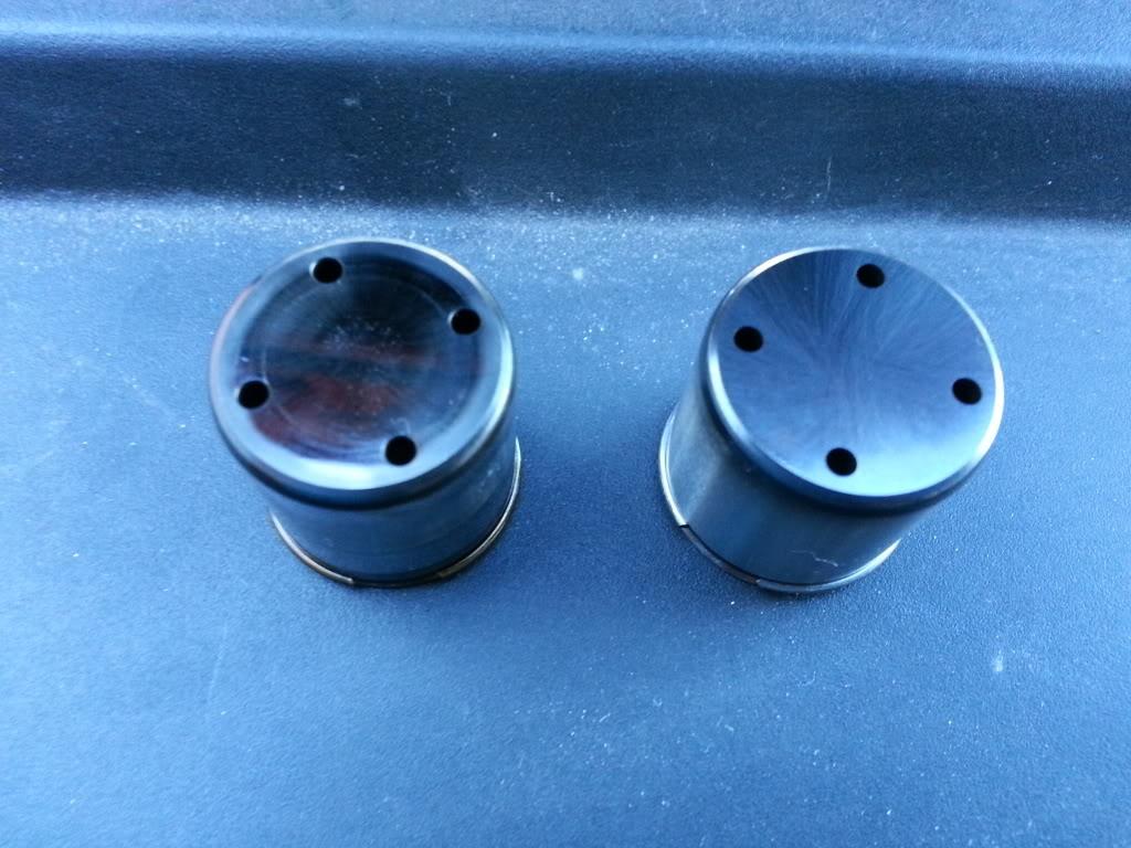

Mine on 260hp GTi AXX at 98k miles. Was stock for about 75- 80k, Stage 1 for the rest.
Lots of the black coating gone and also starting to pit on the surface. :confused: :surprised:
Cam lobe seemed ok.

Offline camfollower
  • -Receive: 31
  • Posts: 556
  • Cam follower awareness.
Re: Cam Follower Awareness hasn't gone far enough
« Reply #119 on: April 06, 2013, 05:37:09 pm »
^^^ Good call to change m8 :happy2:  It was certainly getting there.
