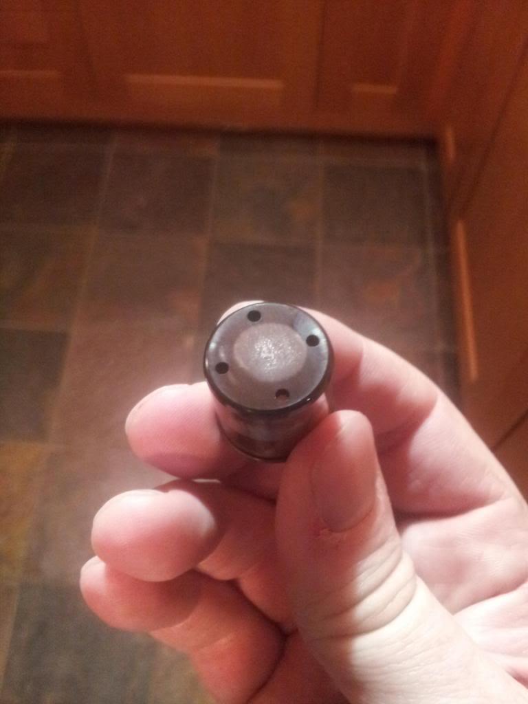

« Reply #77 on: March 31, 2013, 04:51:21 pm »
Did mine today :)  I really took my time and still managed to do it in 35 mins, that includes taking the CAI off and a bit of cleaning.
Mine was about the same as Daz's above, after 37k, 20k of which have been Stage 1.
Just feels nice to know that it wasn't see through :lol

« Reply #87 on: April 02, 2013, 02:14:32 pm »
Did mine at the weekend.  AXX 05 plate on 79K, running standard pump.  Was a bit tricky with the twin hard line setup but ok with the right tools, took around 45mins with a cup of tea halfway.
Old and New  :happy2:

  • -Receive: 75
  • Posts: 1068
Re: Cam Follower Awareness hasn't gone far enough
« Reply #88 on: April 02, 2013, 02:35:32 pm »
I also have a axx on a 55 plate with similar miles - how does that wear relate in seriousness levels? Have a new follower on the way, just interested.

« Reply #89 on: April 02, 2013, 03:02:19 pm »
Compared with some of the pictures I've seen on a wear level of 1-10 i'd give mine a 3/10.  Personally I was happy that I'd changed it for peace of mind and comfortable with the state of it when removed.  The camshaft itself had no additional markings on it  :happy2:
We've all seen a lot worse.  :happy2:
