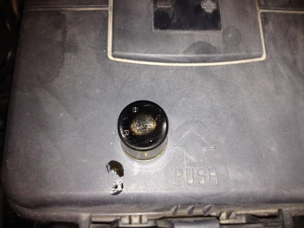

Inspected ours today, not too bad after 60k. Does this need changing guys?
Black 5 door Mk5 GTI
Offline olufsen
  • Posts: 105
Re: Cam Follower Awareness hasn't gone far enough
« Reply #67 on: March 30, 2013, 06:36:54 pm »
afaik the black stuff is the hardened coating, that has gone on yours, so I would be replacing that personally.
Cheers worth doing for peace of mind I guess. Nice and easy as mine didn't have the banjo bolt.  :jumpmove:
