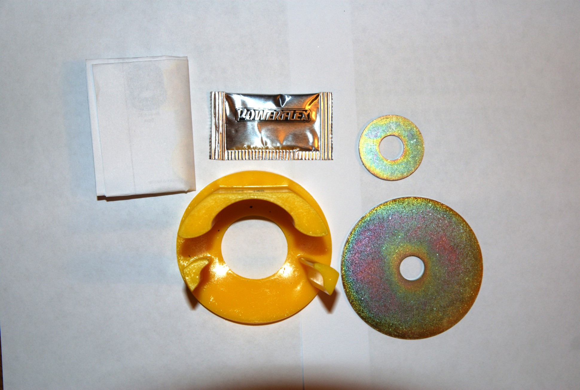

Last mod which Im makd(Until now) is installing "Lower Engine Mount Insert" :)
Packed:
Lets look what is inside:
Car is lifted:
Motor protection and screw is removed, mounting location is clean:
Im use the supplied lubricant and easy push it into the hole, tighten the screws well ...

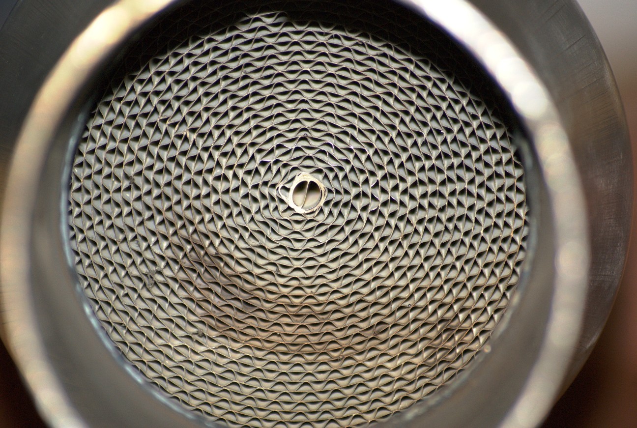

B&B Downpipe with 200 Cell Metal Cat:
200-cell metal high flow catalyst:
