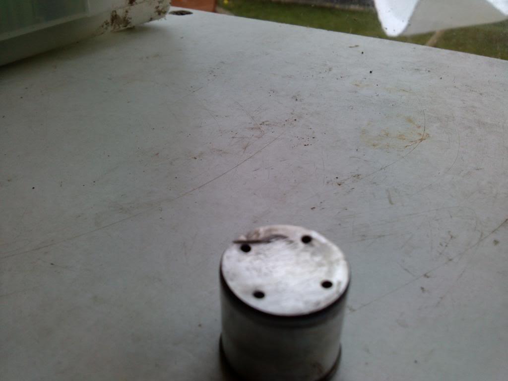

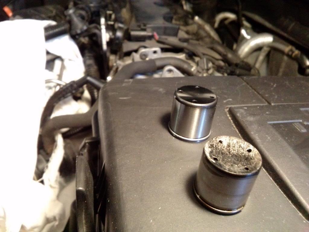

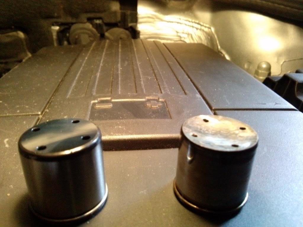

Been following a couple of threads this Week about cam followers which spurred me on to change mine. Caught it in the nick of time, another few thousand miles it would have been wrecked. 55 plate gti with 94k miles

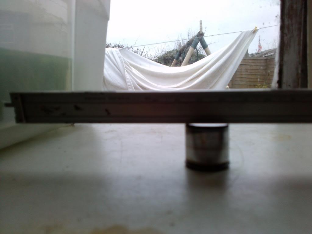

One photo shows a straight edge on top of the follower, its hollowed about 1mm and the case hardening is non existant.

Just hope the cam is ok, the lobe wasn't visible  but there was marks on it but no scoring from what i could see

off topic - how come you are drying your sheets outside? its fecking freezing!!  :laugh:

Been dry up here for weeks !
