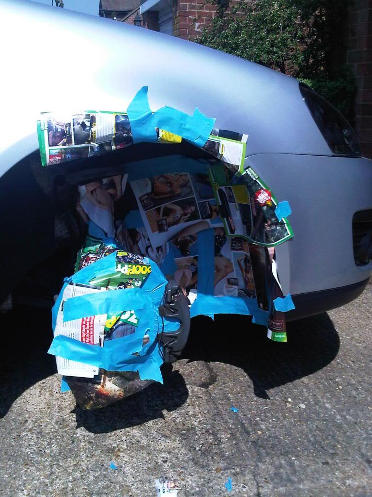

I find for a general clean G101 works quite well to get the dirt and grease off.
I resprayed mine last weekend:
Used G101 to remove dirt ect
Sanded down to create something for the paint to stick to
Cleaned with cloths to remove dust
Sprayed with colour and then top coated.

I think i used some degreaser with a wire brush when i first did it on my GT, looked something like this before i started to spray.
It will be alot eaiser than spraying as you can control where the brush goes, spray gets everywhere  :laugh:
