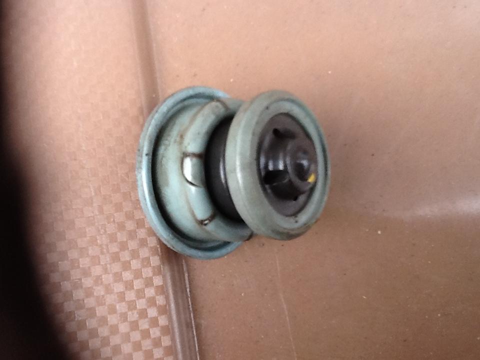

I also changed the DV
The old one was like so many on the threads I have read, knackered.  It took me about 45 mins to change the DV and when I got it off, I was SO happy the diaphragm was knackered as this meant that my suspicions that the car wasn't running right were now confirmed.

I bought this or similar eBay item (number 130495629561 ) in preparation for changing out the cam follower on the fuel pump, the one I bought has the spline tools in it for the banjo bolt.  It also has a 5mm Allen peice which fits in great into my 10 mm halfraids ratchet ring spanner.  I actually undid the bolts with a 5 mm Allen key, then used the ratchet spanner combo to remove.  I even got that good at it I undid another 5 mm bolt holding a pipe clamp on which I didn't need to.  :rolleye:
I did the work under the car which I found fine. Note, watch out for dripping oil when you undo the bolts!! My cable connector had quite a bit in it! :surprised:  I'm guessing this had come through the punctured DV diaphragm...... Hope it's not a sign of failed turbo bearing seals....... :jumping:

Yeah, id take it to the garage, they'll sort it no probs!  Yeah, I think the PCV is knackered, so I bought the BSH revamp kit of fleabag for £55.  I will fit that next week.
Here's a pick of the duff DV:
