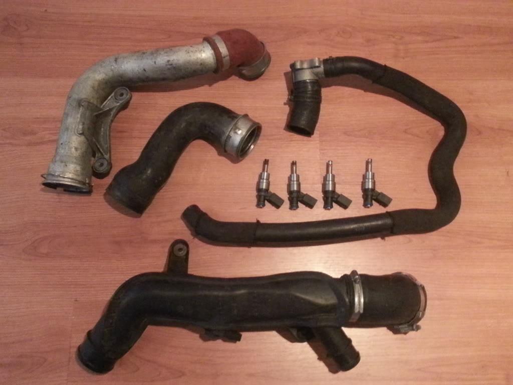

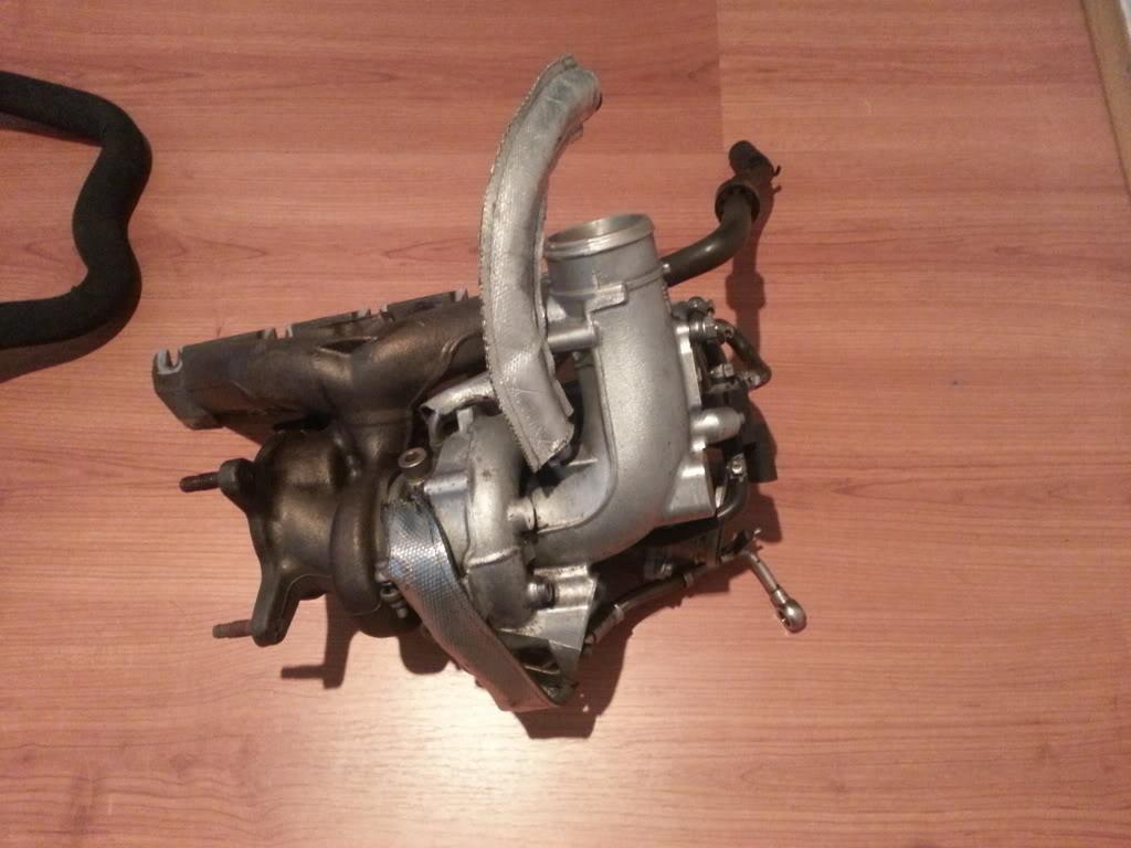

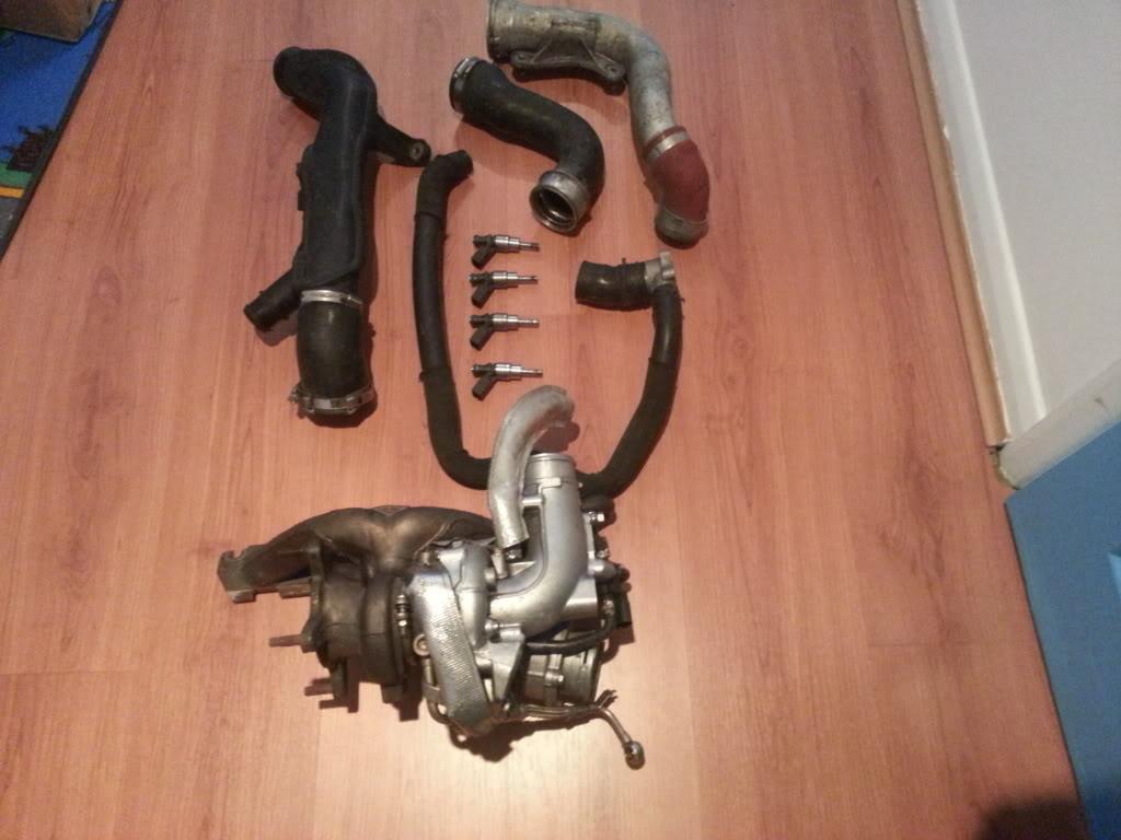

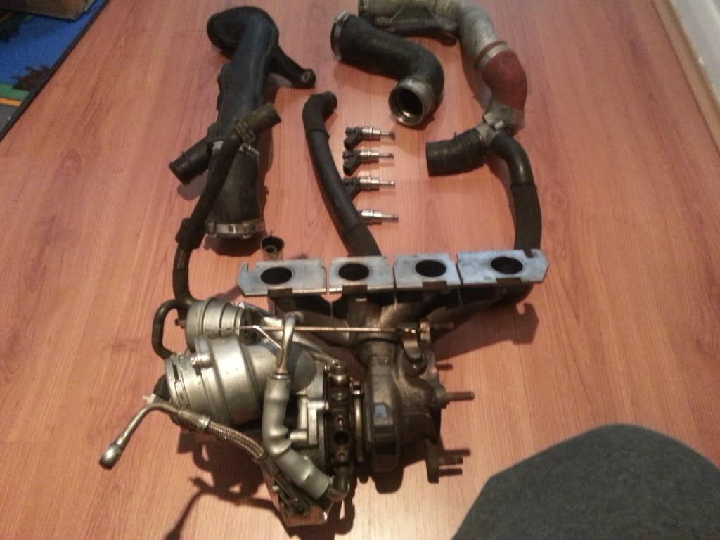

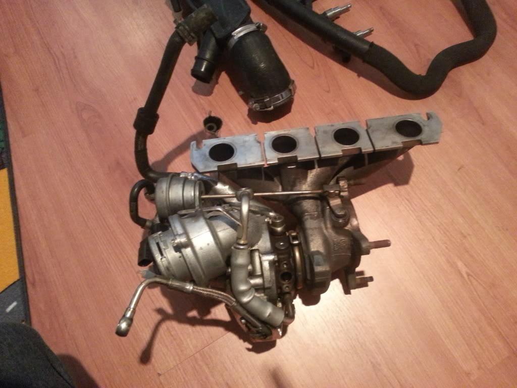

Hi everyone
Iv just bought this ko4 kit off here
I want to get it fitted asap but just wondering if anyone here can tell me if iv got everything to fit it to my car or is there anything missing from this that I should get
Any advice will be appreciated
Thanks in advance
Billy

You'll need 4x seal kits for the injectors, turbo to cylinder head gasket, oil and water line crush washers. Are you running the S3 cooler and a CAI with K04 branch off?
