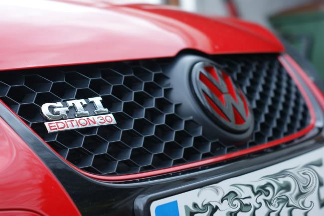

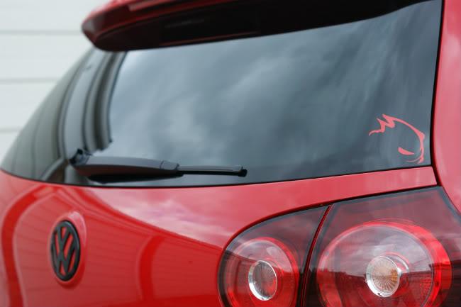

My old Mk5 3D handle, with rear part covered in red vinyl and the VW Emblem in Gloss Black vinyl. The VW emblem just comes away from the backing if your carful.
My old front one., also wrapped in Gloss vinyl...
