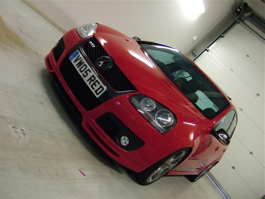

« Reply #27 on: January 23, 2009, 06:12:53 pm »
LOL - are you living there at the minute RR?
.... :laugh: Their garage is somewhat larger than mine!
I was speaking to Mark today as it happens regarding some brakes (long story, I'll start a thread) and I cannot give him enough praise. He's gone out of his way to help me over the past few days. I'm hoping to get a spin in their car at some point, so I can see what I'm missing and have even greater LSD envy!!!
Everyone's cars are in safe hands for sure!
....Yep, Mark and his team are genuine car enthusiasts and know a heck of a lot about the Mk5 platform. Very straight speaking, very honest, very skilled and very experienced - You just need to accept that they're not a shop/retailer and their priority is always racing and so fit in with their (sometimes changing) schedules and they'll make no difference in the service they give you whether you're spending £200 or £20,000.
:rolleye: :rolleye: :rolleye: :rolleye:

« Reply #28 on: January 23, 2009, 11:25:12 pm »
I hope thats not part of the Quaife LSD install procedure  :grin: :grin: :grin: :grin: :grin: :grin:
