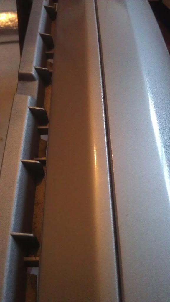

Seen as the sun was out today I thought i would do a bit of painting on the car. I did the front lip, grill surround and engine bay. Still got a bit to do, but but I'll finish it tomorrow.

Love the lower skirt ....would like to do mine like that ...did you paint it yourself ?

Looks good mate! Just a rattle can?

Yeah painted it myself with a few cans. If you are planning to paint it, I would get a thick filler primer and give it plenty of coats until its smooth. I left the texture in and although it looks alright, it's not that great close up.

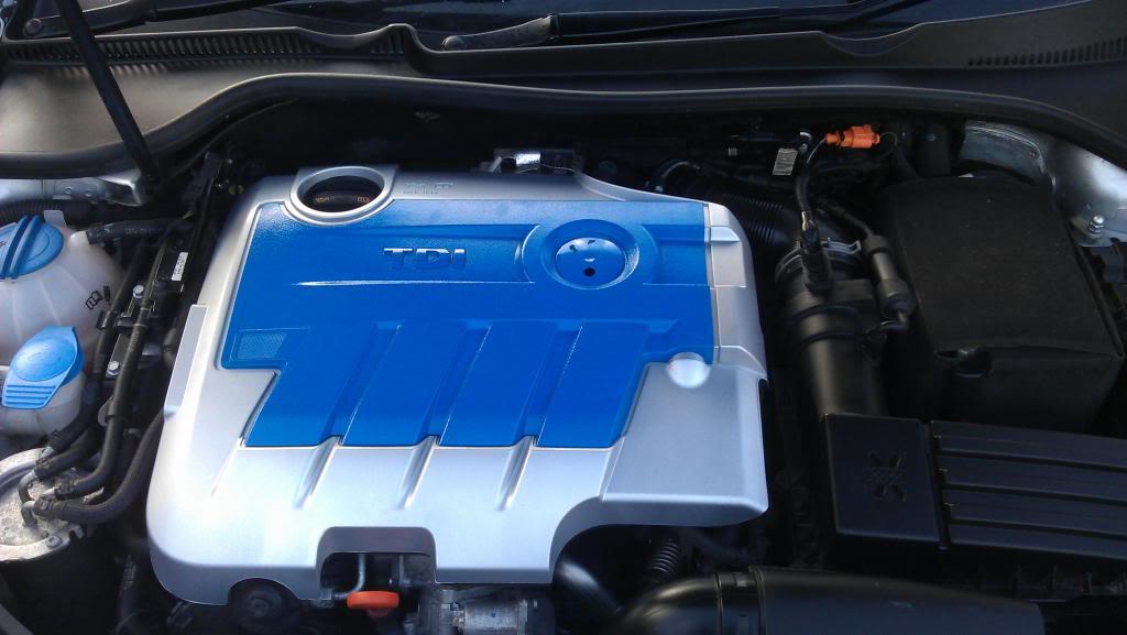

Very nice job on the parts!
Blue actually works on the silver car  :happy2:

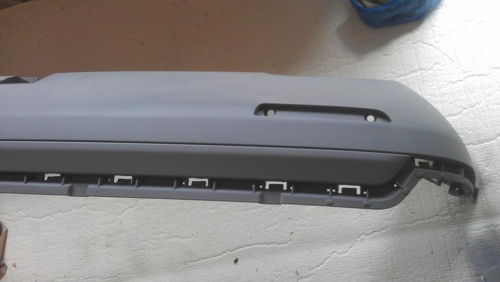

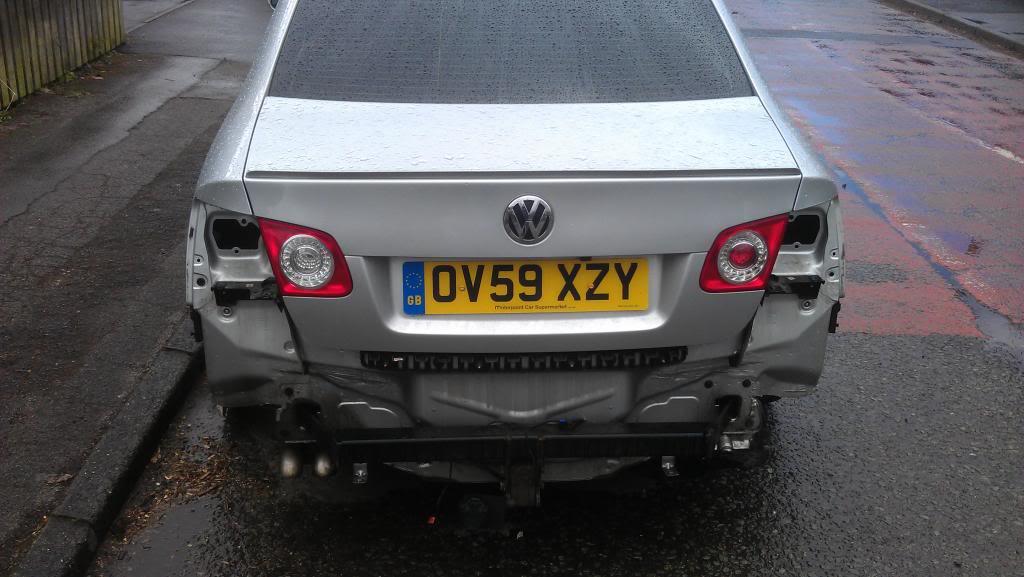

I got the spray cans out today again.
Removed the rear bumper.

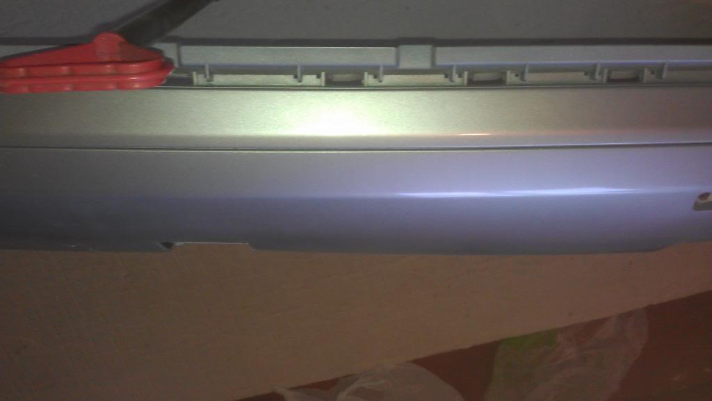

I used high build primer and gave it 3 thick coats. Then i sanded it down starting with 400 grain sand paper going up until al the texture was taken out. This is the result.
Then i gave it 3 coats of paint and 3 coats of lacquer. A little tip is to heat up the lacquer before you spray it to make it go on smoothly.
All i need to do is buff it up tomorrow and re fit it and hopefully it will look great.

Doesn't look like a bad finish at all there mate! It's all in the prep lol you seem to have done a nice job!  :drinking: :drinking:
The Jetta looks weird without a rear bumper sort of like a transformer  :signLOL:

Great job there ...you can come and do my jetta and golf :D:D
