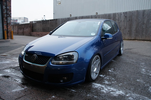

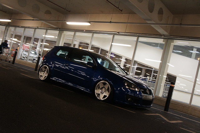

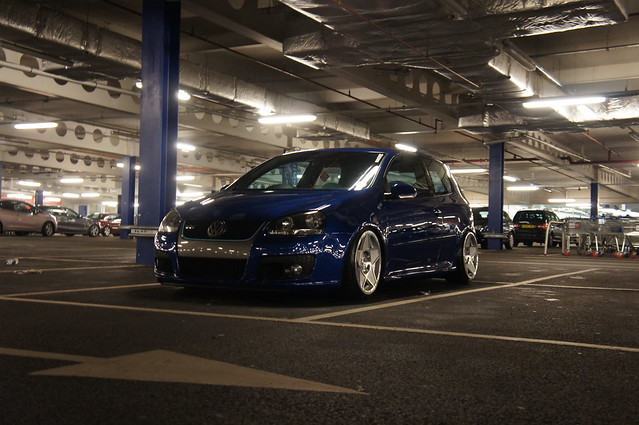

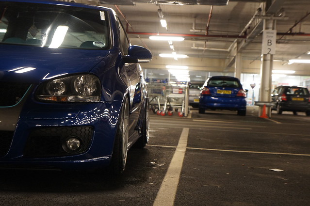

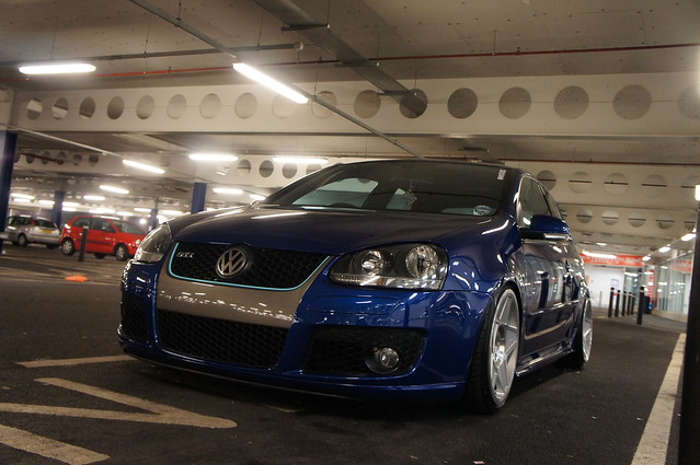

A few befores - this car isn't running air but is 'static' running KW Ultra Lows:
DSC07297 by RussZS, on Flickr
DSC07298 by RussZS, on Flickr
DSC07300 by RussZS, on Flickr

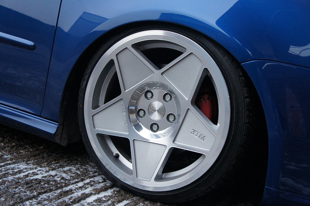

As the wheels were already very clean, and also relatively delicate, I decided to foam the car initially and use this along with a mixed up spray bottle of Valet Pro's Advanced Neutral to safely clean the wheels and begin to break down the traffic film present on the paintwork.
Wheels rinsed at high pressure first to remove any loose dust and dirt:

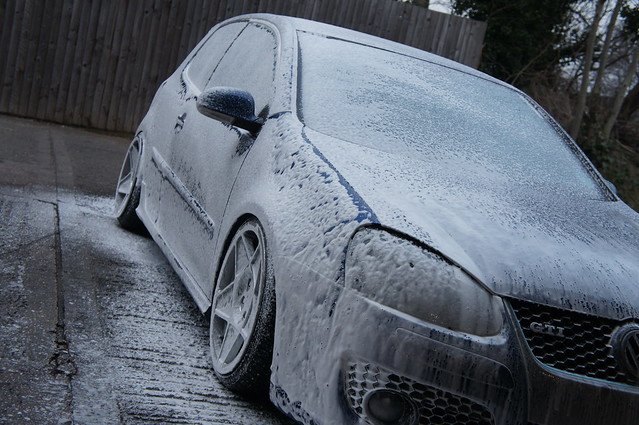

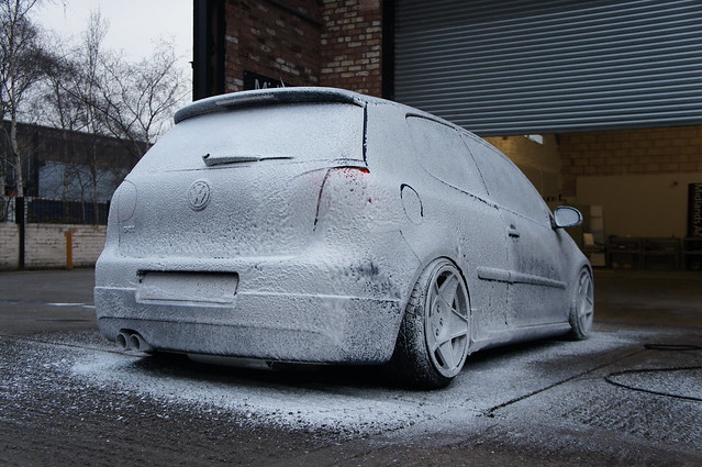

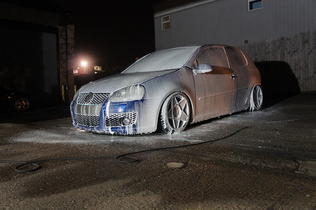

The Golf was then foamed:
DSC07305 by RussZS, on Flickr
DSC07307 by RussZS, on Flickr

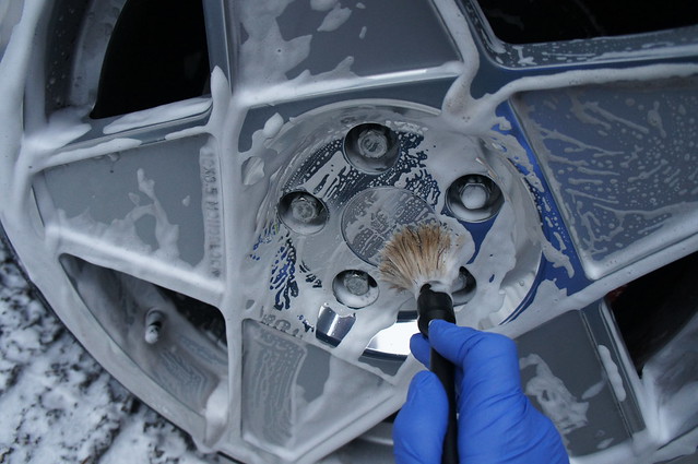

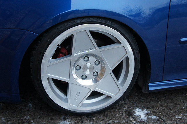

Wheel Woolies were used to gently agitate the ValetPro ANSF on the rear of the wheels:
DSC07308 by RussZS, on Flickr
The smallest of the Valet Pro brushes was used to clean the faces of the wheels:
DSC07310 by RussZS, on Flickr

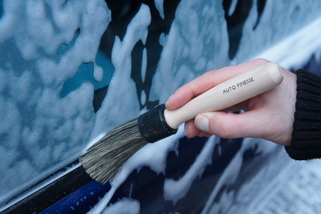

Meanwhile, we worked around the more intricate parts of the car with Auto Finesse's new brushes:
DSC07311 by RussZS, on Flickr
DSC07314 by RussZS, on Flickr
DSC07316 by RussZS, on Flickr

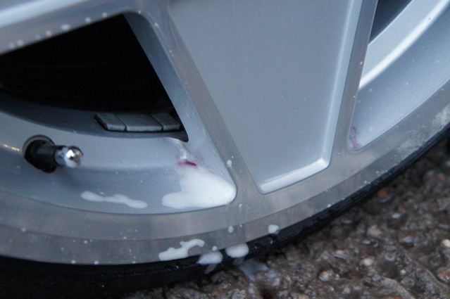

After the wheels were rinsed, Iron Out was used to safely remove any build up on brake dust pitting present:
DSC07317 by RussZS, on Flickr
DSC07318 by RussZS, on Flickr

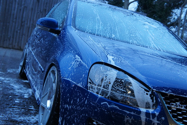

Next the whole car was rinsed at high pressure to remove the foam solution and hand washed safely with Auto Finesse Lather shampoo and a CarPro mitt:
DSC07320 by RussZS, on Flickr

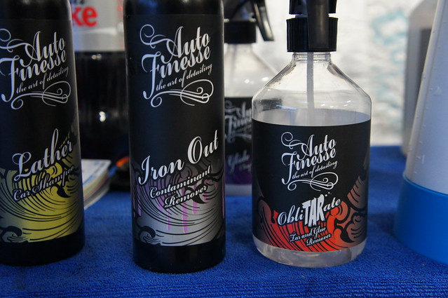

After washing and rinsing again, we began to decontaminate the paint using a 3 stage process - fallout removal, tar removal then claying to pick up anything left such as tree sap.
We used Iron Out and Oblitarate to deal with the fallout and tar respectively:
DSC07322 by RussZS, on Flickr

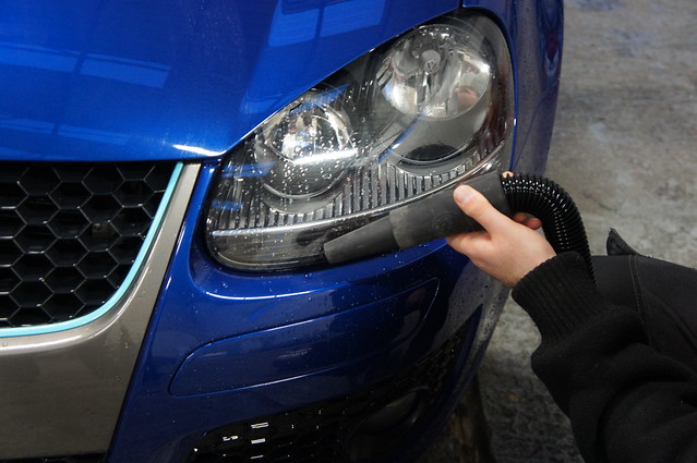

and a blower to remove any trapped water:
DSC07327 by RussZS, on Flickr

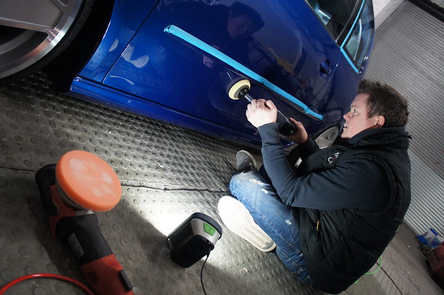

At this stage we were ready to begin assessing the paintwork.  We already knew that all of the car with the exception of the roof had been repainted - this was reading around 350-400 microns consistently, and the roof being original paint was nearer the 130-140 mark.
After testing various combinations we settled on a mixture of Rupes BigFoot with cutting pad and Zephir and Flex VRG3401 with Lake Country HT Rotary Cyan Cutting Pad and Megs 101.  We did also use the Rotex90 in places and the Festool RAP150 Rotary with extension bars.

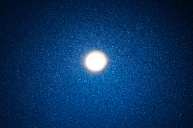

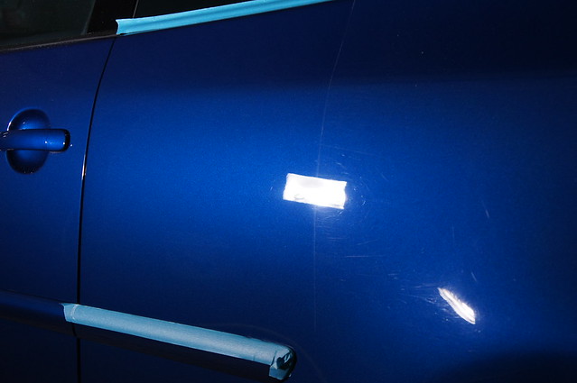

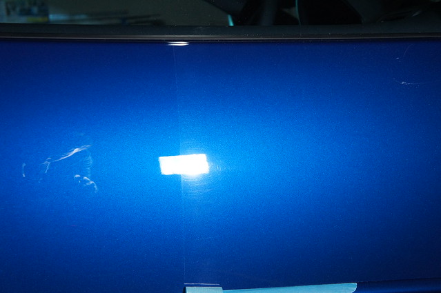

Some pics from the corrective stages - all are before refining:
DSC07329 by RussZS, on Flickr
DSC07333 by RussZS, on Flickr
DSC07347 by RussZS, on Flickr

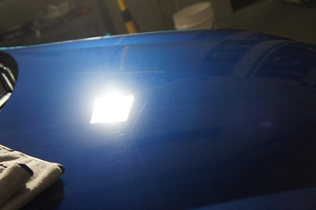

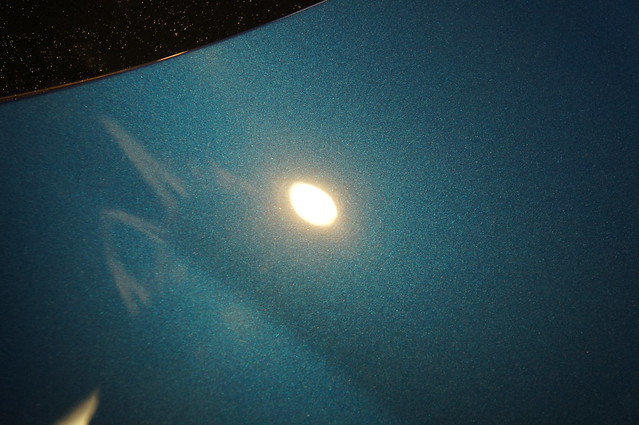

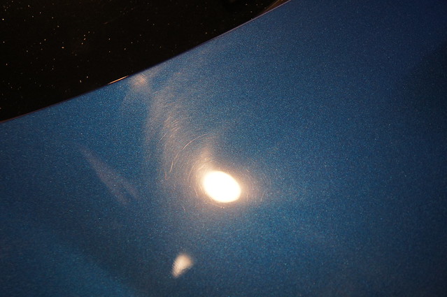

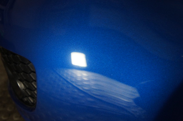

One of the many deeper scratches on the bonnet and roof:
DSC07359 by RussZS, on Flickr
DSC07363 by RussZS, on Flickr

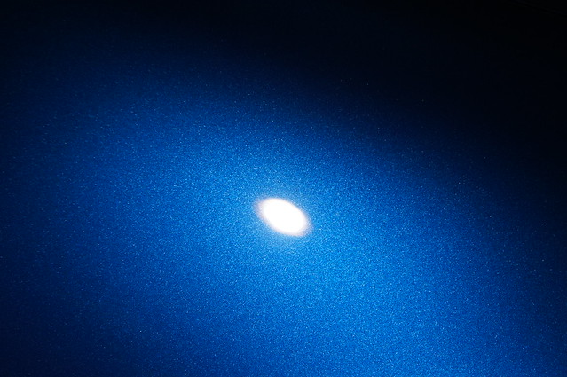

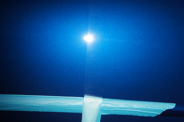

There were some pretty heavy sanding marks present in the top edge of the bonnet too:
DSC07369 by RussZS, on Flickr
DSC07372 by RussZS, on Flickr
DSC07386 by RussZS, on Flickr

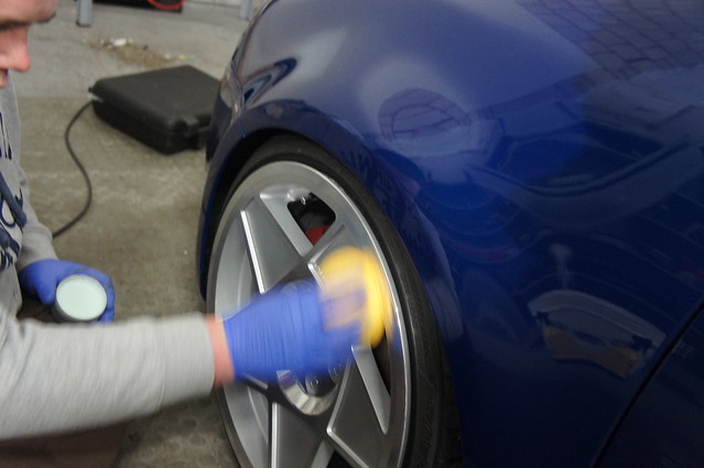

More intricate parts were dealt with via Festool Rotex90:
DSC07389 by RussZS, on Flickr

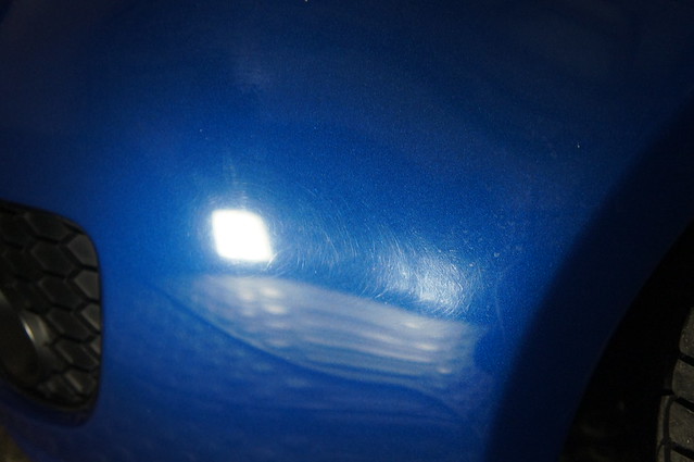

Front bumper before:
DSC07396 by RussZS, on Flickr
After:
DSC07399 by RussZS, on Flickr

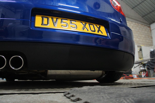

We used Mercury on the exhaust and Mint Rims on the wheels:
DSC07408 by RussZS, on Flickr
DSC07411 by RussZS, on Flickr

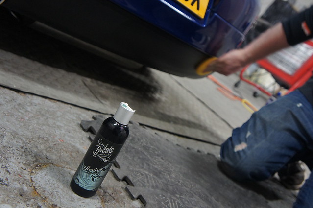

Revive was used on plastic trim and door seals:
DSC07434 by RussZS, on Flickr
50.50
DSC07437 by RussZS, on Flickr
DSC07438 by RussZS, on Flickr

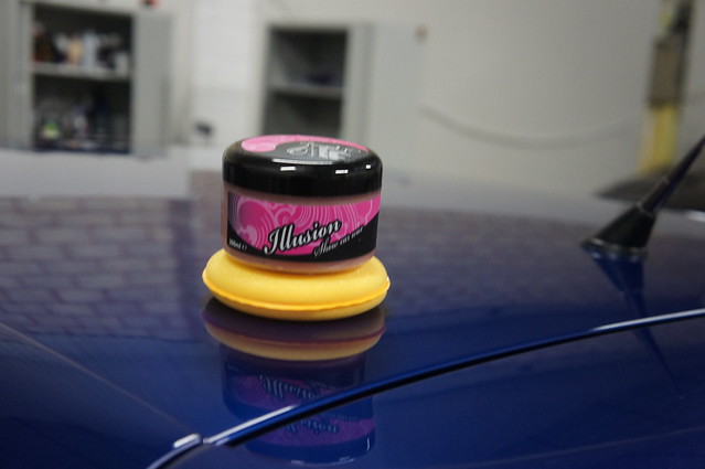

We finished with Auto Finesse's show car wax - Illusion!
DSC07432 by RussZS, on Flickr

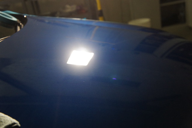

Then a final spot check with the 3M Sun Gun:
DSC07440 by RussZS, on Flickr
DSC07444 by RussZS, on Flickr

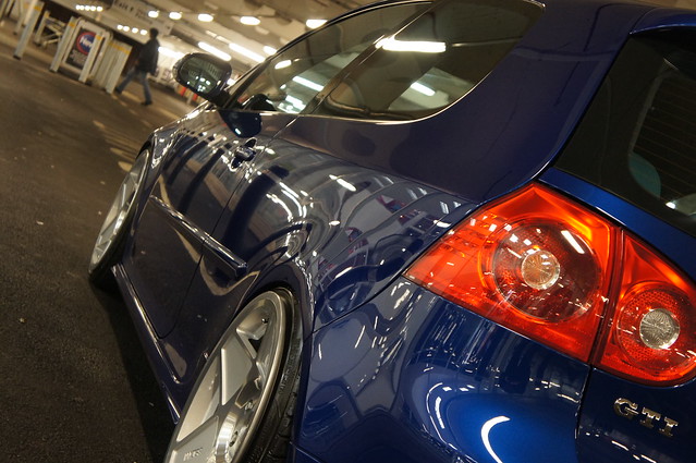

and finally, some afters:
DSC07453 by RussZS, on Flickr
DSC07454 by RussZS, on Flickr
DSC07456 by RussZS, on Flickr
DSC07463 by RussZS, on Flickr
DSC07468 by RussZS, on Flickr
DSC07475 by RussZS, on Flickr
DSC07479 by RussZS, on Flickr
DSC07480 by RussZS, on Flickr
DSC07482 by RussZS, on Flickr
DSC07495 by RussZS, on Flickr
DSC07496 by RussZS, on Flickr
DSC07498 by RussZS, on Flickr
DSC07499 by RussZS, on Flickr
DSC07501 by RussZS, on Flickr
